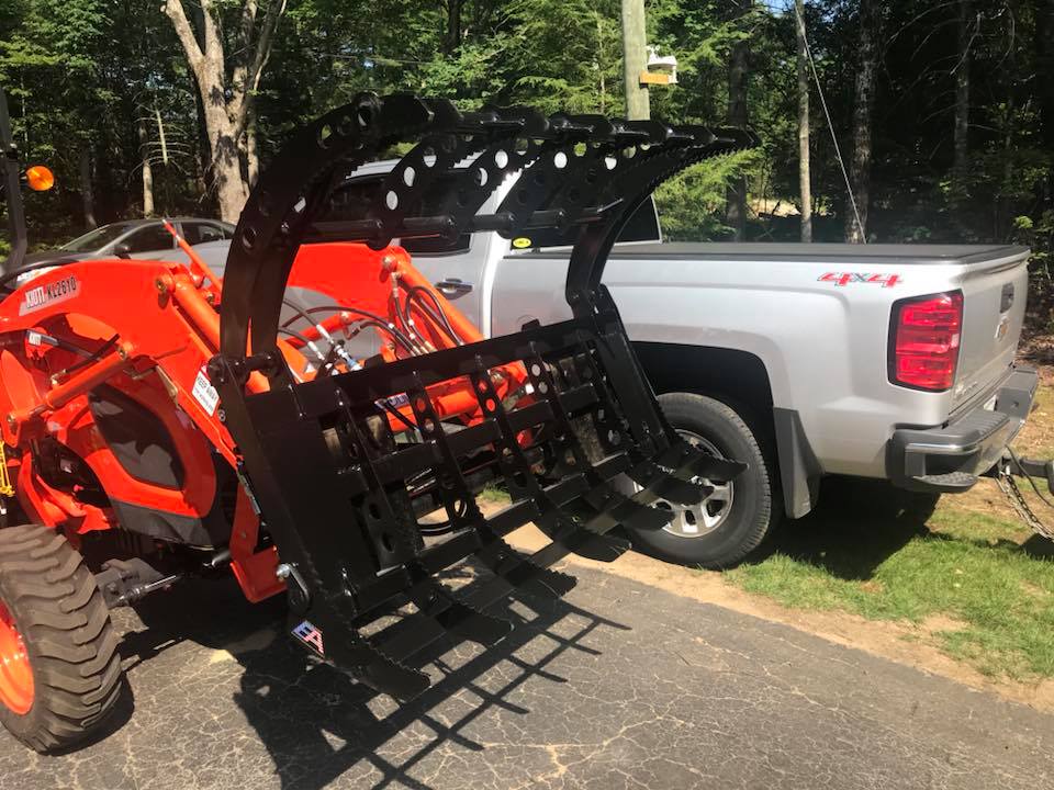

So Ted, what grapple would you recommend for my use and tractor?
   / Grapple decisions.... #23
This is Travis.
We definitely have choices....great choices. I would definitely not consider going much over 400 pounds.
I'll break a few down for ya.

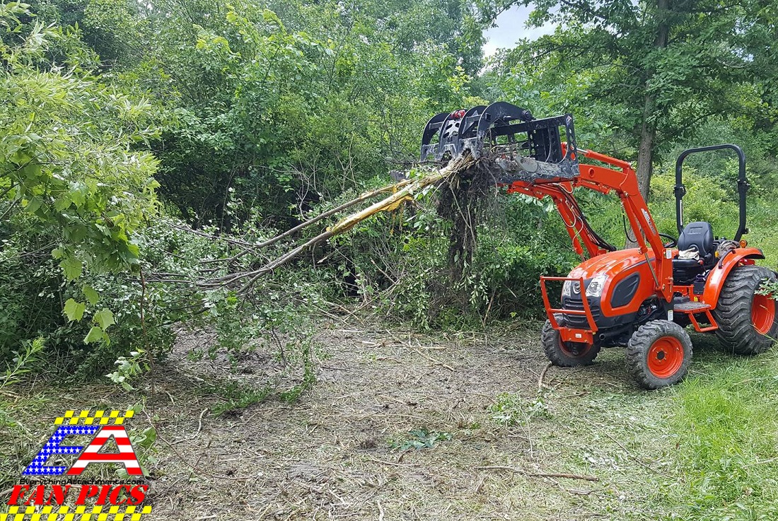

Root Rake Style Grapples
The dozer-like tine geometry of the rake style promotes a tractor's ability to push the tines through the ground with ease.
The root rake style allows you to pull brush, vines and other debris backwards, which isn't recommended with many long bottom grapples. Besides pulling backwards, you can also pull down. Reach up and snap a limb off the tree if you feel like it.
The root rake style will easier "unload", so you can hover over the trailer, dumpster, pile, etc., open it up and whatever you've captured is gone!

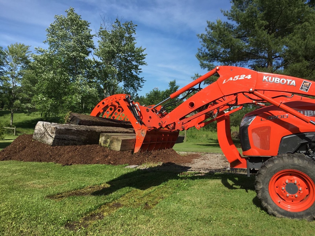

We have two rake style candidates for your machine...
Capacity maximizer = Wicked 55 Root Rake Grapple
Just over 200 pounds.
With an 1835 pound lift capacity to full height at the pins...the CK3510 isn't what I call starving for lift capacity.
Our 60" Wicked Grapple rake is a BRUTE. It weighs just over 400 pounds, so you'll give up some capacity and gain strength.

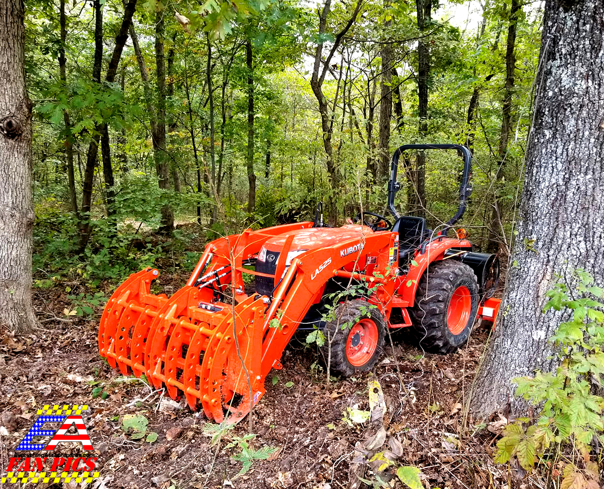

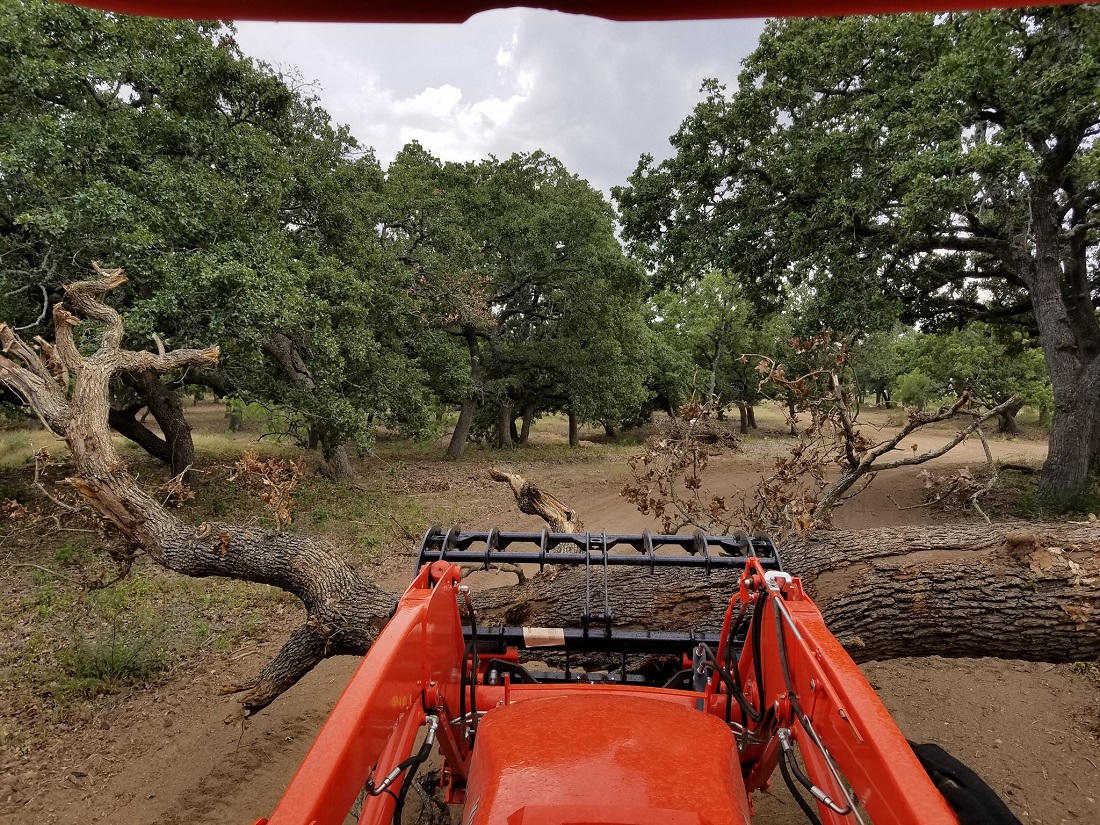

Original Wicked Long Bottom Wicked Grapples
These are the ones that started the Lightweight Grapple Revolution. Legendary Wicked here. Race Car Inspired.
Because of the unique tine design, you will be able to push our unobstructed long-bottom Wicked Grapple tines through the ground.
You should be able to grab a larger pile of brush or hold multiple logs with the traditional Wicked style because you can cradle and physically fit more inside it's "mouth". You can cradle things(logs, boulders, etc) with the flat bottom and stack items on it for transport. Heck, someone used it as a saw table recently. Our superior Wicked tine design is a step above any other long bottom grapple on the market!
For maneuverability I like 60" or 54", but width is debatable.
There's little weight difference between all of them, so it really boils down to what you like.

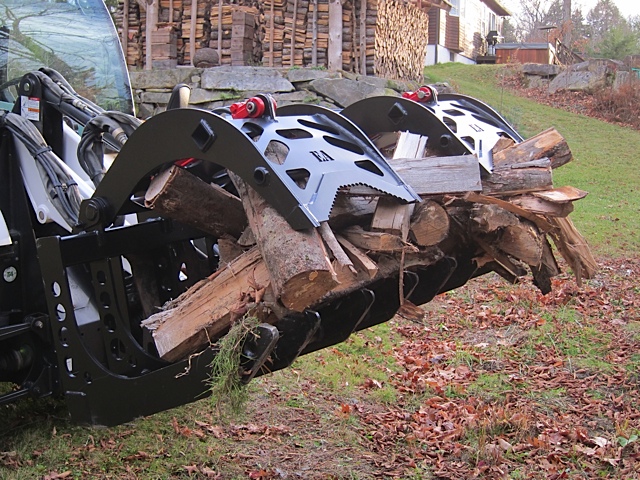

Single vs dual lid has about as much to do with personal preference as functionality. The single lid pics submitted by customers are impressive to say the least, but there are some situations where dual gets my vote. Dual lids clamp extremely awkward loads more efficiently and will grab loose material like firewood better.
Single lid model
Dual lid model

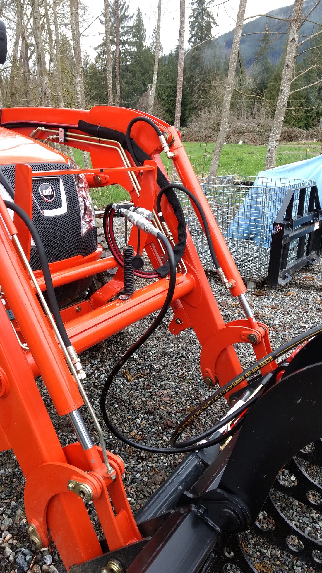

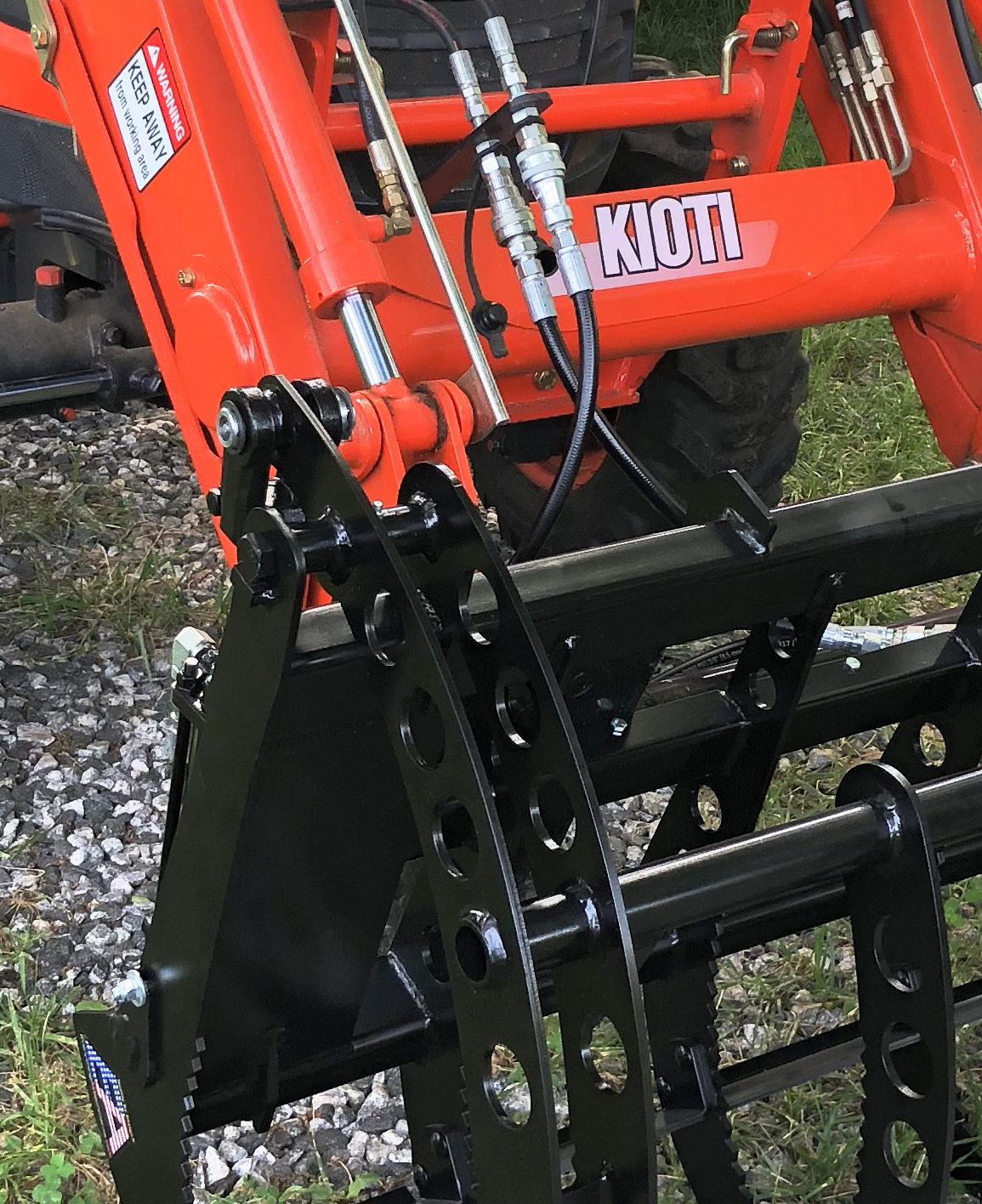

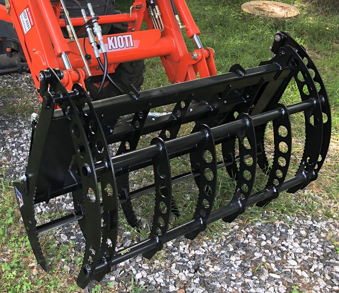

Kioti dealers have been using this Custom True 3rd Function Hydraulic Kit for years. It's $837 and an easy install. Take $50 off when you purchase with a Wicked Grapple.
A bracket to hold the hoses to the loader torque tube is now included(shown below).

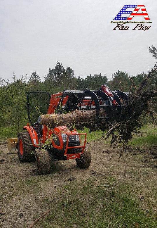

It痴 been awhile since I致e posted anything. On this I will chime. I致e used several 4 n 1 buckets on friends tractors. Four years ago I purchased a b3200 and have since bought 7 attachments and made 2 additional myself. One was a 55 inch root grapple from everything attachments. The reasons: light weight,, they use ar400 steel which is consistent thru and thru meaning other brands (big name) tend to bend. This grapple is awesome I致e used it the way they (EA) has tried to destroy it. They ARE very friendly and answered all my detailed questions,,,, by far THE BEST grapple on the market and lightest, strongest, durable. I can稚 speak highly enough about this attachment, or company. It is very versatile,,,, only older woods/gill do I also give this credit to!!!!

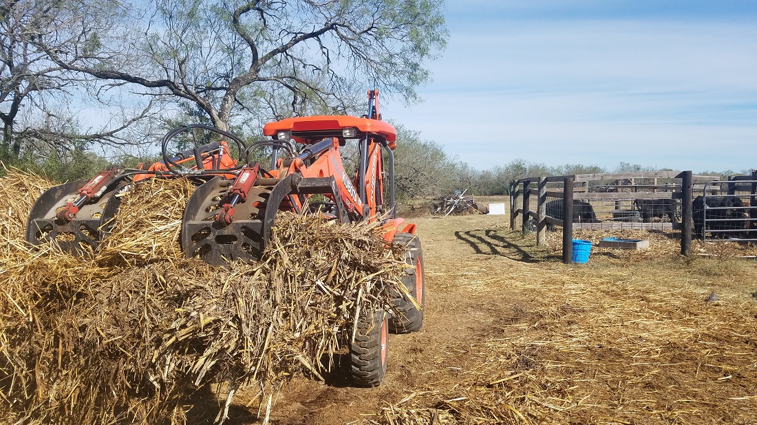

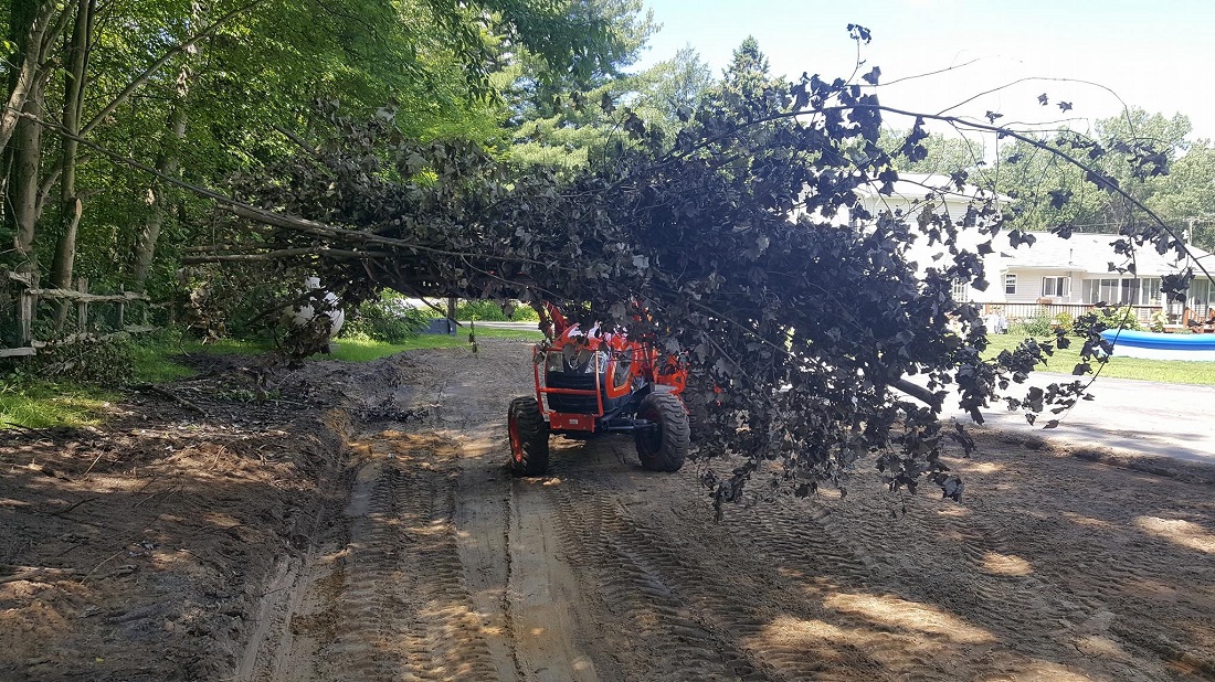

One thing for sure: any grapple is better than no grapple if you need one! I couldn't wait for an EA, so I got another brand that is more than 100 pounds heavier (and likely cheaper steel), but half the price. I recently had five large trees dropped; they all were leaning toward the house, so they were chopped from the top. I saved a bunch of money cleaning up the brush and moving the logs謡ay more than I paid for the grapple.
Mine is a "flat bottom", but I found I couldn't really run it under stuff; I essentially need to raise it up, point it at the ground, and push into the brush whilst closing the lids.

EA, On the 3rd function. I have about the same bracket. I want to take it off and bend it, so that the connections are more parallel to the ground with the FEL lowered. I think it will be easier to connect. I find the flat face connector very hard to connect.
   / Grapple decisions.... #29
I can see that being a good option. The grapple style can change configuration preferences.
Some prefer the hose saver spring kit we offer to keep them out of the way and add some flexibility.
