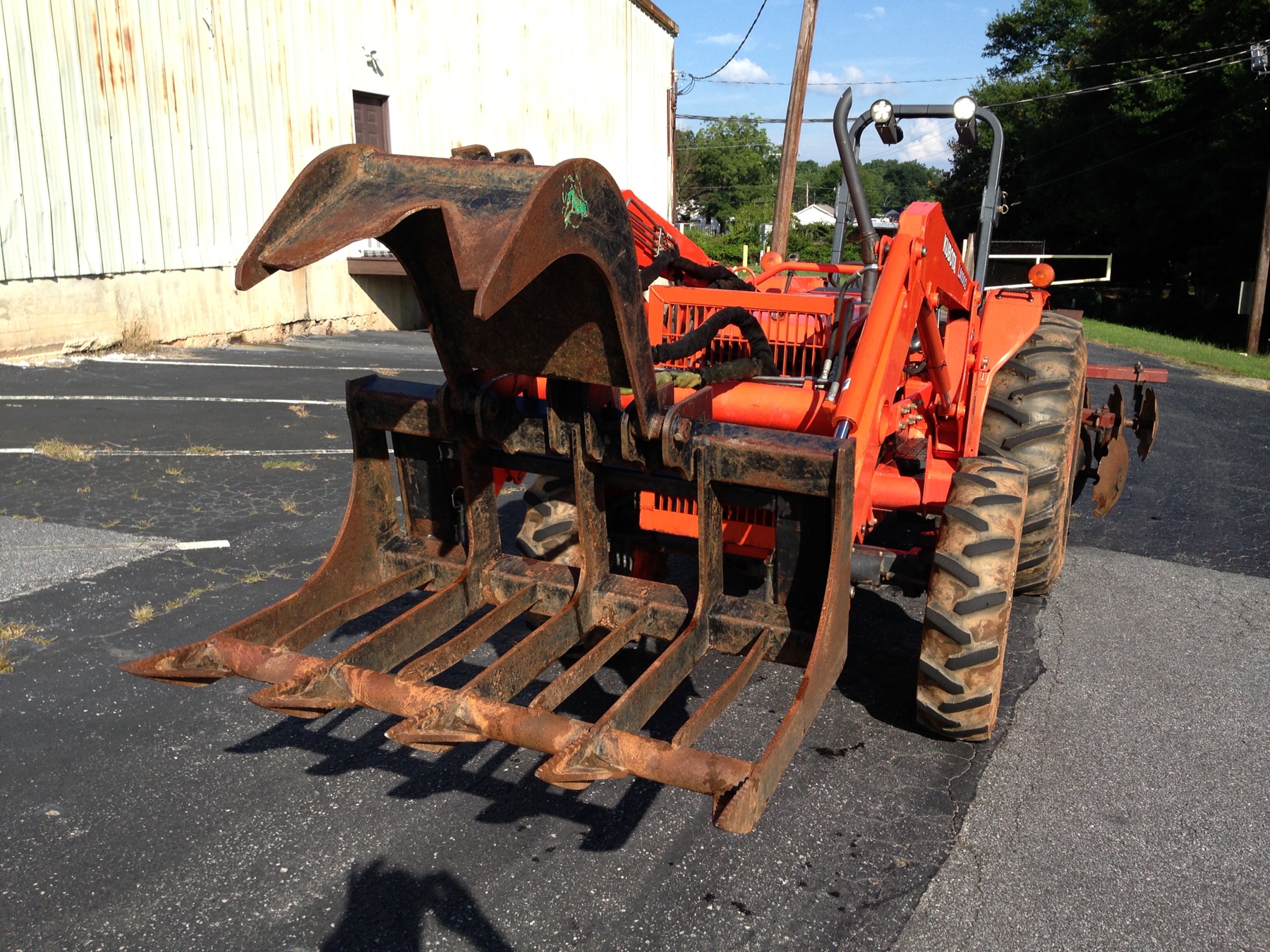

I bought my Land Pride grapple (SGC 1560) & WR Long third function valve five years ago. Had the dealer install it.
The SGC 1560 is called a rock & root grapple. Short thick tough tines. I have absolutely no brush to worry about on my 80 acres. I use it to move LARGE chunks of pine log, BIG rocks, back grading to level and smooth and limb cleanup for dead trees I fall. I've used it for everything - including pushing snow banks. Never given me a moments problems and about the only "damage" to the grapple - I've knocked some of the powdercoat paint off the tips of the tines.View attachment 577882View attachment 577883

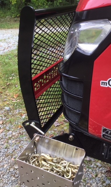

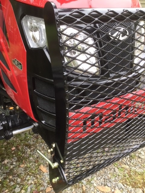

Joshua - there is one other item that I would bring to your attention. Since you will be getting a grapple - - be sure you get an OEM grill guard. Then if your OEM guard is like mine was - guaranteed to stop 40 gallon garbage cans and larger objects - its a good idea to modify the guard. I used expanded metal.
New tractor grills or radiators or batteries ARE expensive. When you work with brush, limbs, trash - - good likelihood that "something" will find one or more of the previously mentioned items. Mine is expanded metal - welded onto the OEM guard.
View attachment 577946View attachment 577947

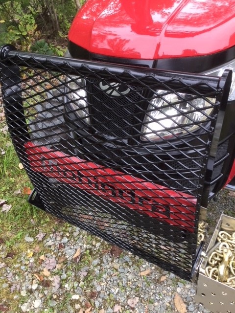

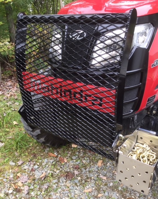

oosik, I stole your idea and modified my grill guard too. I used the OEM grill guard on mine as well. This is a mod best done BEFORE you have to replace a grille.

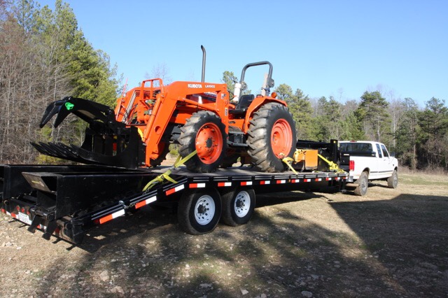

This is a very heavy duty grapple - thick, short, heavy tines and welded cross bracing everywhere. Weight - 820 pounds. The weight of the grapple cuts my FEL lifting capacity down to a tad over 3200 pounds.

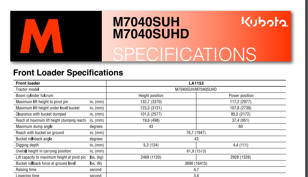

Well - lets see. I will once again check the power lift charts for my LA1153 FEL. OK - it says:
1) at a distance of 500mm( ~20") off the ground
2) at a point 400mm( ~16" ) forward of the pivot pins - a point 4" forward of the very back of the grapple jaws when open half way
3) this FEL/grapple is rated to lift 1950 Kg ( ~ 4300 pounds)
Now - using my math skills - - 4300 pounds minus the grapple weight of 820 pounds equals approximately - - 3480 pounds.
I have absolutely no idea nor interest in what a M6-141 will lift. The figures above come directly from my Kubota Front Loader Operators Manual for Model LA1153 - page 8 - - power lift chart.
Travis - check your published loader charts in the FEL Op Manual. You have one chart for when the FEL is set for max lift and another for when the FEL is set for max height. My FEL is set for max lift capacity.
Where most folks get confused - - Kubota posts lift ratings for their FELs at a point 800mm( ~ 32 ") forward of the pivot pins. That is way out at the very lip of a bucket - if that's what you have on your FEL.
The very back of the mouth of my grapple jaws is only 12" forward of the FEL pivot pins. Thats why I use a calculated figure of 16" forward of the pivot pins. Thats a point 4" forward of the very back of the jaws of the grapple.
All my noodling and calculations can't be that far off. I have several times lifted a fresh cut green Ponderosa pine log - ten feet long, ave 36" in diameter with a calculated weight of 3200 pounds. Granted, I only lift it so the grapple is about 6" off the ground - but at that weight - - thats more than sufficient.
That math seems fuzzy..... Is this your loader or a different one? Numbers look almost identical to my KL6010.
/ Grapple decisions.... #19
theKKfan - this is the current FEL on my M6040 and the info directly out of the Op Manual for that FEL.
I do not know how to answer you - if you can not follow the math - - ??
No matter how anybody looks at it - - - 4300 minus 820 will ALWAYS EQUAL - 3480. At least on this world.
The power lift charts for my FEL are simple charts - easy to read and interpret.
The ability to lift heavy loads with my FEL follows right along with what the charts say it should lift. A fresh - just cut - ten foot chunk of Ponderosa pine with the butts averaging 36" will always weigh right around 3200 pounds.
I'm very happy with the way the system works - - that's what counts for me.
OK - KKfan - look at the data you posted. It says 2928 pounds max when in the heavy lift setting and at MAX HEIGHT... I COULD NOT CARE LESS what the FEL will lift at MAX HEIGHT.
If you will re read my previous post - #16 - you will see I am using a height of 500mm( 20") off the ground. Big difference there fella........
/ Grapple decisions.... #20
I'm glad it delivers for ya, oosik. :thumbsup:
I am now even more curious as to what the M6 manual states.
It would really make these tractors look more attractive and alter some shopper's tractor choices if those numbers were published in the brochures, but the reasons not to must be more important.
Two excellent points you made...
1. It is what everyone quotes, but lift to max height isn't that important in most cases.
The claimed lift capacity of this Kubota B2920's loader is 661 pounds to max height(at 500mm beyond pivot pins).
BUT, when you outfit it with an 200 pound, Ultra Light Wicked 55 grapple and keep the load low, seemingly impossible, impressive feats like this can be real.
2. The difference in lift at the pivot pins and 500mm(~20 inches) in front of the pivot pins. Meet the Center of Gravity.
This is something else which many do not take into account when choosing a grapple or pallet forks.
Since I used the B2920 as an example, it's rated capacity at 20" beyond the pins now grows to 952 pounds at the pins.
This doesn't necessarily mean that a 1000 pound rated loader and pallet forks with 48" tines will lift a 1,000 pound pallet of blocks off(or onto) a flatbed.
Keeping the load close is very important if you want to maximize the loader's lift capacity. It's one more reason our rake style Wicked 55 makes these seemingly impossible feats possible.
