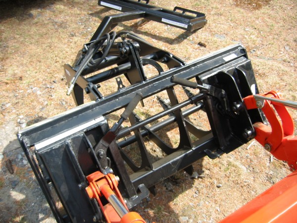

I'm happy to report that Wildkat has generously offered to exchange the grapple, for which I am very thankful. I'll be updating my first post as well but have offered to incorporate any recent or future design changes to the grapple in this thread as well since this will most likely become resource for people using the forum to research a grapple purchase. Standing behind their product is a very good sign and using these failures as a tool to innovate and improve the product will be even better. Check back a little later for the details.

I'm glad they are stepping up and exchanging it for you. Is this one going to be a updater design?

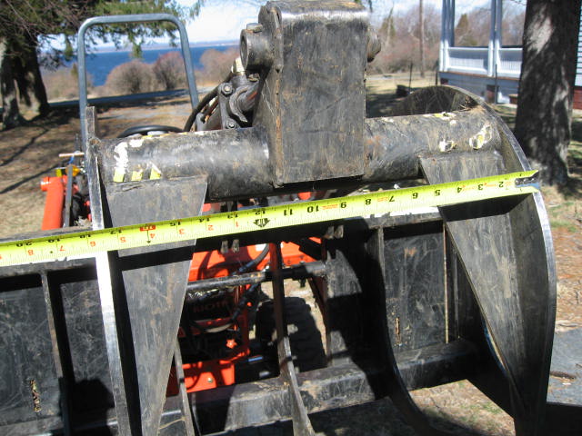

Yet to be determined. I've requested details and hope to be able to relay good news of an updated design here. Reinforcements are easier to do before damage than afterwards so if not, I'll heavily reinforce before use but it would be great so see updated specifications as a new standard for this product.

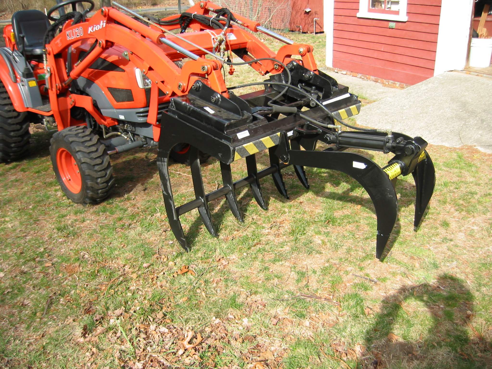

I am also glad to hear that they stepped up since I bought the same grapple and it just arrived a week ago. I have used it for a total of 30 minutes to move some downed tress around in the snow/mud and it seems to work fine. I do understand that it has limitations when compared to the heavier units costing double or triple the price. I was also concerned about having too much weight on the front after reading posts on this site so this model seemed a fair balance between price, weight & function.

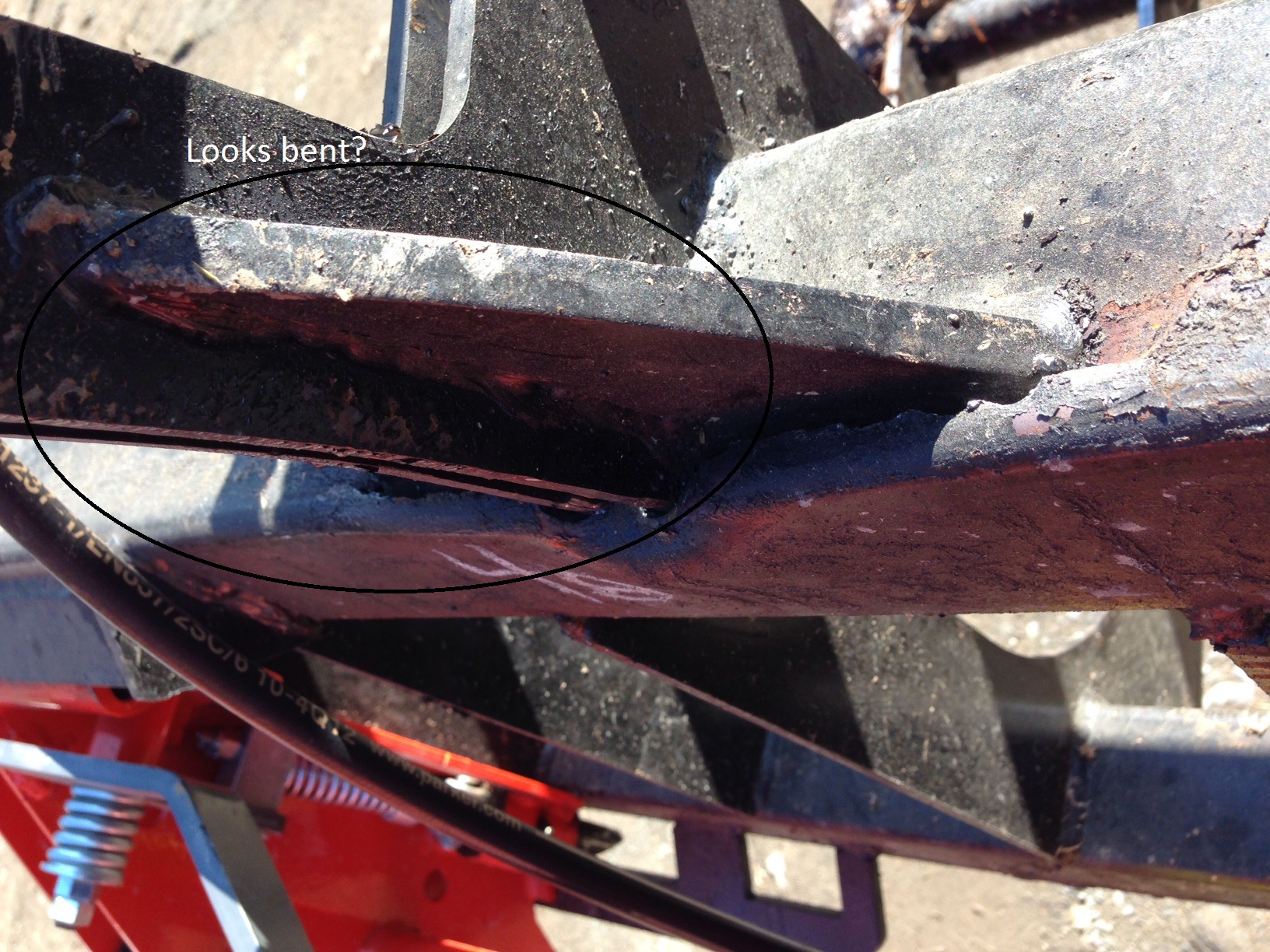

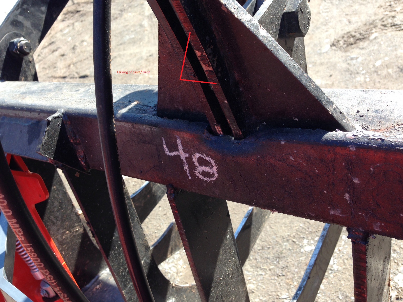

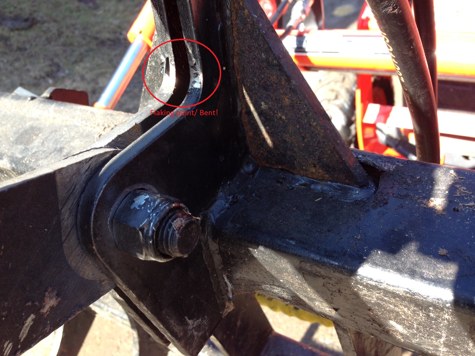

I used the grapple for about 20 hours or so before it failed and it worked fine as well prior to failure. I think it was the cumulative affects of the cylinder applying pressure to that top tube every time you clamp down on a load. Your machine is also a lot bigger and more powerful than mine as well so if I were you, I'd reach out to them and see if they will confirm the top tube thickness on yours is 1/4" thick. If not, I'd strongly encourage you to reinforce it prior to using it much as it is a much easier to reinforce prior to damage than afterwards. I am paying shipping charges, which I think is completely fair under the circumstances, but it is still an expense one wants to mitigate, not to mention the hassle of it all.
   / Grapple Failure #106
Might it be productive to install a separate pressure relief for the grapple cylinder? Replace the cylinder with a smaller one? Or is that just way overkill?

That is my perspective. I plan on keeping the grapple and reinforcing it if needed, to do the job I bought it for. Welding on some extra steel while everything is straight and true is a much easier prospect than repairing one that is already wrecked. I'd like to see them make an improvement to the product by upgrading to 1/4" steel and/or improving whatever else is causing these failures and thrive in business as a result but it is unreasonable, in my opinion, to demand they redesign the product to replace mine with a new and improved model, if they have not made the improvements already. If Whirlpool comes out to repair or replace a broken dishwasher, it would be unreasonable for me to demand that they redesign the dishwasher before replacing the broken one.

I agree. The first thing I would do is drill a 1/4 inch hole in that top tubing and see how thick it is. If it is still 1/8. then reinforce it to distribute the stress and carry on.
