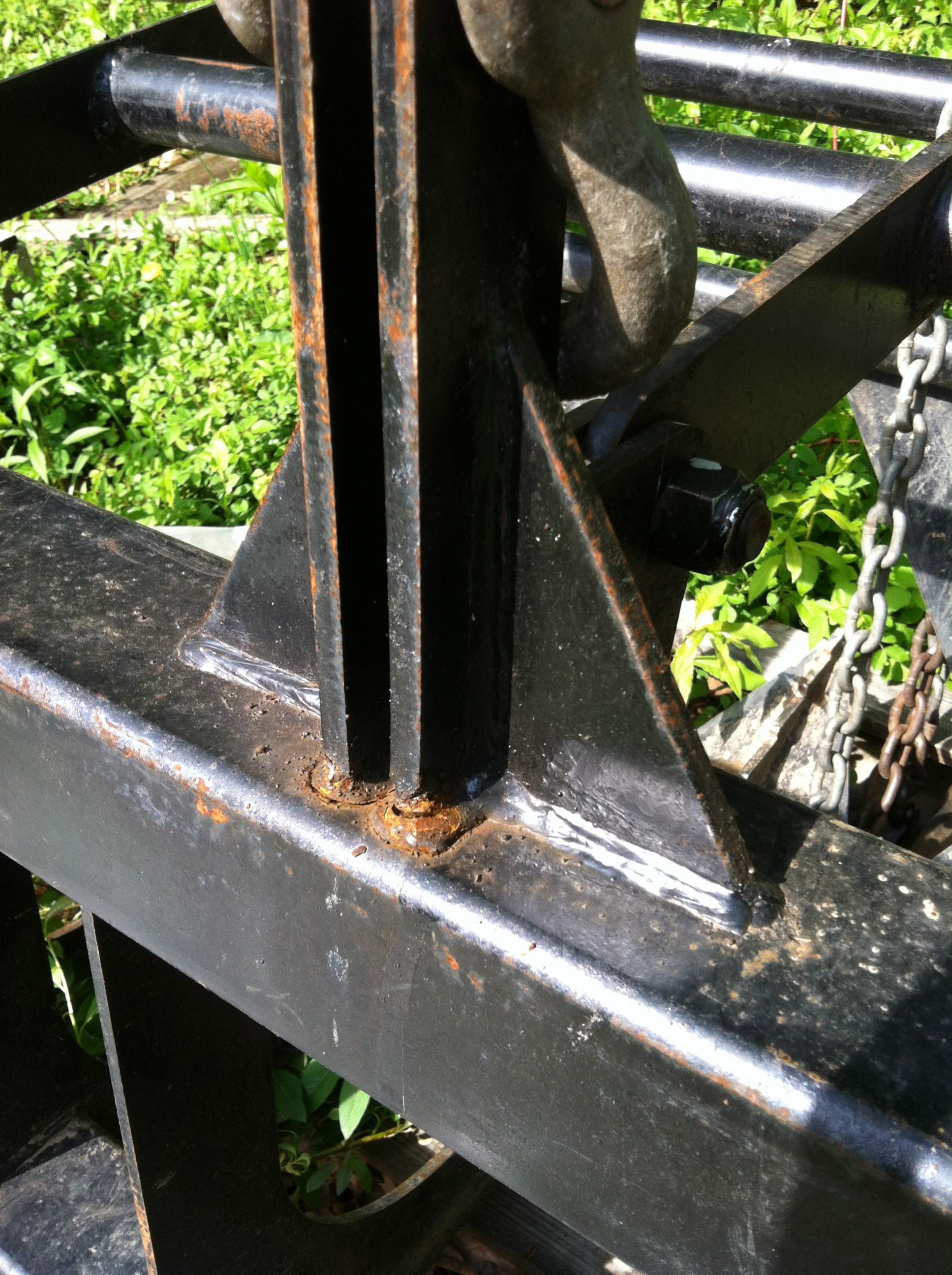

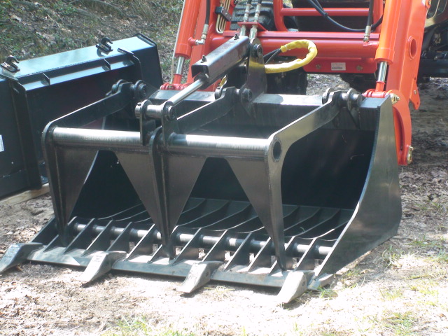

By the way, here is a photo of the tower design of the EA "wicked" 50 inch single lid grapple. <img src="http://www.tractorbynet.com/forums/attachment.php?attachmentid=368598"/>
Looks like an engineer was involved rather than just a welder. Looks good. I think EA may use less than 1/4" but high strength if I recall just as their tines are 5/16th rather than 3/8th but are high strength.

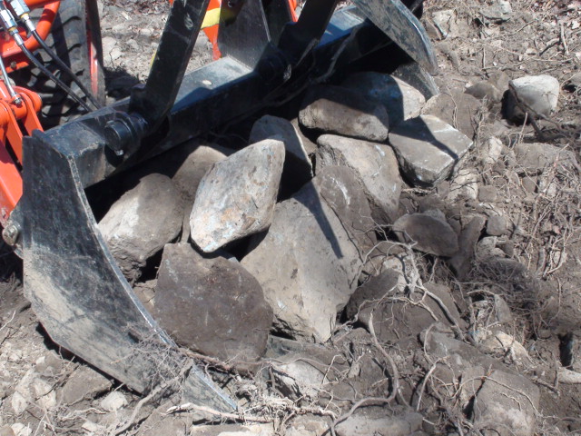

Here is the last thing an embedded rock I want to dig out see's :)
The tines still match up perfectly top and bottom and I have dug out several stones that I think weighed close to 1000 lbs.
It does seem that the steel is high quality in this unit.

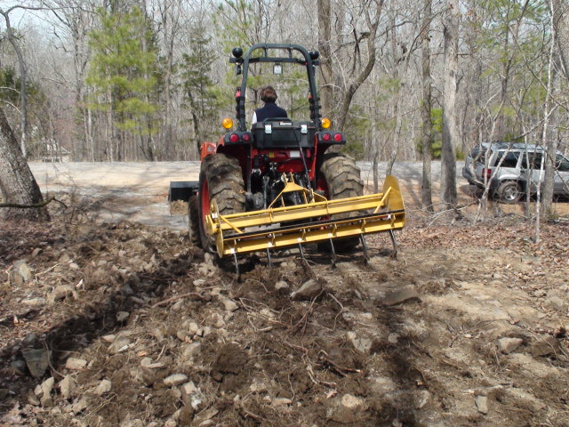

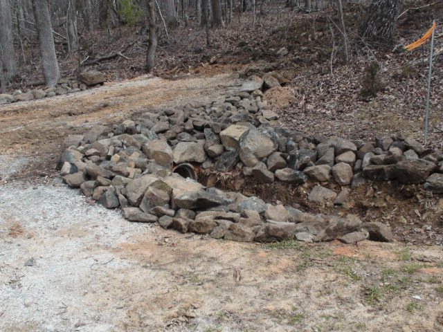

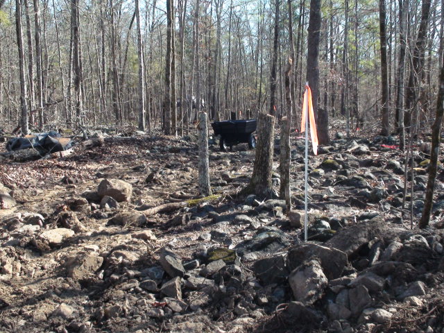

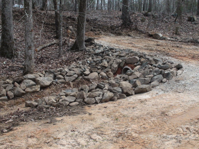

Attached are a few pics of my property, most of which have been posted on TBN in other posts. The rocks in the bucket are not the large ones, with each one coming close to maxing out the tractor.

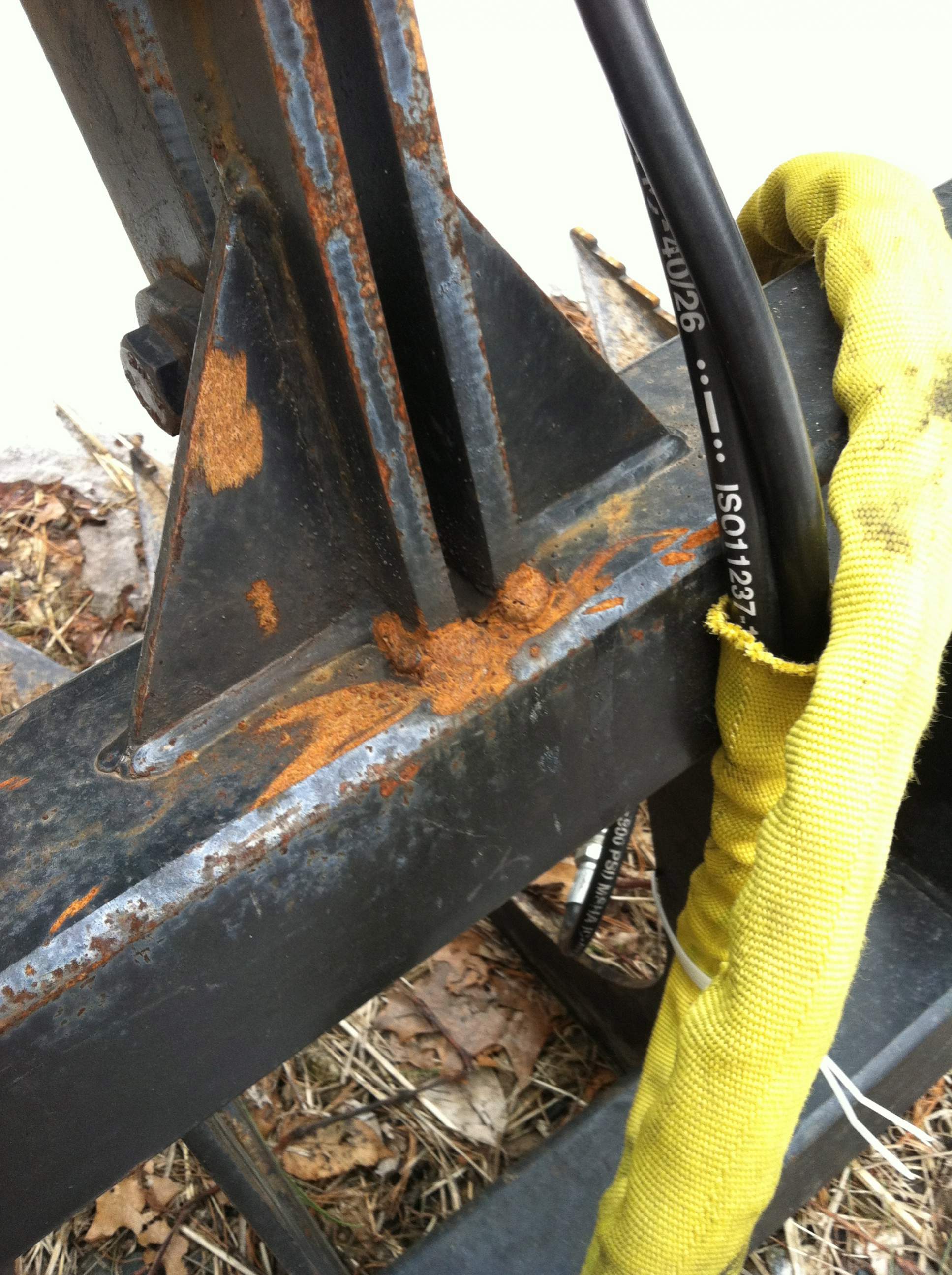

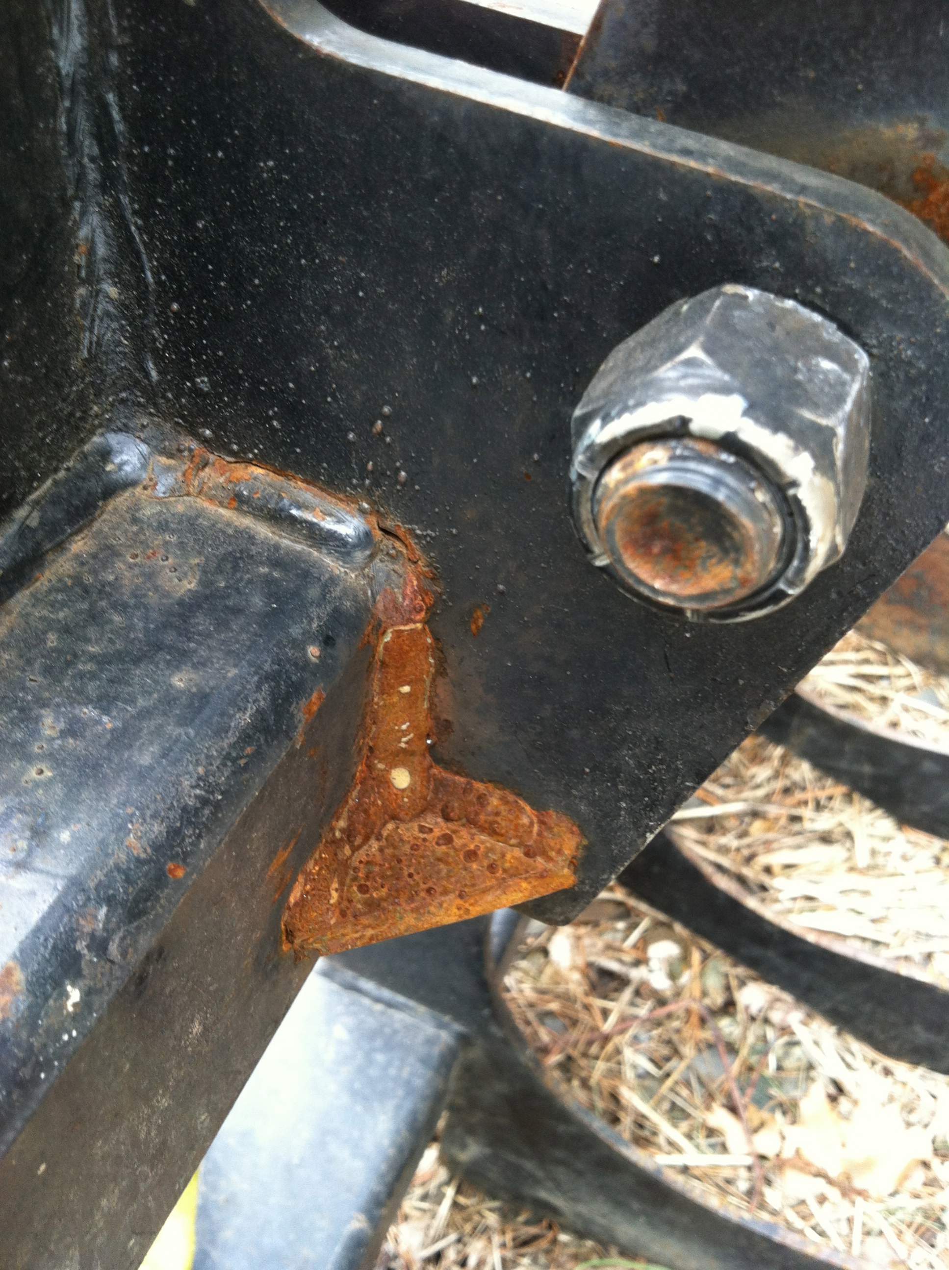

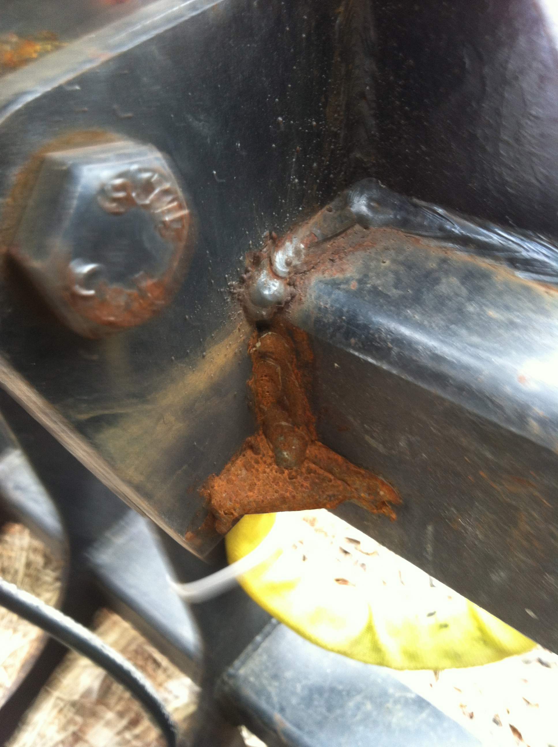

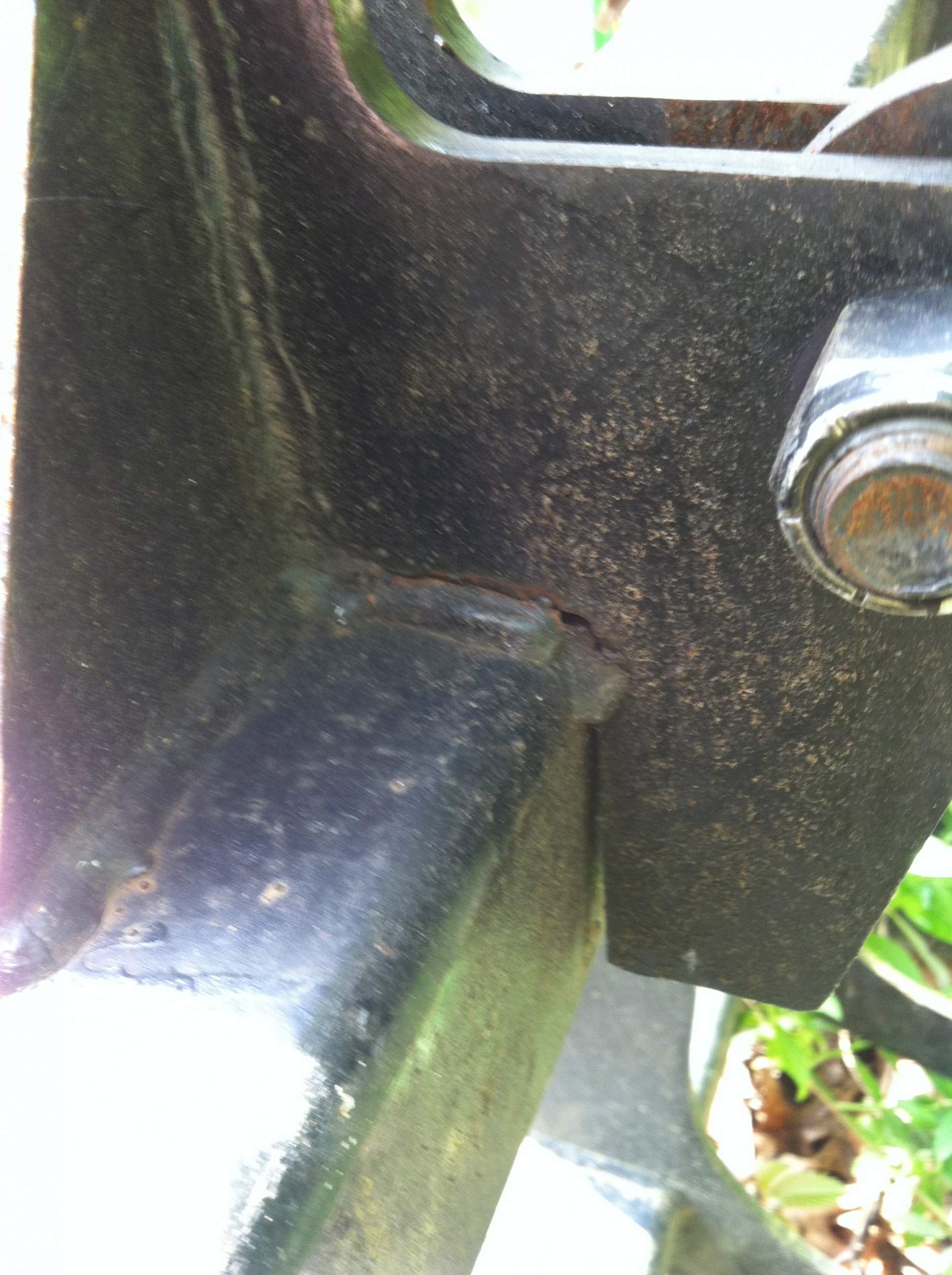

View attachment 367818View attachment 367821View attachment 367824View attachment 367825View attachment 367826Wow do i feel guilty- I'm one of the wildkat 48 boosters who has published many "endorsements" on this site. My point- **** of a value. I paid under 700 bucks delivered to Mass. And guess what? I broke mine too! Not wildkat's fault- my fault.

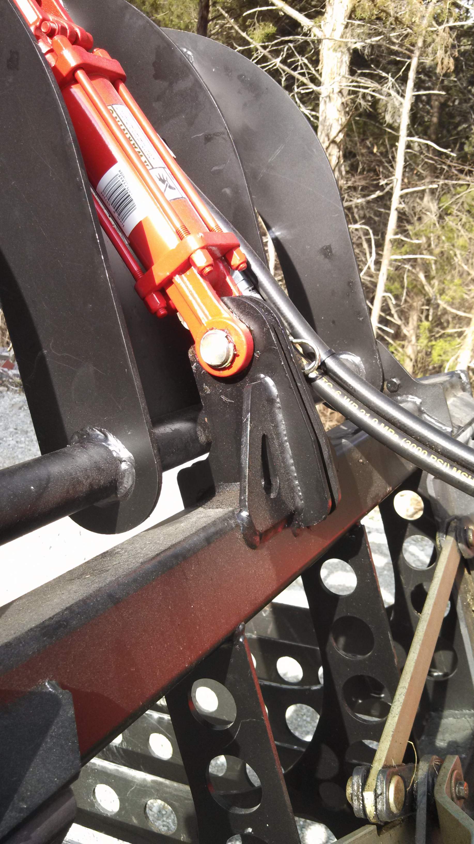

A lot of good comments here by CalG, Puckginder 85, and Island Tractor to name a few. I don't know how you damaged yours, but I suspect the hydraulic cylinder had nothing to do with it.
What I did was foolishly try to "hog out" a good sized boulder by rolling the grapple forward, opening the jaw, then lowering the upper grapple on the lip of the rock and backing up-and I'm talking about 60 HP (4720 cab), loaded R-4's, and about a 500lb weight block that is adorned with about 60' of 3/8 chain. Next thing I knew the grapple in the "closed position was about 10 or 12" from closure.
Remedy? I took the cylinder off and used a heavy chainfall to pull the grapple to the closed position. then I did a half assed repair by welding the back side and adding a couple of gussets to front. I will beef up the back side when I get a chance with some angle across the top,
Attached are pix showing the two breaks, and three shots of my quicky fix. Also a couple of pix "in action". IMO still a good value! Just have to use your head
