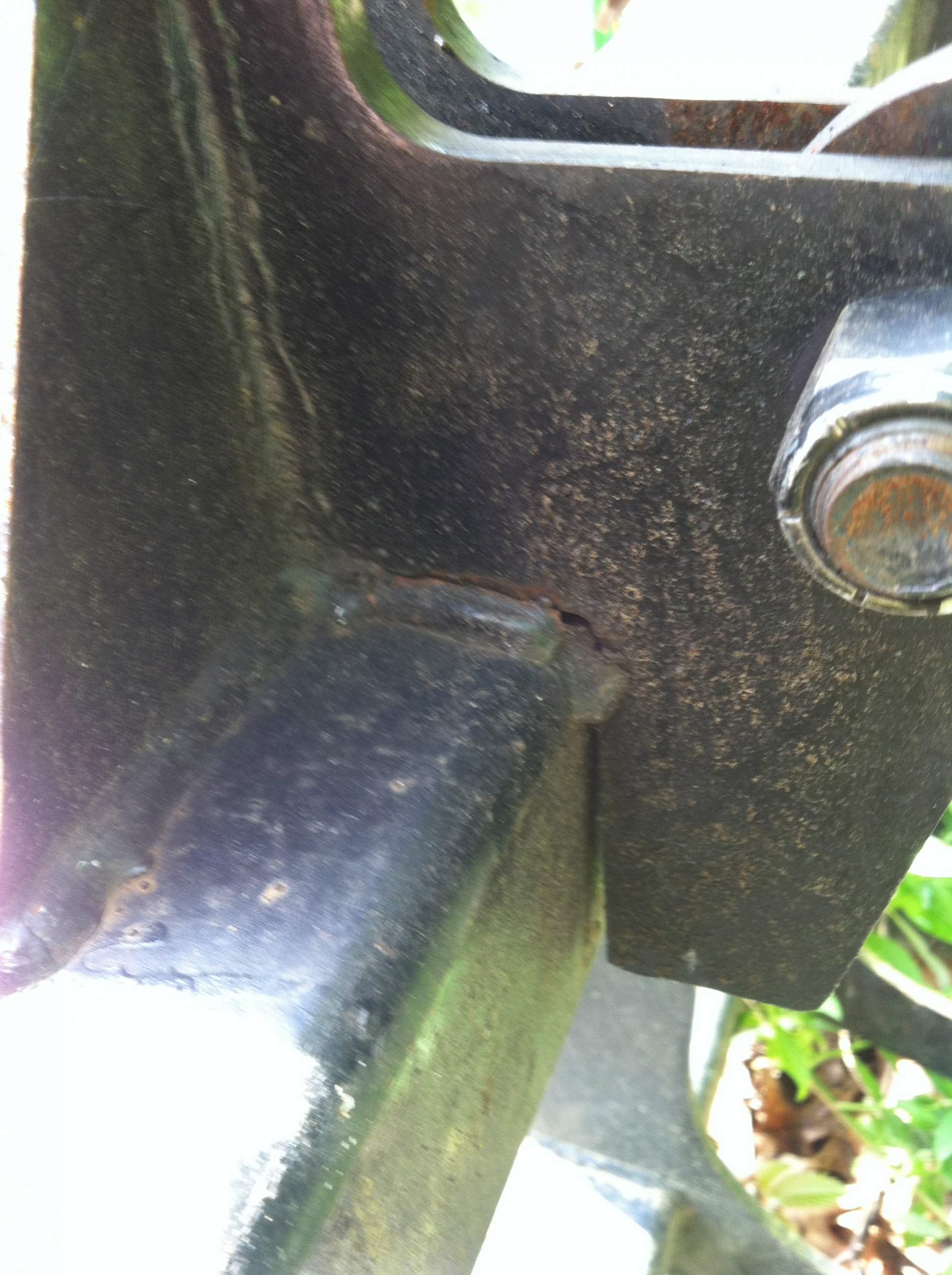

That is my perspective. I plan on keeping the grapple and reinforcing it if needed, to do the job I bought it for. Welding on some extra steel while everything is straight and true is a much easier prospect than repairing one that is already wrecked. I'd like to see them make an improvement to the product by upgrading to 1/4" steel and/or improving whatever else is causing these failures and thrive in business as a result but it is unreasonable, in my opinion, to demand they redesign the product to replace mine with a new and improved model, if they have not made the improvements already. If Whirlpool comes out to repair or replace a broken dishwasher, it would be unreasonable for me to demand that they redesign the dishwasher before replacing the broken one.
I agree that is a good solution for you if you are willing and able to do the necessary modifications. However IMO, until we learn that Wildkat has actually changed to 1/4" wall top tubing, anyone contemplating a grapple purchase should steer clear unless they 1) have a very light weight machine with limited loader power. Or 2) intend to give it the Lada treatment and put some reinforcement on that top tube before ever using it. As it stands, I wouldn't put one on my old CK20.

How would one EVER calculate the destructive loading on that top transverse member?
The failure was in the HAZ, a very difficult region to quantify. (What is the shear value within the HAZ?
Sure adding material will do in a "belt and braces" approach, but if a 2 inch cylinder will not work, how can one say a 1.5 inch cylinder will. Or, what value would one set the pressure regulation valve ?.... 2500psi? 2250? ... or start at 1000psi and see how things work out clamping on material wise. tuff call I would say.

The damage in the previous thread was not from closing the cylinder. It was from pushing with the lid. Granted you should not push on the lid but a little is unavoidable. They just need to use something besides pop can walled tubing.

I know I came to this late.................. Checking online steel prices:
3x3x1/8 wall x 4ft weight 19lbs, cost $30.65 includes $5 cutting fee, no shipping fee
3x3x1/4 wall x 4ft weight 35 1/4lbs, $36.72 includes $5 cutting fee, no shipping fee.
16 1/4 lbs more metal for $6.07 more. Or $1.52 per ft.
Another thing about square tubing, wall thickness can be plus or minus 10%, so your 1/8" wall might only .113"

I agree. The first thing I would do is drill a 1/4 inch hole in that top tubing and see how thick it is. If it is still 1/8. then reinforce it to distribute the stress and carry on.
James, look at the cylinder mount on it then compare it to your grapple. The Wildkat looks like a poor design even though it is made out of 3/8''.

IMO using thin wall tube for that area is not really the problem, but the design itself. There grapple mount should be two plates (1/4?) that are welded to both the top tube and travel down to the bottom tube.

Because the FELs have a rather small payload capacity on these smaller compact tractors, let's remember there is a real need to NOT over-design them. That is as much a reason why people choose these 48" "economy models" than just saving a couple hundred dollars. That was the case with me personally. I attempted to balance strength with weight but cost is obviously part of the equation or I'd have a titanium grapple or whatever. It's a real balancing act between weight and strength and some companies are going to do a better job than others.
I can actually understand why thinner walled steel may have been used to shave down some weight at some point but if that decision leads to an abnormally high failure rate, then it obviously needs to be corrected. What we don't know though is how many of these units have been sold and how many had/have problems. We have two on this thread but those could be due as much to bad workmanship than to a design flaw and the actual failure rate could be quite low. I'm not saying I believe that is the case but I'm also trying to have a balanced view through all of this.
If 2 out of 100 fail, is that bad? 1 out of 100? 5? Everyone is going to have a different number and I'm sure they could achieve a zero fail rate but what would be the weight penalty we would have to endure as a result? As long as the company stands behind these failures and does right by the customers, a 1-2% failure rate might actually mean that the grapples are designed appropriately for their use. Just a thought.

The proper way to make a lighter grapple is to use high strength steel rather than lower gauge mild steel. That is essentially what EA did with their new light duty grapple. The other consideration, if you intend to stick with lower gauge mild steel tube is to engineer it properly. Not only does Wildkat use 1/8" tube but they also use a higher cylinder tower which puts more leverage force on the base. Putting in some extra support at the predictable stress points would work but increase cost due to additional welding. Yes, some builders will choose the HF strategy and just build it cheaper and cheaper until it breaks, but I for one would like to know that I am buying an HF quality implement. Is that what we should expect from Wildkat?
I don't think any of us know the exact failure rate of these 1/8" top tube grapples. I would guess that all of these 1/8" grapples would fail at the same spot if used aggressively or at the point when a predictable accident puts a bit more stress on that rear cylinder tower. Probably not likely if the tractor is a BX or B size just moving brush piles but for someone with an L size tractor digging and moving stumps and trees etc the safety margin is slim. I don't recall anyone with a 1/4" tube grapple having this same issue despite using this general light duty grapple type on tractors as big as M59s.
