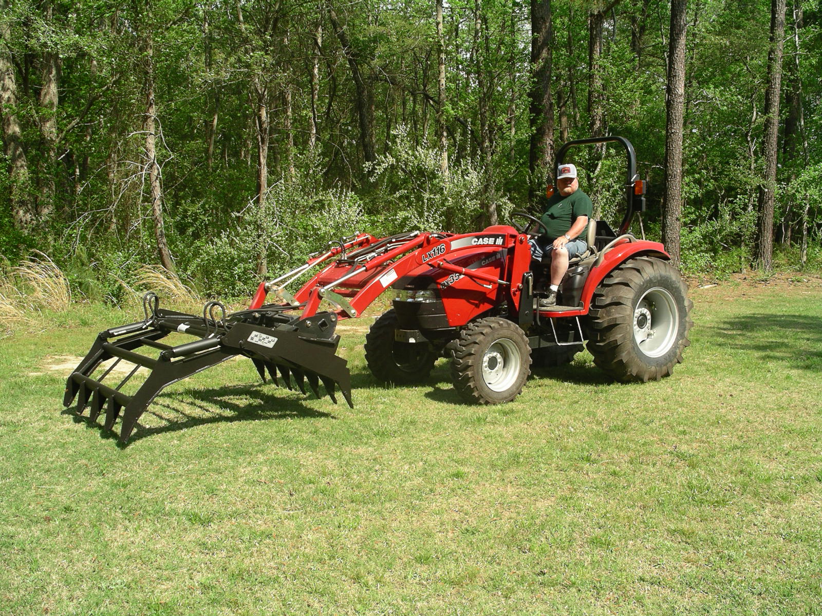

Dave thanks for the heads up some nice quality attachments there price are very reasonable , however I didn't see what I'm looking for I have a grapple I need something that opens wider to grab more material here is a picture of exactly what I want to buy, it's on a smaller tractor probably just for display purposes take care

The WRLong RBG clamshells are very nice though heavy. The RBG2 line is a bit lighter and doesn't open quite as wide but is still a clamshell. Both cost at least double what the light duty standard grapples do.

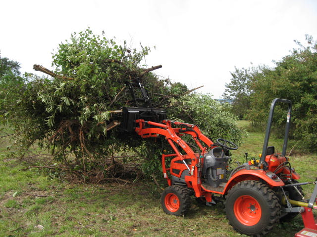

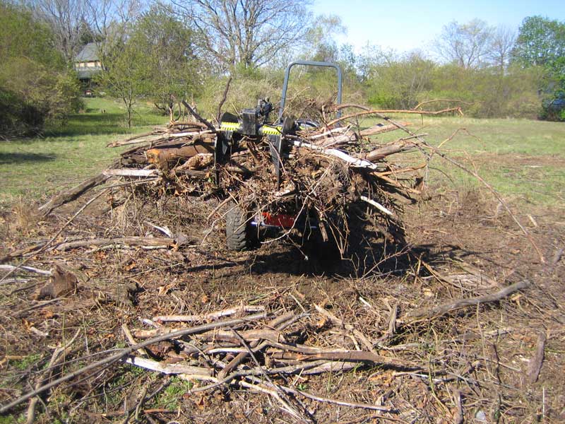

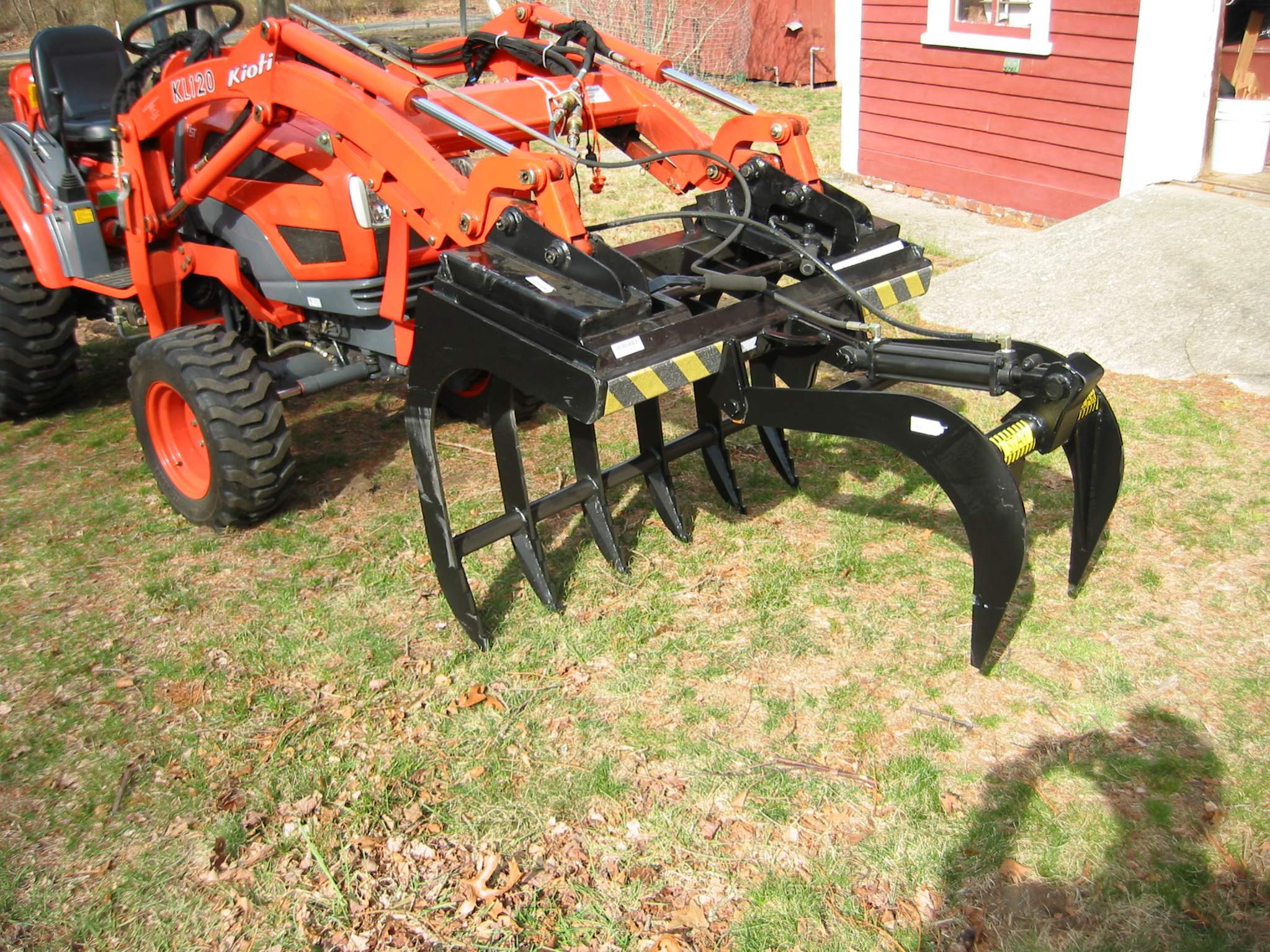

I appreciate the focus on a clamshell for picking up lots of smaller stuff or brush but would point out that while in theory the clamshell should have an advantage in brush pickup, in practice there is not really that much difference. See a few example photos below of brush picked up by a 48 inch standard grapple with a single 18 inch upper jaw. The theoretical advantage of the clamshell disappears somewhat when brush is "sticky" as most slash and cuttings are. Holding the middle of a pile with the upper jaw does a good job of securing a load that is quite a bit bigger than the width of the grapple itself. Balance that against the disadvantage of the clamshell which is that only the upper jaw holds things in place on a clamshell, there is no added benefit of just plain gravity which does help hold big bulky loads in a standard root grapple. A standard root grapple for example can hold a variety of different sized logs/trees in a single bite/load as you simply cram the load in and then shut the grapple to hold it in place. With a clamshell if you cram a tree or other object to the back of the grapple it will prevent the upper jaw from closing further than needed to secure that one object. Everything forward of that one tree/log/whatever will then fall out of the grapple. Clamshells are better for picking up small non sticky debris such as cut firewood as individual pieces don't hold together like brush does.
Photos of a light duty standard "root" grapple with single upper jaw: Note especially how brush piles are sticky and a much larger load can be carried than grapple size would indicate. Also, note the photo of the rock resting on the bottom tines with the upper arm simply providing a steadying "thumb". If I tried to pick up that rock with a clamshell I would need to use the full hydraulic pressure on the upper jaw to be able to hold the rock in the grapple. That means that with an asymmetric rock I would be twisting the upper grapple arm.
