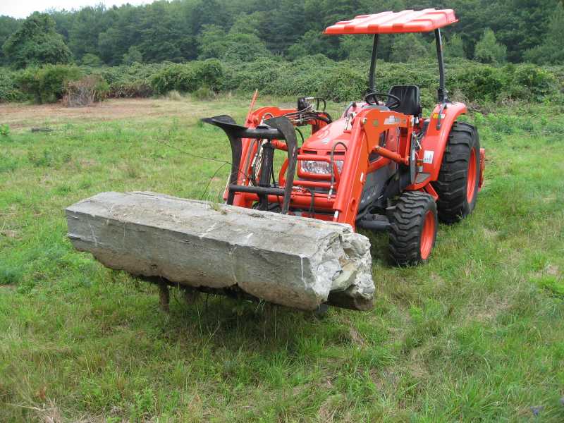

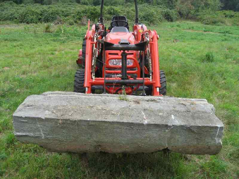

These are clamshell grapples. Notice that without the upper jaw clamped, nothing will stay in the grapple. I don't like that style as it limits how much you can load and essentially prevents you from cruising around loading bits here and there. You need to take one bite and then hold it until you unload the grapple.
What I mean by curved bottom tines would be if the GR-L or GR-M had bottom tines that extended horizontally forward about another two feet and still had that type of curve. To me an ideal grapple would look like the letter capital C with the bottom long enough to hold stuff with just the aid of gravity when the upper part of the C was open.
Here is a photo of something I can do easily but no clamshell grapple can ever do:
