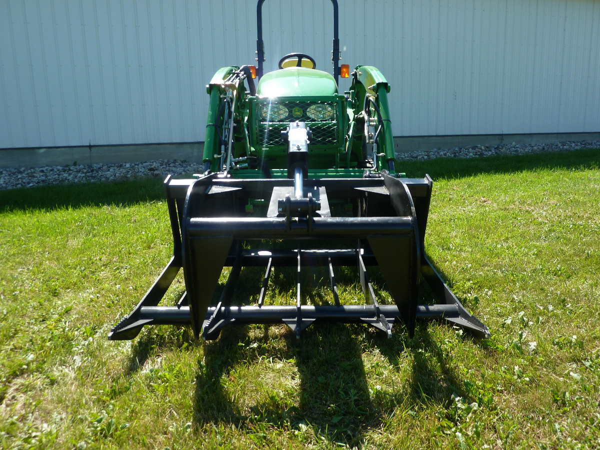

Getting a W.R. valve installed this week in preparation for a grapple of some sort. Have bee doing a ton of reading on the subject- what I would like is a combo rock bottom(for smaller to medium size rocks-rock I want to sift out) with grapple that would be light enough to remain effective on my 300cx loader. Markham seems to be the hands down winner on this site- thoughts? Ati and others make options as well. Just haven't seen quite the rock bottom/grapple I am looking for?
/ Grapple Options #3
Call Mellisa at Markham...they will build it to your specs by adding in tines to the bottom. Available in the JDQA setup as well.

I just bought a Markham 48" LD grapple a few weeks ago. I bought extra bars in the bottom to prevent things from falling through. I am sure they would put still more bars in the bottom to suit your needs.
While those skid steer buckets are nice....the may get a bit heavy for tractor applications....thus using up all the tractors lifting ability on iron...instead of rocks and trees.

I added one extra tine between each standard tine. They only extend to the round pipe...thus keeping your dig and root scarifying ability of the tines. I belive they are now about six inches apart. I imagine they add 50 lbs of weight or so. AND....as Island said....specify your connectors. I got the flat ones with mine and had to cut em off and put on Pioneers. (you'd think they would know that the JD mount would need JD couplers.....but Nooo.) Markham charged me $100 for the extra bars welded to the grapple.
The round "pipe" is designed to provide flotation when using the teeth tips to scarify the land.....thus, when angled correctly, they prevent over penetration. (or so it is said....I have not used mine yet....as I am sidelined from back surgery...but it makes sense to me)

more pics so you get idea of size and mounts of the Markham. I think it looks huge in this first pic.....maybe the camera angle? The 48" grapple measures about 52" IIRC.

I got my grapple from Markham with the narrow width (18") upper grapple. I probably saved a little weight, and it does let me pick up rocks with more precision. It still does a great job on brush.

Thank you for the info. I did talk to Gator (Markham) today and they will install up to 8 extra tines in the bucket bottom on the 48" light duty grapple. There was a little confusion regarding the proper bucket bracket for my loader but Thanks to foggy's pictures I think we got that straightened out. Will also make sure i get the correct hydraulic connectors as well. Price seems reasonable and I think the tine width (i guess about 3.5" spacing) will work well. Am getting nervous about the weight as the extra tines would add at least 60 lbs, pushing total weight near 500lbs. Didn't realize I had grapple options so I will ask about that tomorrow. Probably going to go this route unless a better alternative surfaces in the next day or so. Very much appreciate the advice, guidance and the pictures. Can't say that enough.
