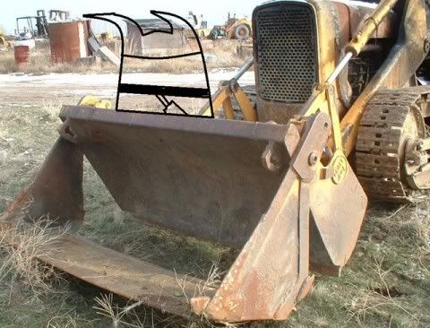

Ok, this might sound like a crazy idea but what about putting some of those addon grapple arms on to the top of a 4 way bucket. Then you would have the best of both worlds and never have to change buckets. :)
Something like this
Anyone ever done this or am I completely crazy?

I would not go so far as to say you are completely crazy but you'd better figure out a way to control both the grapple and the 4n1 with dual diverters or a diverter plus rear remote. Needing two control functions for something on the FEL is unusual so most tractors aren't set up for it. As noted, if you have at least one free rear remote you could run hydraulics from there to the grapple on top of using a diverter for the 4n1.
The main reason people don't do this is that the 4n1 does a fair job of what the grapple does anyway. The grapple is better at brush but the 4n1 is capable of doing that too so there is relatively little to gain (especially given the hassle of rigging two extra hydraulic controls for the FEL).

I realise that hydraulic control would be a bit difficult unless you had rear remotes. I was just wandering if anyone had ever done it.
   / Grapple or 4 way bucket? Which one? #9
I follow most of the 4n1 and grapple threads on TBN and I've never heard of it being done.
