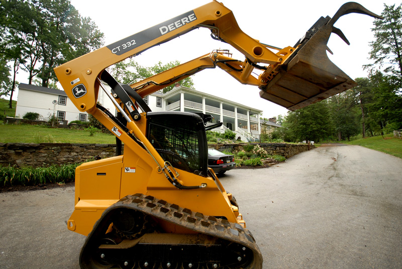

If you want to move Brush, nothing beats a grapple.

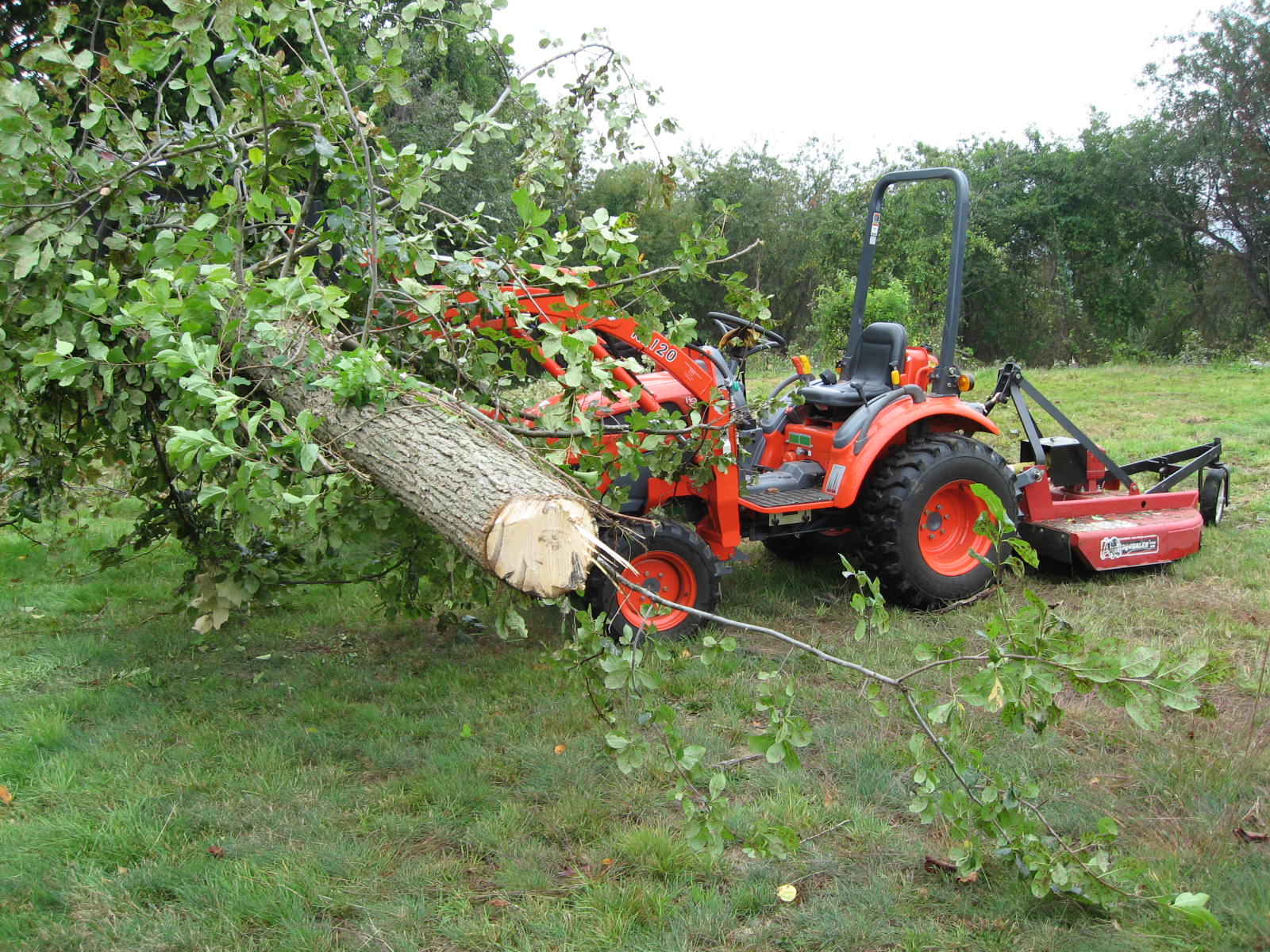

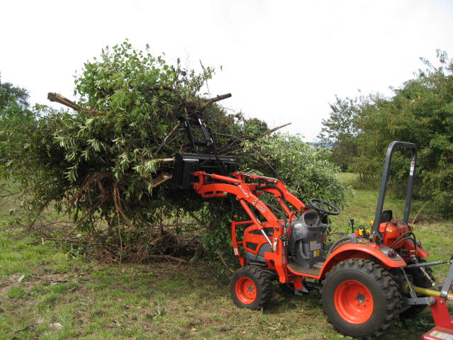

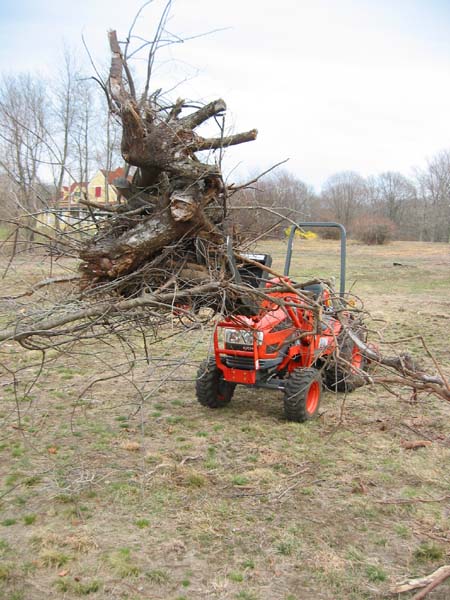

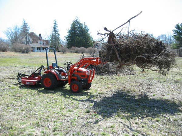

Yep. Try this with a 4n1 (photos). 4n1 is a versatile tool to be sure but a grapple will outperform it in every way when dealing with brush or logs.
