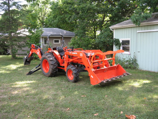

I was going to suggest modifying your old bucket with a Brush Claw from these guys:
the W e s L o r group....Excellence in Metal Processing
They add about 160lbs. to the weight of the bucket. The toothbar seems to make it more effective for brush pickup. They're easily removed and, when not in use, work well to prevent load rollback when the bucket's raised too high. Mounting brackets bolt to the bucket. Not cheap though. I recall around $1400 installed with hydraulic valving. It uses a simple standalone control valve; it's not integrated with the loader control. Had mine since Dec. 2004.
They will provide it in kit form. It's worked well clearing brush for me on the L4300. I've also moved some 20 ft. long I-beams with it.
Bob
