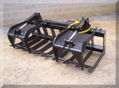

Here's a picture of me lifting a 18' long, 2' diameter pipe that has about 3/16" walls. It's HEAVY! It lifted it all the way to the top, no problem. I think I will be OK with this heavy duty grapple, but I wouldn't recommend it for any compact tractor, it's just too heavy and big. It would work good on a large tractor, backhoe or large skid steer. Man it's powerful!
The brand is Piranha.

Glad it has worked out for you. It sure looks like one heavy duty grab :D

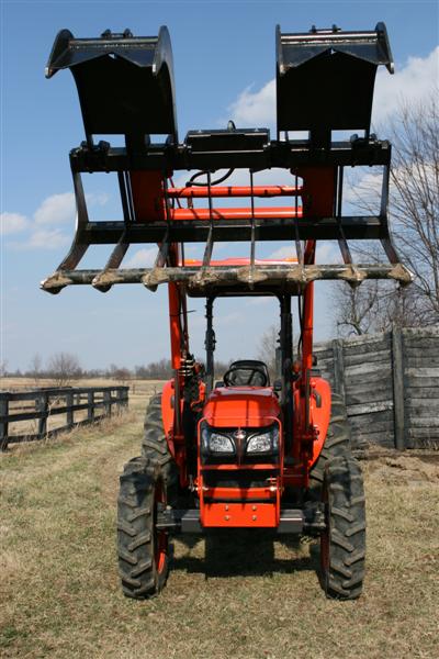

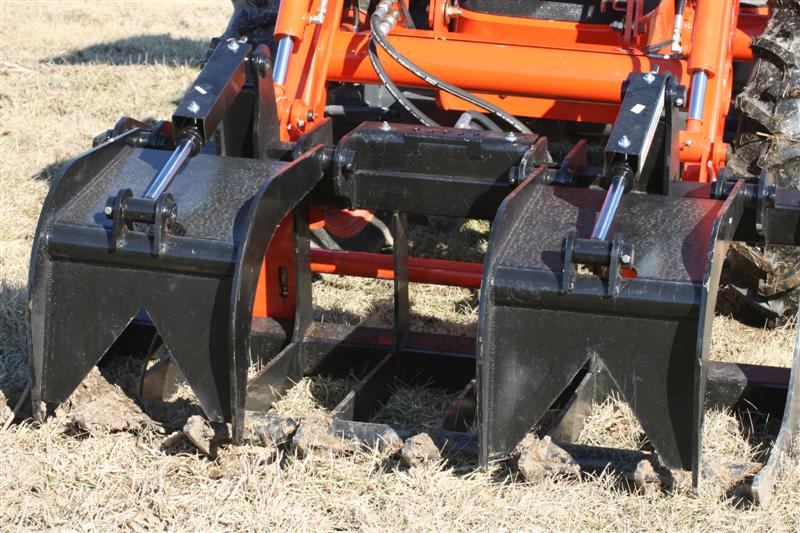

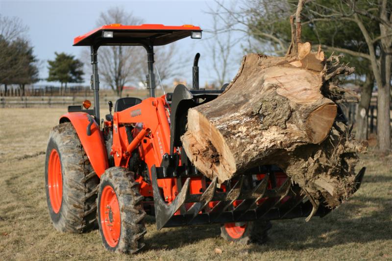

That grapple looks almost identical to mine. I got mine from Markham and it is really almost too heavy duty. It is the 66" version. If your lift capacity is 2,500lbs you should be okay though. My lift capacity is a little less than that. I moved a huge stump with mine and it wasn't maxed out.
