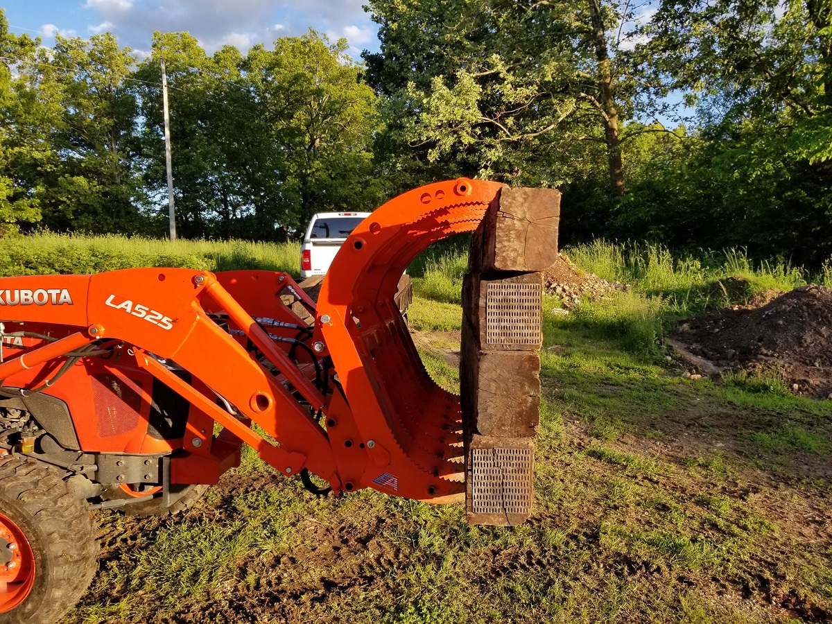

   / Grapple Overload - MX5800 Needs A Grapple #5
well, You are either going to have to spend the money for 3rd function, or rear remotes. Both are about the same price, but if you do rear remotes, you will still have to purchase hydraulic lines to run to the front of the tractor for the grapple.
I didn't have rear remotes and had dealer install 3rd function.
I bought an EA Wicked grapple, which isn't cheap, but they are built like a tank and they are very light, as to not taking away from your lift capacity
So, I have about $3500 tied up in 3rd function and grapple

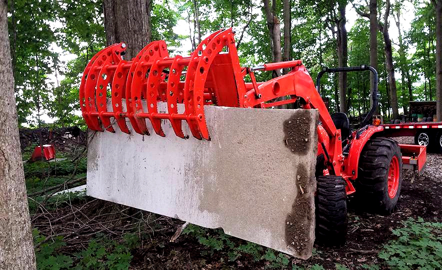

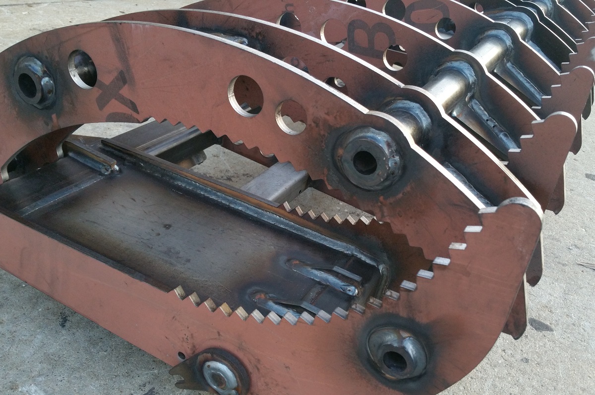

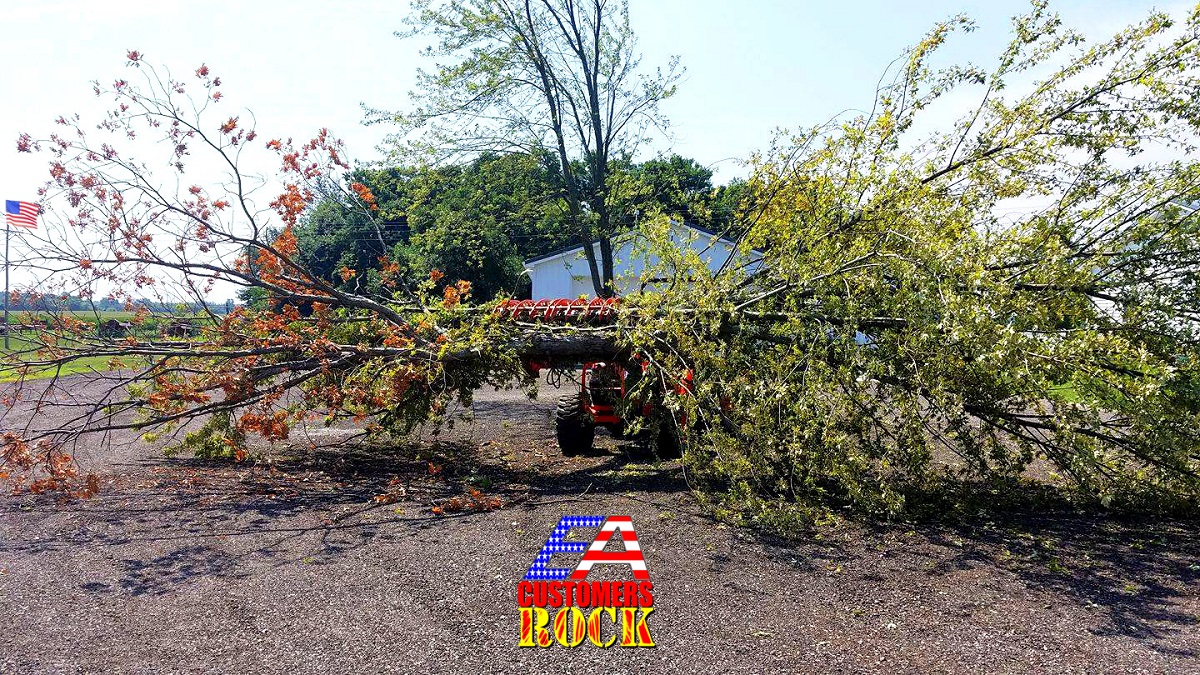

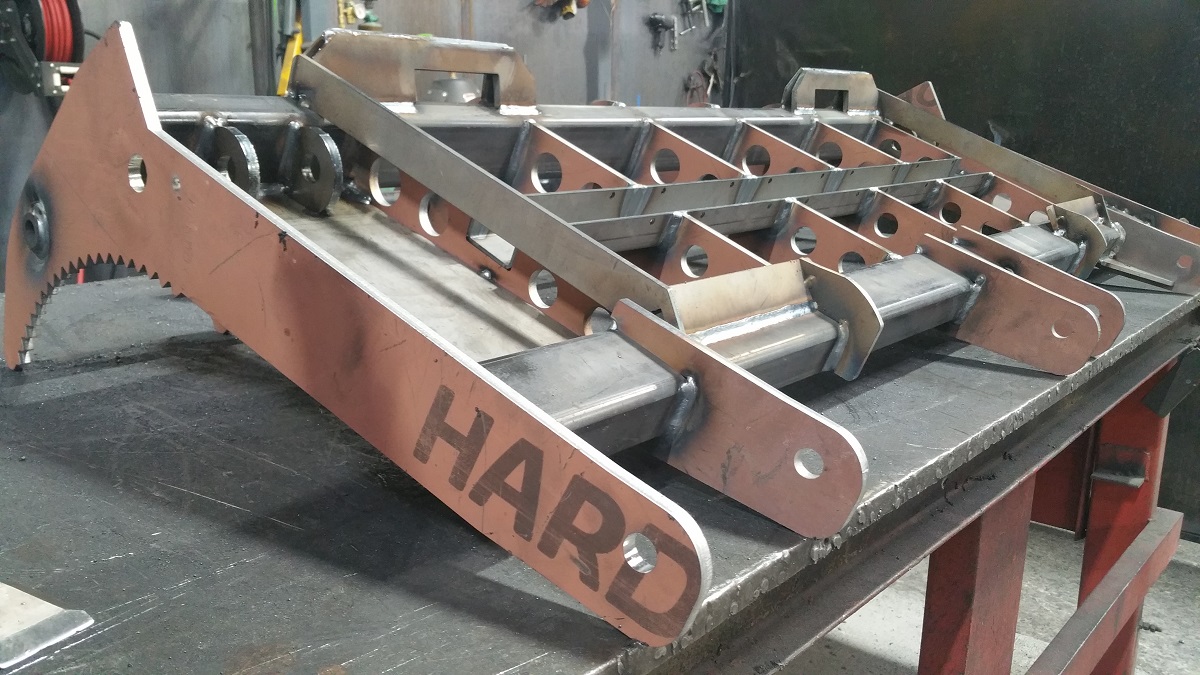

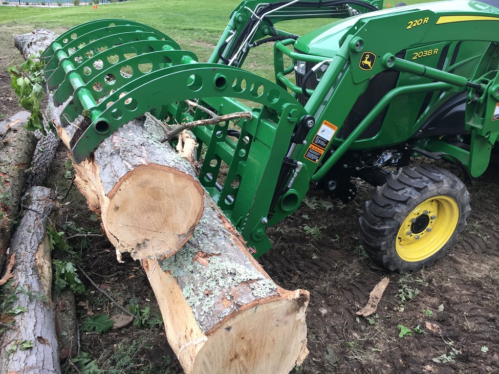

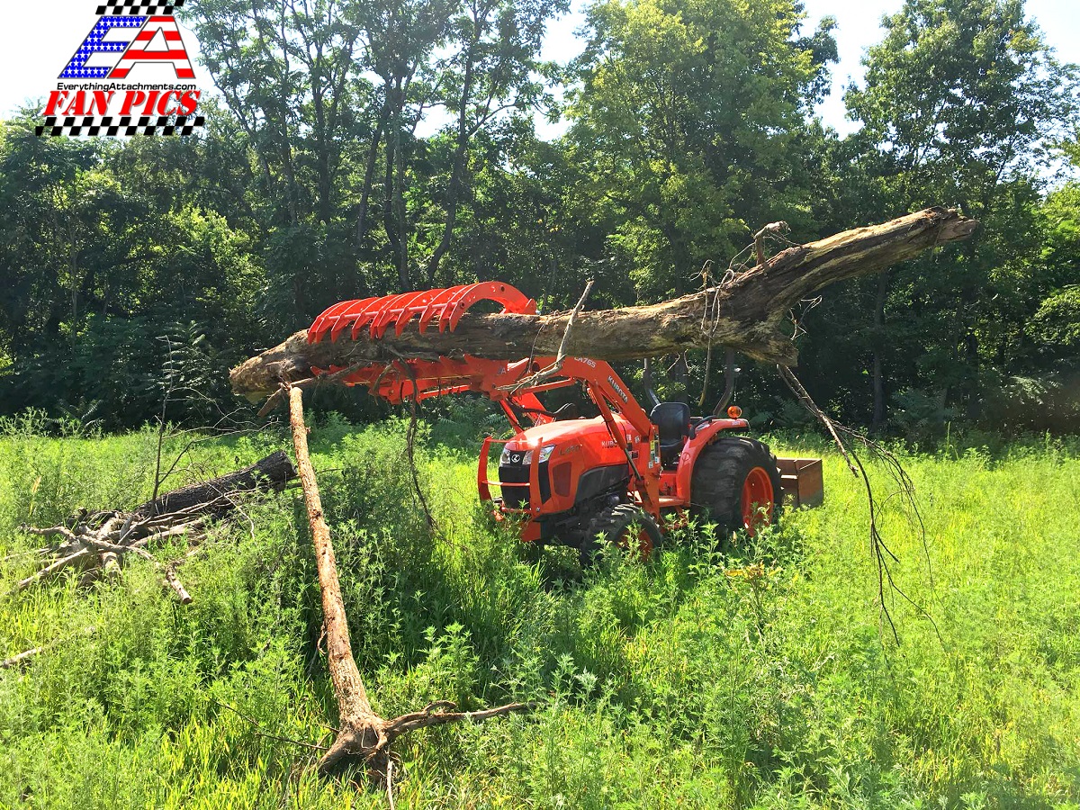

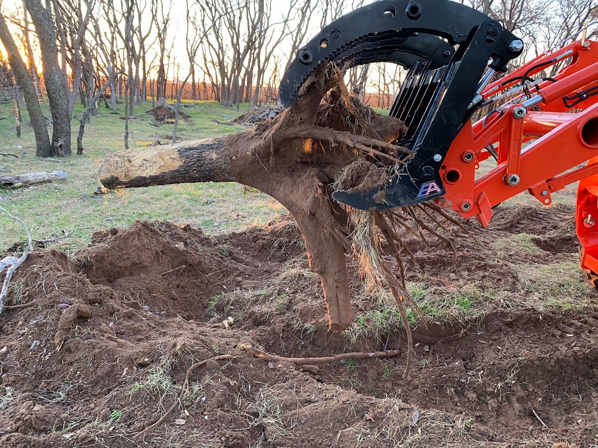

This first part is VERY important, so everyone should pay extremely close attention..

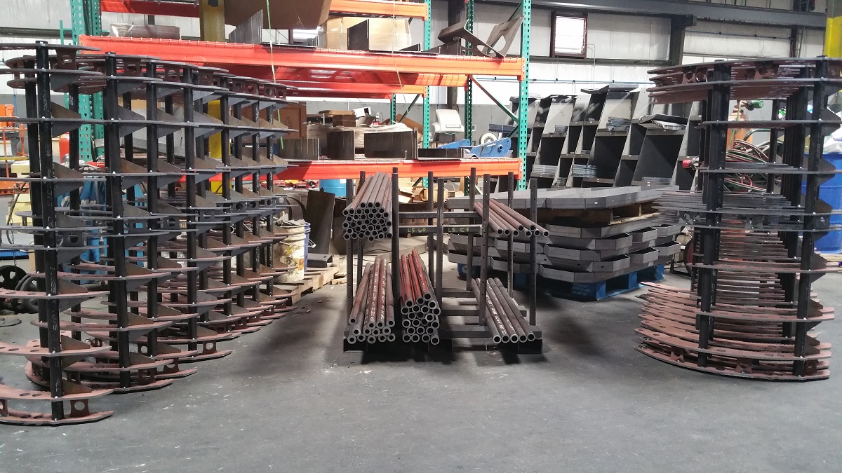

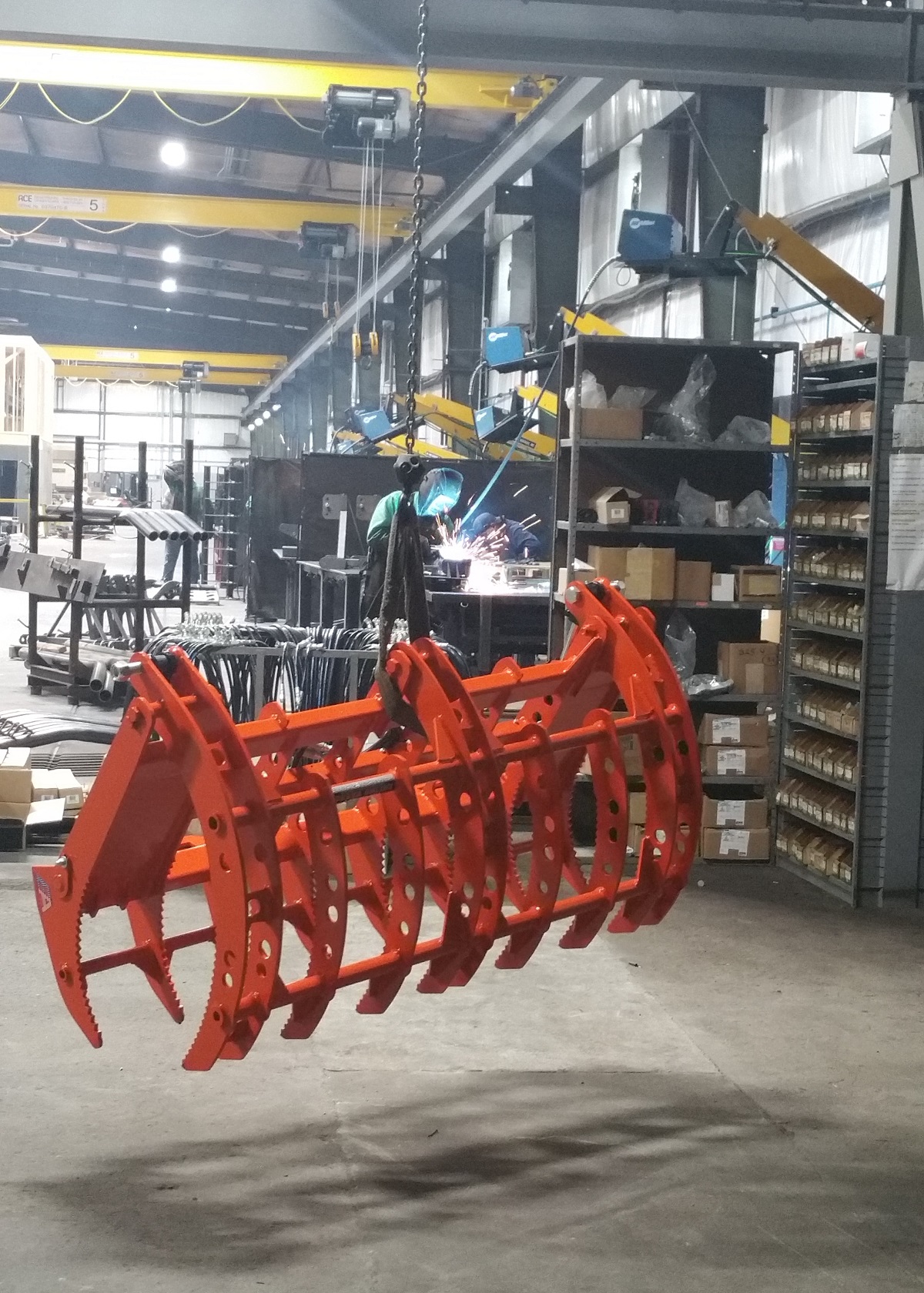

Seriously, our 400 pound, 60" Wicked Root Rake Grapple is the strongest, lightest, most durable and efficient grapple you can possibly choose if you want to squeeze every possible ounce of ability out of your MX. We combine the most premium materials in the industry...
The thickest walled round tubing you'll find on ANY grapple...DOM tubing, that is.
Hardox AR450 wear plate steel. This pic says it all..
The end result is quite stunning..

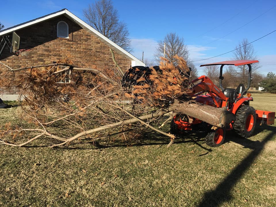

And its functionality is even more impressive. These are ALL MX tractors..
I hope this helps explain why our Wicked is, by far, the best option on the planet for you. Our outstanding customer service will only be icing on the cake!!
Let me know if you have questions.
Travis

Thanks Travis! I did read your private message but I haven't had a chance to respond yet.

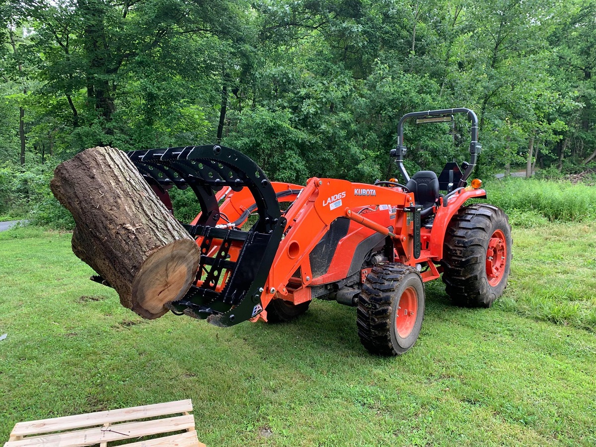

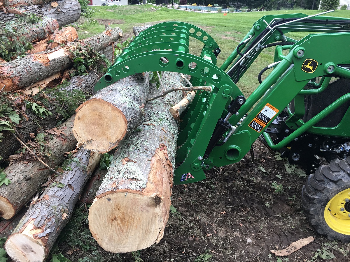

I am wondering if, for my application, do I want longer tines on the bottom? That way I can use them like a pallet fork to get underneath a log when they are piled up?
   / Grapple Overload - MX5800 Needs A Grapple #8

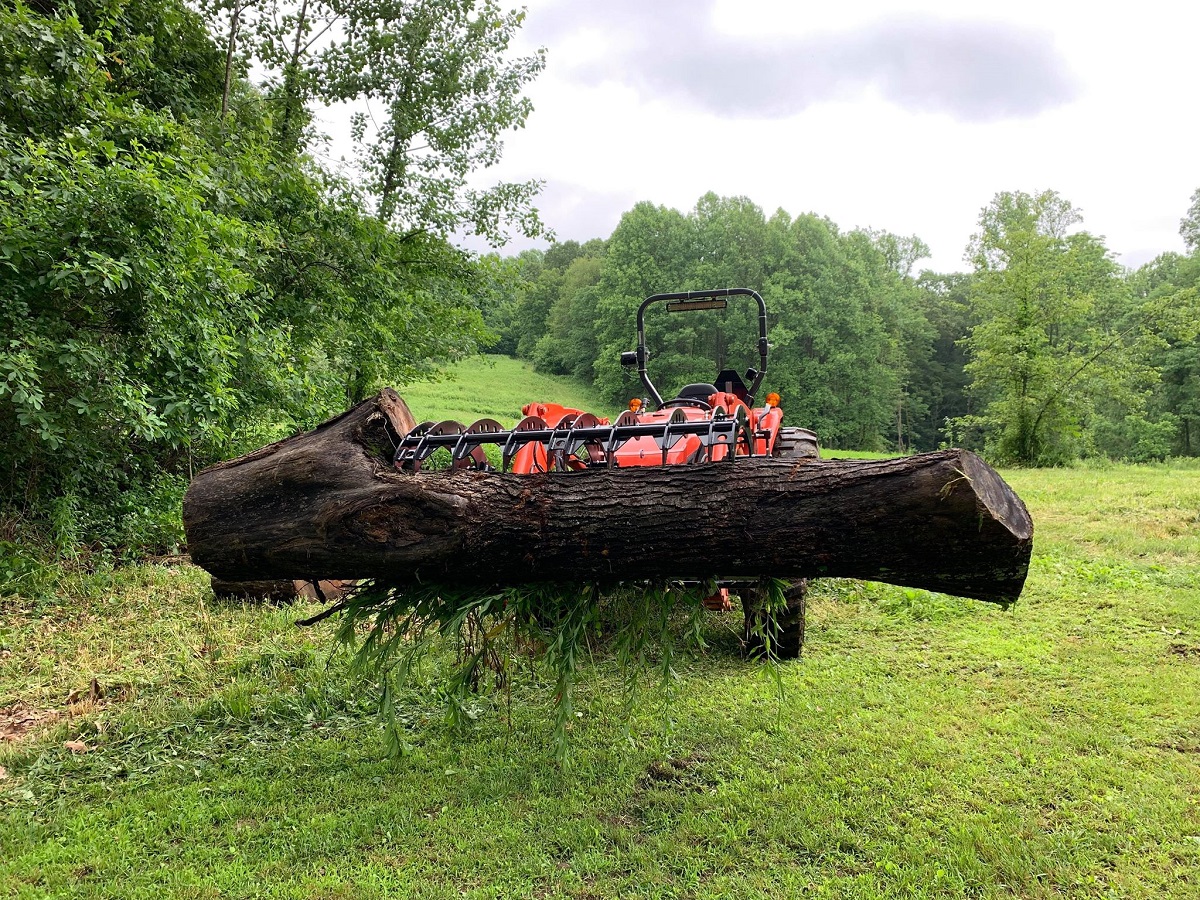

I hate to be biased when it comes to grapples because I do love our original long bottom grapples unconditionally, but I LOVE this Wicked 60 for so many tractors and applications. The feedback and unbelievable pics submitted by customers has boosted my confidence in this thing. You'll be able to clamp smaller logs and brush tighter inside the "mouth" and pick off a single log or multiples if necessary.
I should have some visuals... #looking
Travis

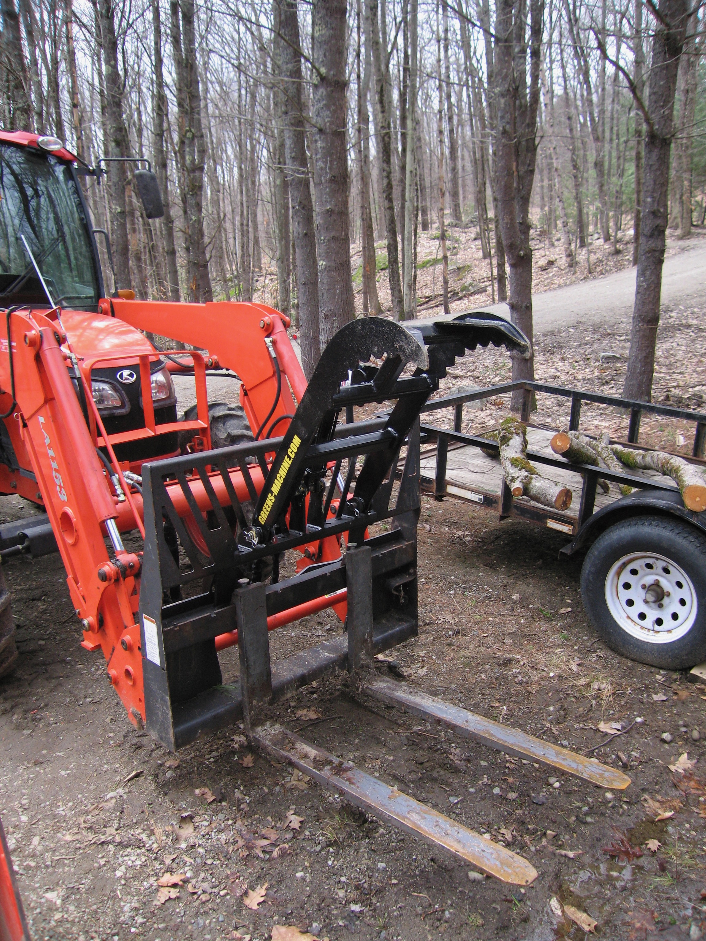

Something I see here all the time is pictures of full cage grapples being used for things that a much less expensive "thumb grapple" would do just as well...sure there are some tasks that might require a full grapple but a majority of the pictures of grapples depicted here on TBN are doing things a simple thumb on a loader bucket would easily accomplish..

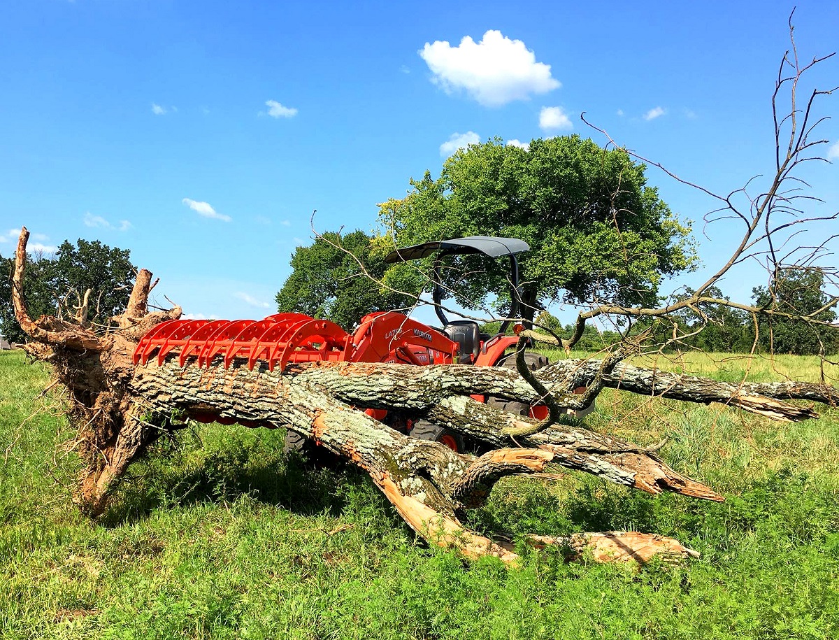

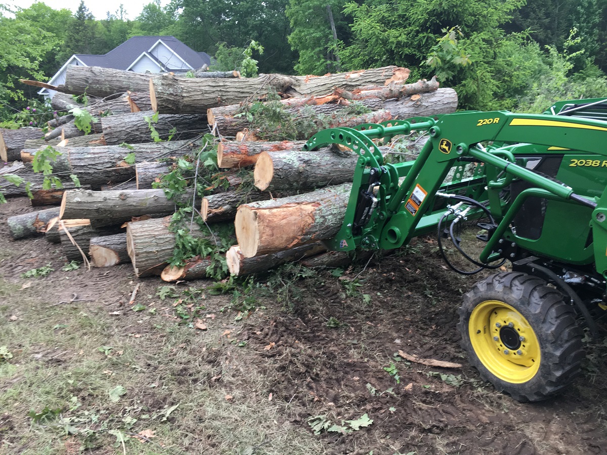

Awkward pieces are no problem..

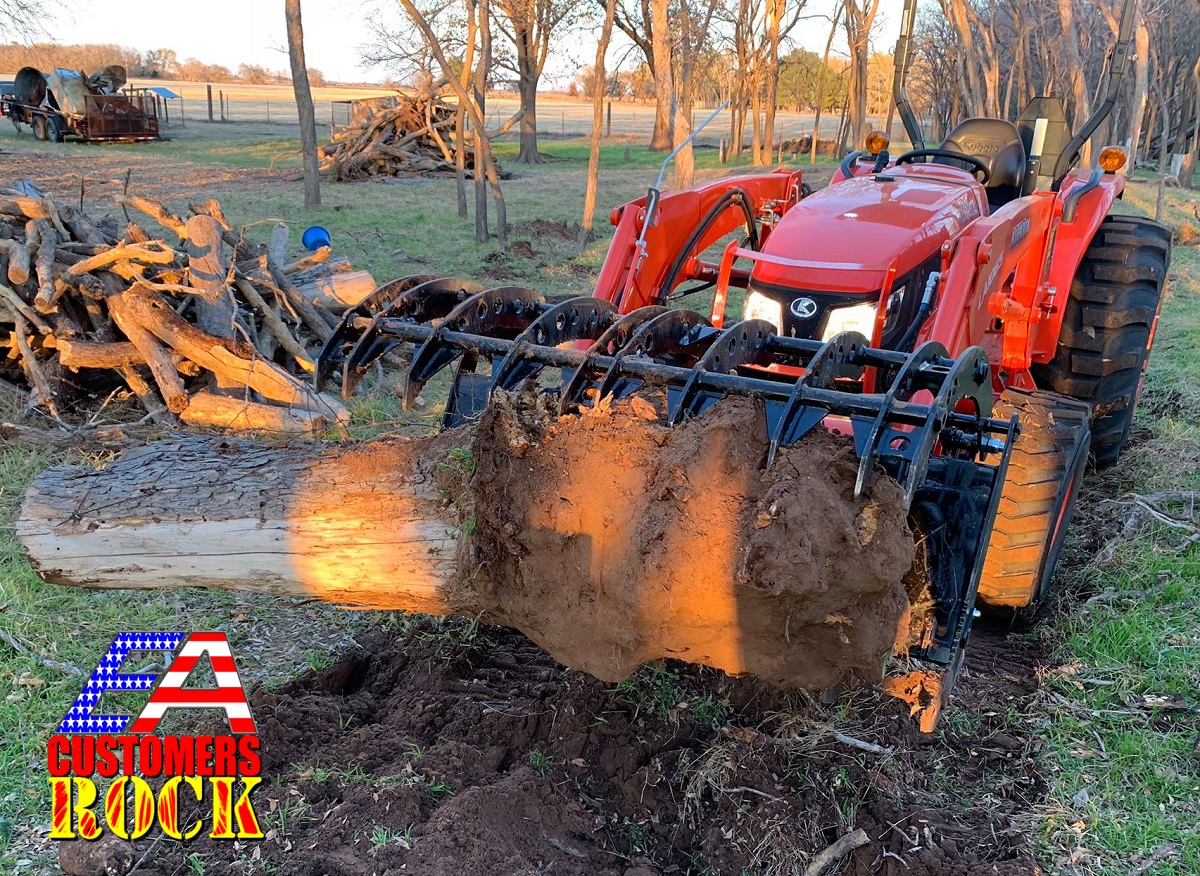

This one shows just how much "cradle" you still have when fully curled, despite the illusion of none, due to the shorter tines!

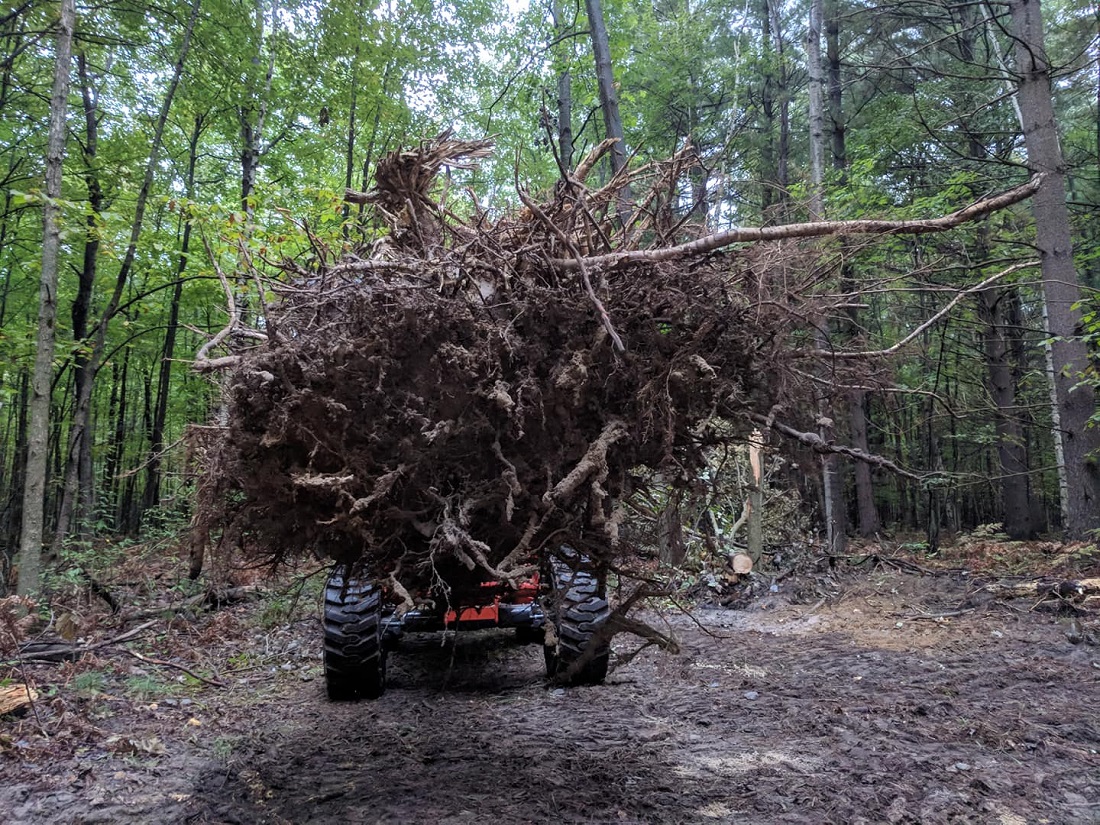

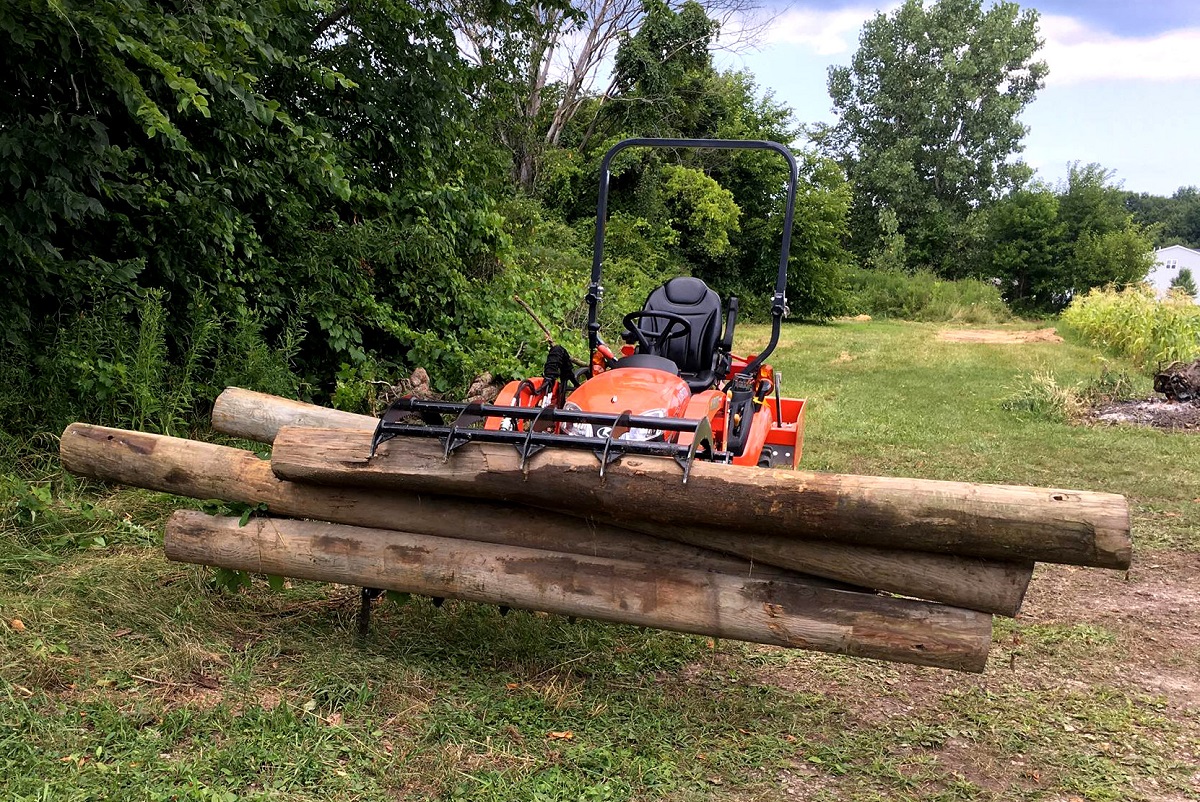

Multiple objects..
Log pile. This is its little bro, the Wicked 55, on a Deere, but Wicked grip is still real. Technically, you can fit more into the mouth of the long bottom, but multiples are still not hard to grab..
And its even smaller bro, the Wicked 48 showing off some real capacity...
