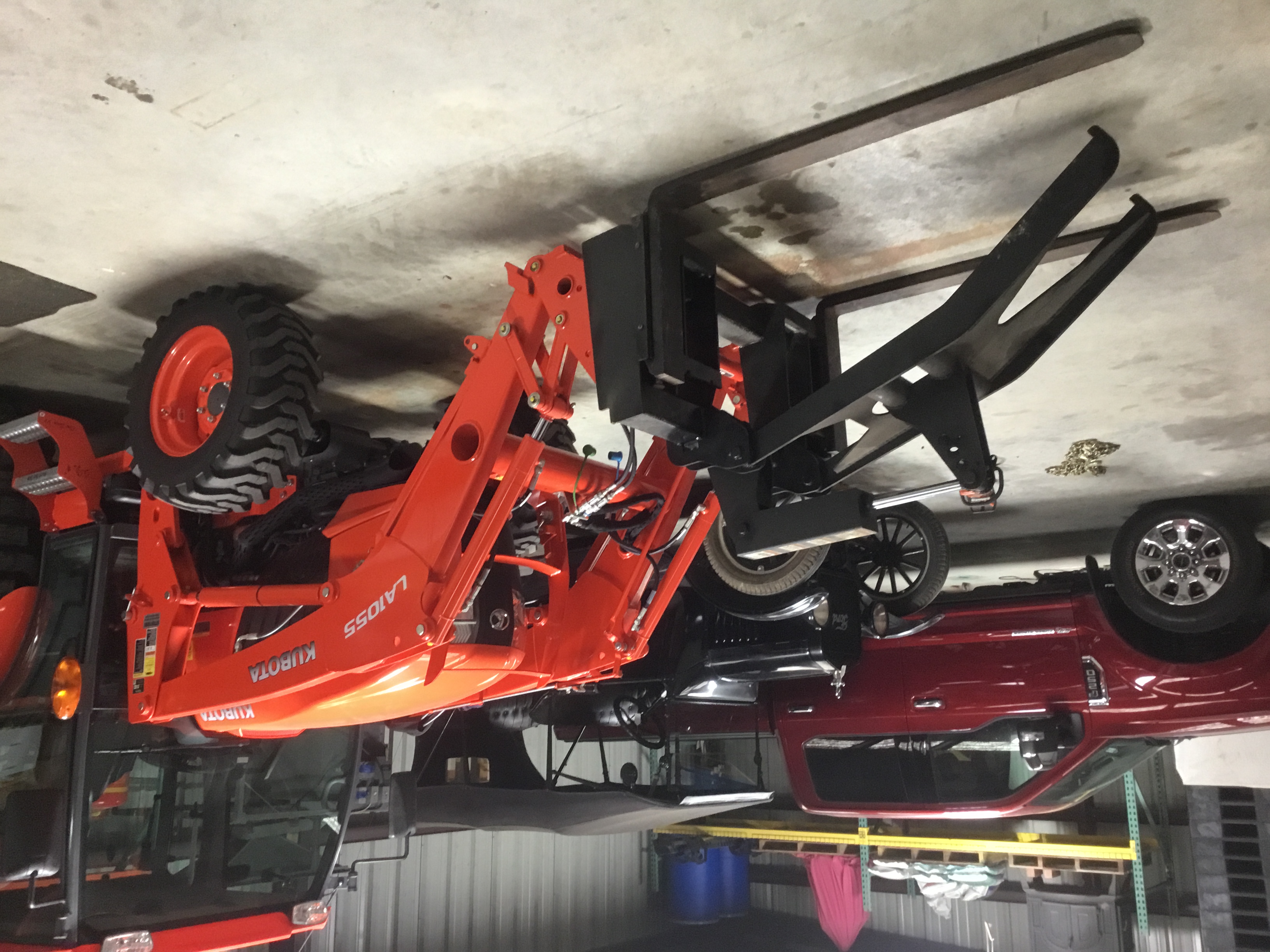

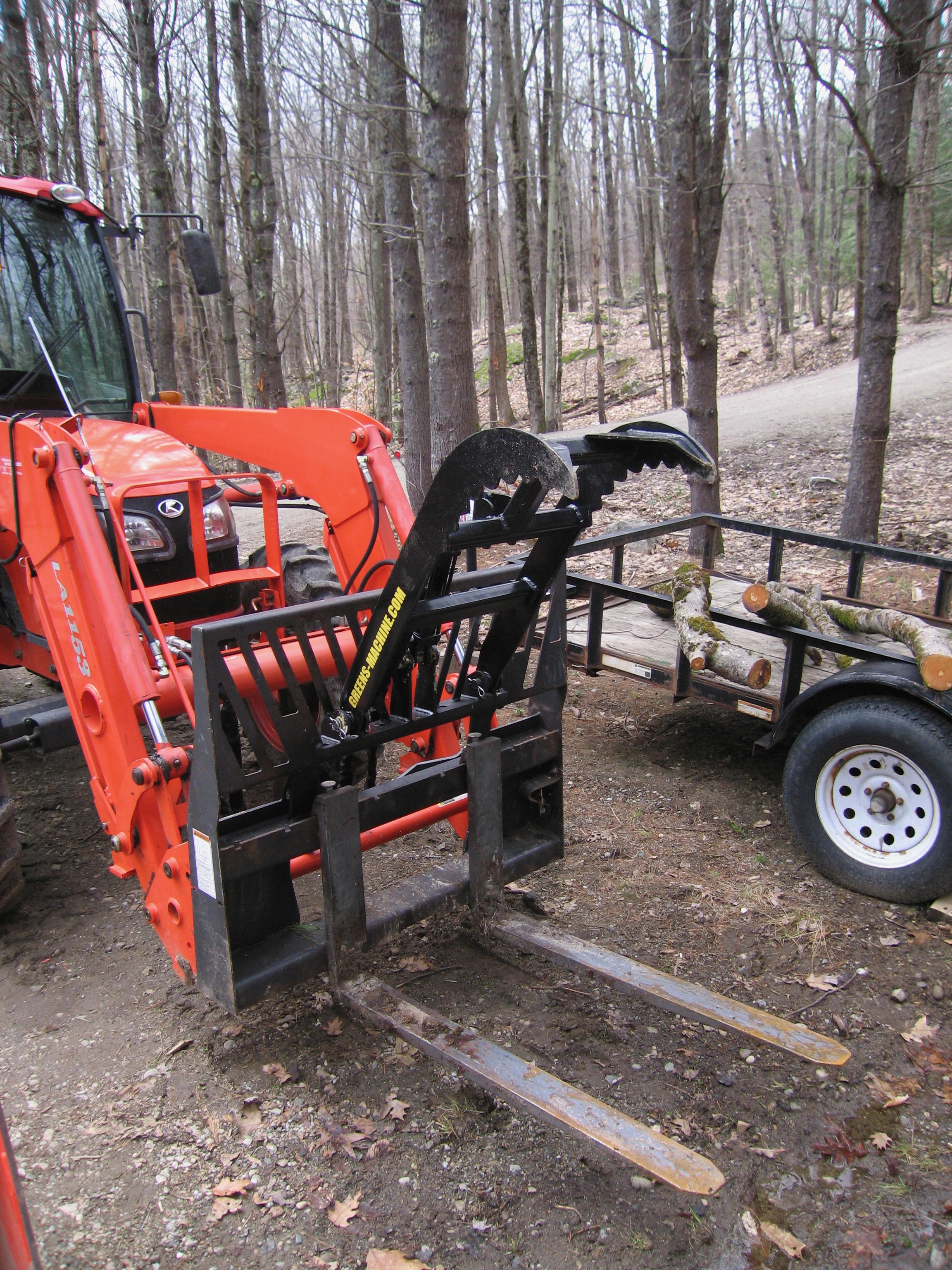

   / Grapple Overload - MX5800 Needs A Grapple #16

#19
I have the Thumb grapple on my forks, very handyView attachment 615273
