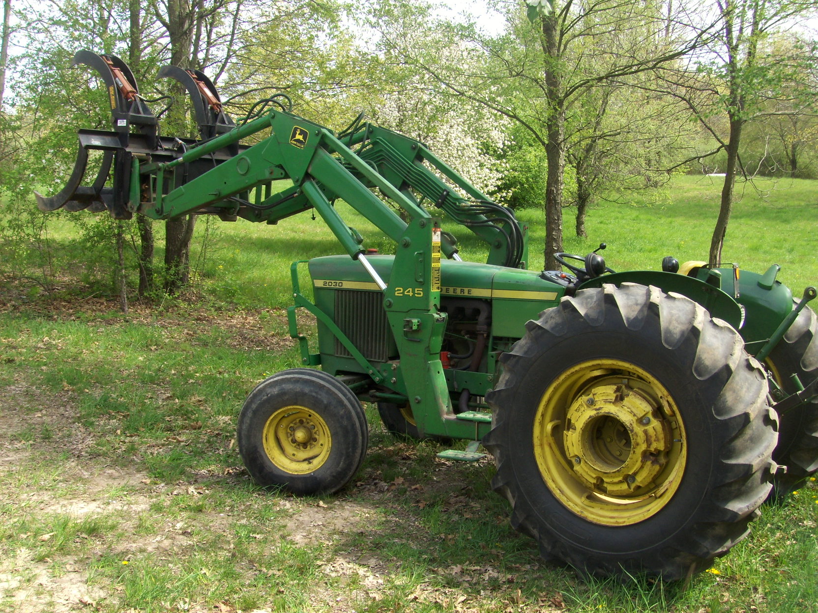

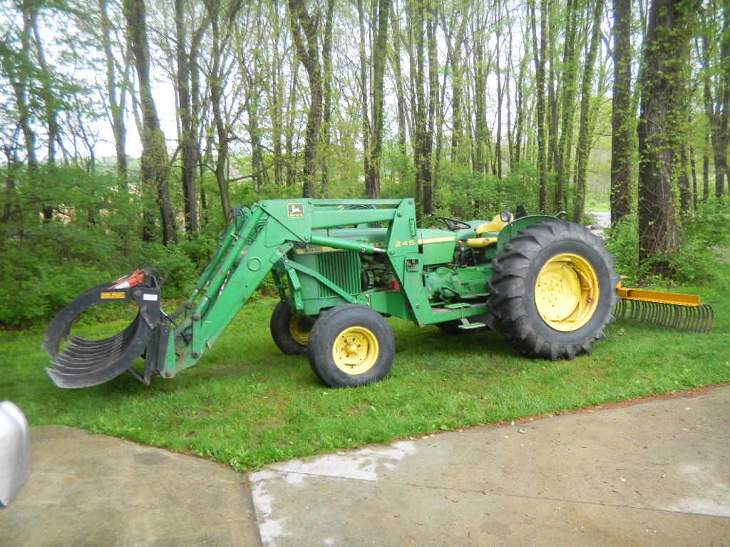

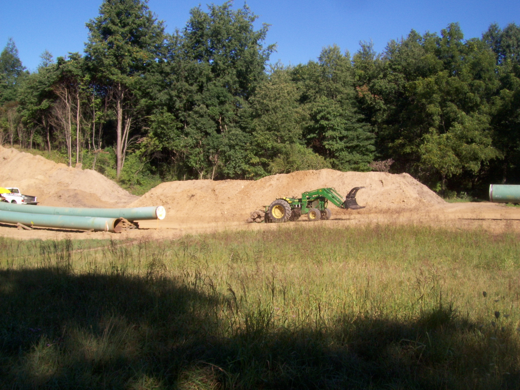

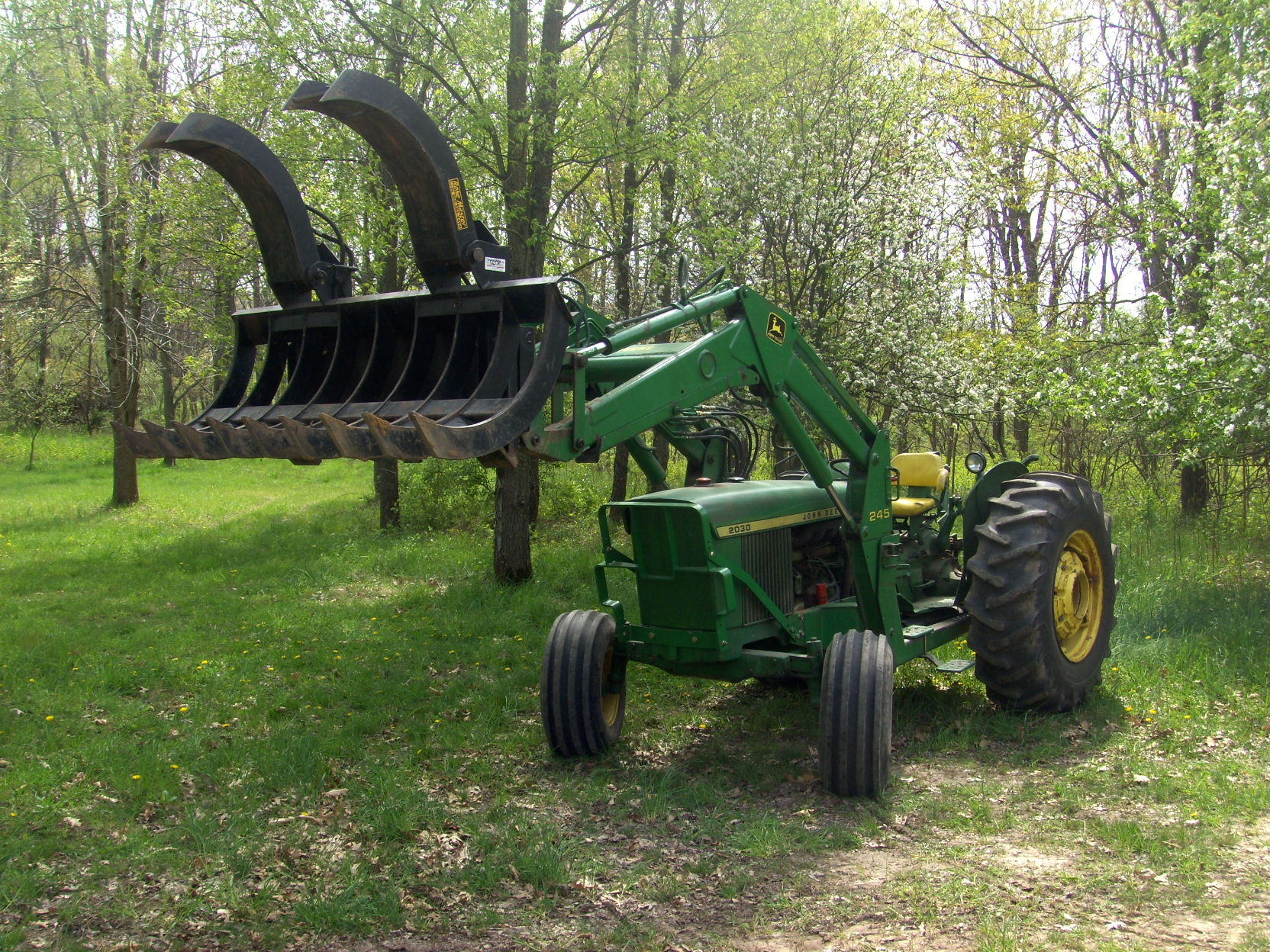

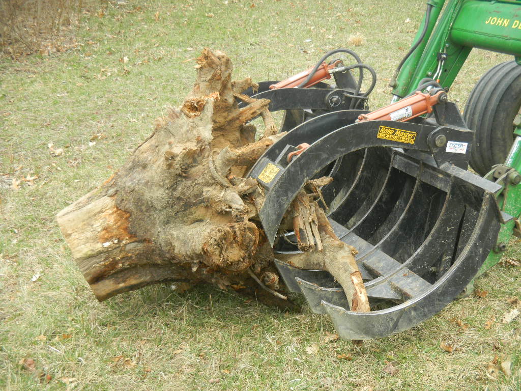

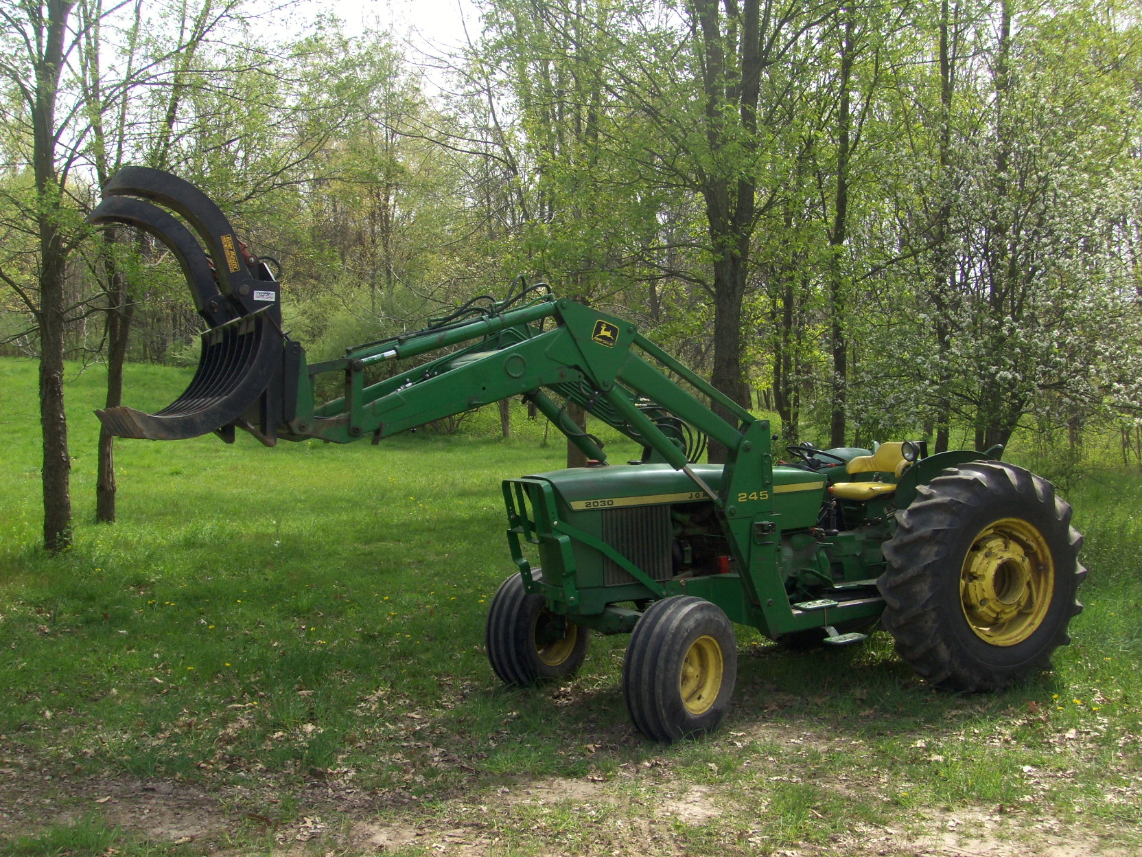

That thing is very well built!!!! Are your cylinders 2x8?? Anxious to see your "C" measurement. Also would like to see a pic with the claws open if you have one. Thanks!!!!
It is well built and heavy! I'll check cylinder size when I get measurements. I don't have many open (I always close when not in use) these are the only ones I could find, plus a few more, I was able to lift and drop stump on my burn pile.
I really like that. Strongly built!!! Measure the open distance if you get a chance. Looks very impressive!!!
