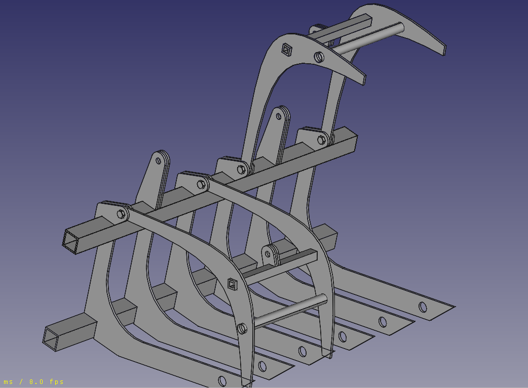

Wow that is long. Getting pins that long in and out might get challenging especially if anything gets tweaked.
   / Grapple project OPEN SOURCE
#132
You are right. I will do the simple approach then, with one pin/bolt for each side instead of one big one. Maybe The lid sides are 18" apart. Screenshot from 2017-11-04 04-03-19.png

Nothing 19" long though. How about to use rod?
Mine uses a rod. One end has large, thick washer welded on the other is cross drilled for lynch pins. Occasionally I would lose a lynch pin (I think brush would unlatch it) so I bought the HD "black" lynch pins from TSC and have not lost any since.
The tube for the claw is drilled in the middle and has grease fitting.

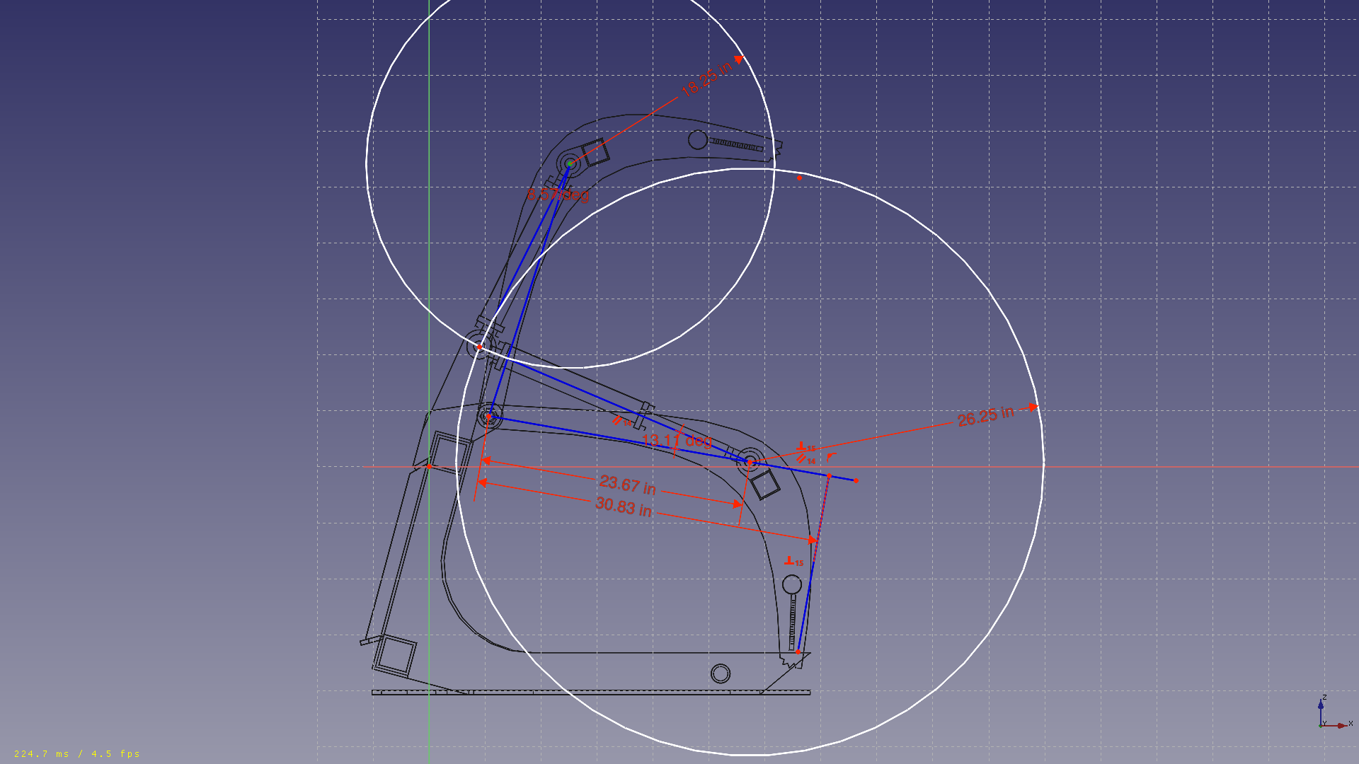

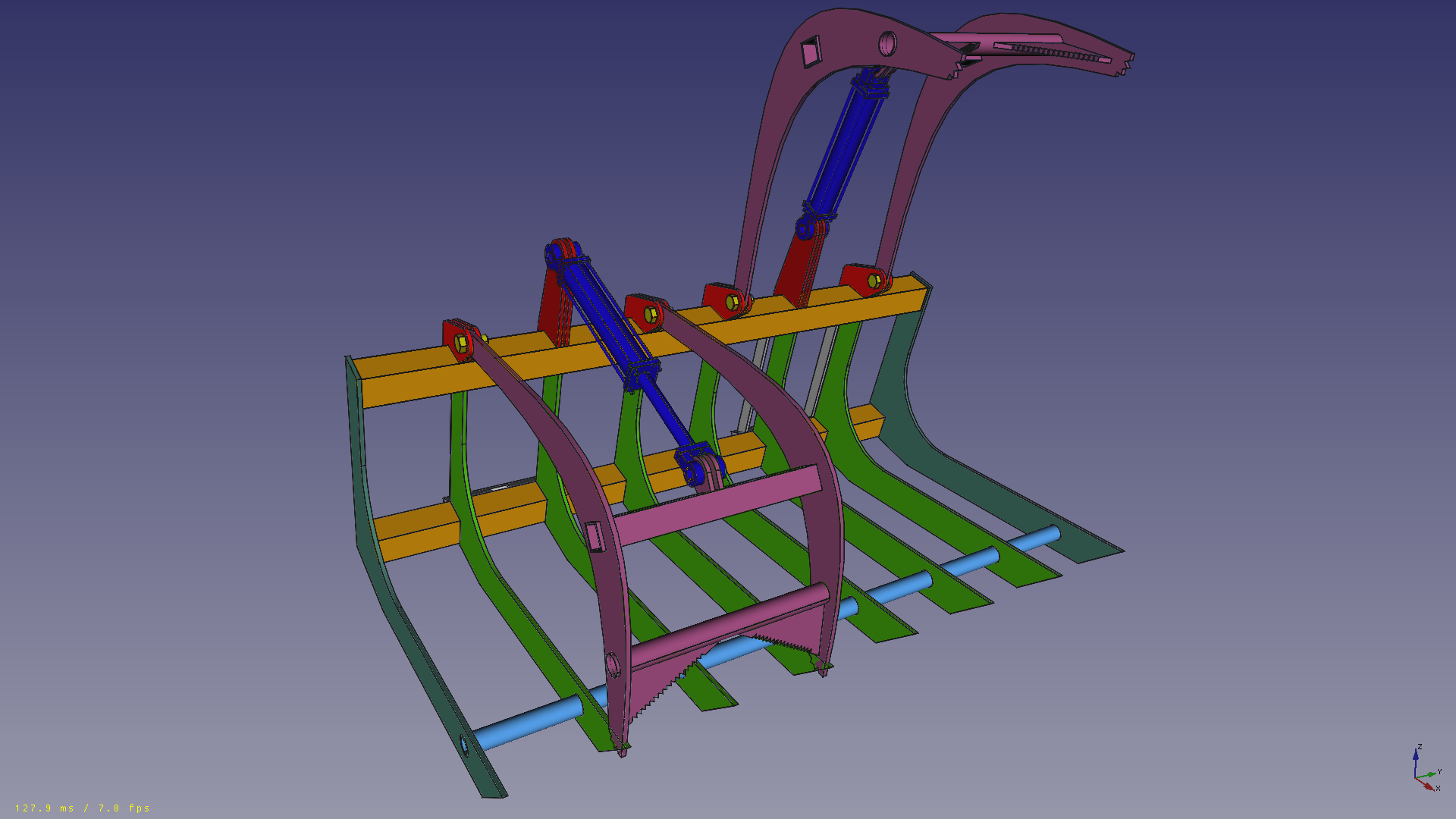

Got you. I am wondering if it makes the lid more stiff, and if that worths the extra weight. Anyway, I just used the simple approach with bolts/ nuts instead of a tube with a greasable pin. If that fails soon or needs too much greasing I will upgrade it with the enclosed pin.
I think the design is almost complete. I just need some bracing on the lid, some expanded metal at the back and some protection below the cylinder. But I am tired, I need a break from CADing. I will start working on the BoM. What I am missing is a easy way to do the nesting for the CNC. Freecad's nesting tool is in development and does not work well yet.
Here is the step file.
Here are the original Freecad files if someone wants to edit them (needs Freecad v0.17)
With these 2.5" cylinders I get 2130lbs at the closed position
or 1360lbs with the 2" cylinders
And thats the geometry. The cylinder at the closed position is not 100% extended, it has a little travel yet thats why the lids look like they are overlaping the tines.
I love the colors! :) :) :) hahaha
I have no opinion on SAE vs NPTF ports. Other than the SAE uses a o-ring that seals easier, but the NPT has more fittings available??? What are the fittings on the 3rd function of a tractor does anyone know plz?, I found similar cylinders with SAE ports I can replace them

Need to gusset the lower tines
Yes, I forgot it, thank you! But vertical or horizontal? Maybe laminate them to make them thicker too?

Another question came up to my mind. What thickness should the tubings be??
The orange square members are 3"
The purple on the lid is 2".
The blu round tubing on the tines.
The purple on the lids
Do you need me to provide some dimensions/blueprint so you have better understanding without having to download the .step file? Any other suggestions/changes? (gusseting the tines is one noted)
