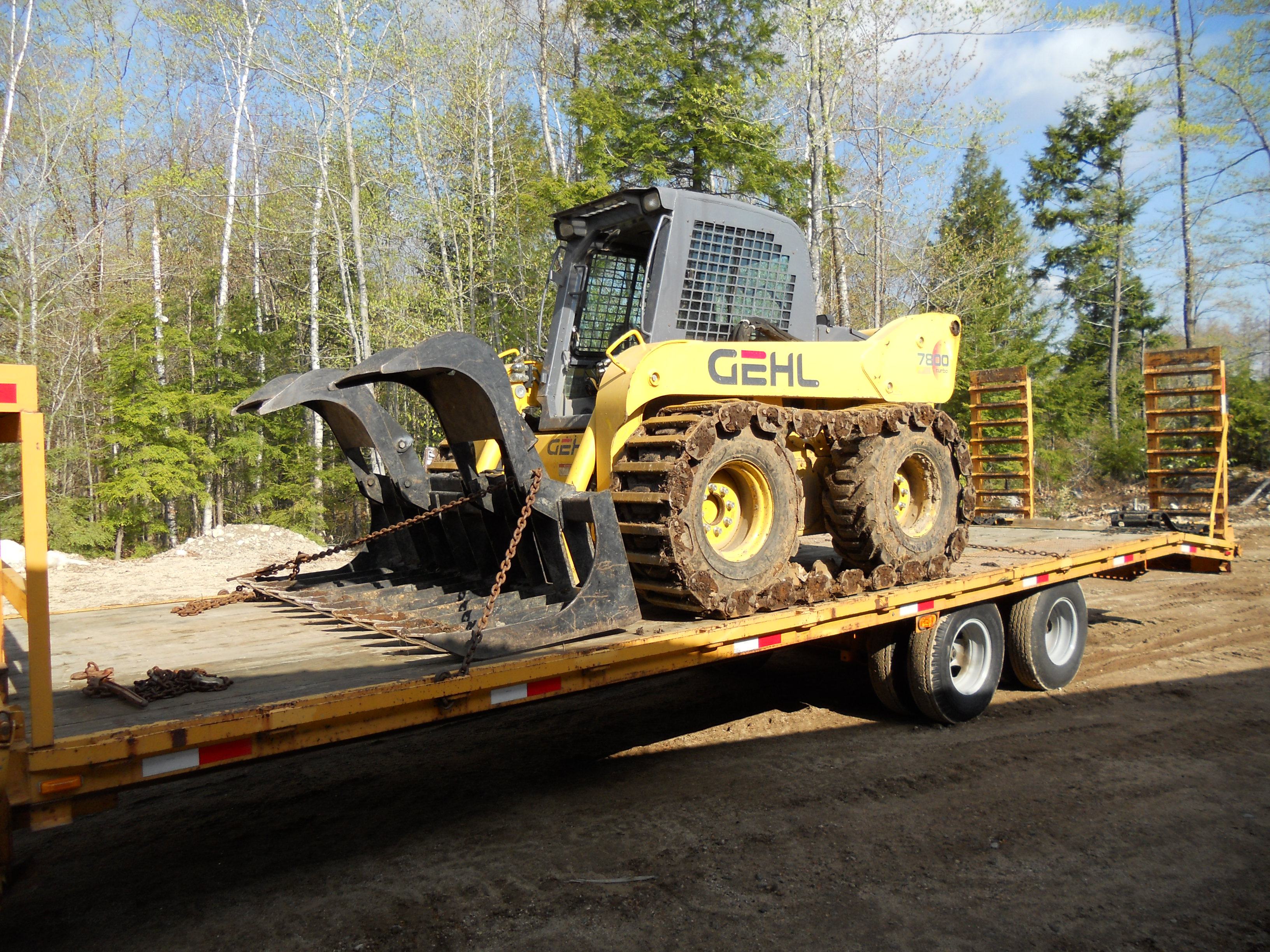

I just joined in late, you math guy's make me wish I had paid more attention in school. polemidis, if you would like to see a 7' grapple that I bought over 15 years ago (Lofflin mfg) that has spent it's life on a 115 hp skid steer w/tracks to observe how a hillbilly can abuse one and the results after all those years, I'm a few hours "down the road" from you. :D
In all seriousness, I have abused it (done things it was not intended for) and I only have "tweeked" one of the lid's a few inches from closing "square". That was pulling logs out from the end and turning. Very good post here and welcome to tbn!
If that's not one of the warnings in every grapple owner's manual, it should be!

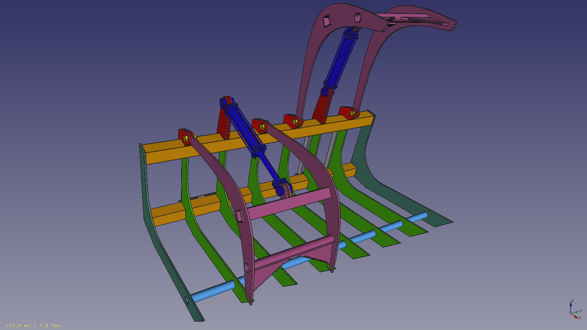

Need to gusset the lower tines
Also needs more bracing in the claws unless heavy high tensile steel is used. Might incorporate a cylinder protector into that part cause it can't be used without one.

Got you. I am wondering if it makes the lid more stiff, and if that worths the extra weight. Anyway, I just used the simple approach with bolts/ nuts instead of a tube with a greasable pin. If that fails soon or needs too much greasing I will upgrade it with the enclosed pin.
I think the design is almost complete. I just need some bracing on the lid, some expanded metal at the back and some protection below the cylinder. But I am tired, I need a break from CADing. I will start working on the BoM. What I am missing is a easy way to do the nesting for the CNC. Freecad's nesting tool is in development and does not work well yet.
Here is the step file.
Here are the original Freecad files if someone wants to edit them (needs Freecad v0.17)

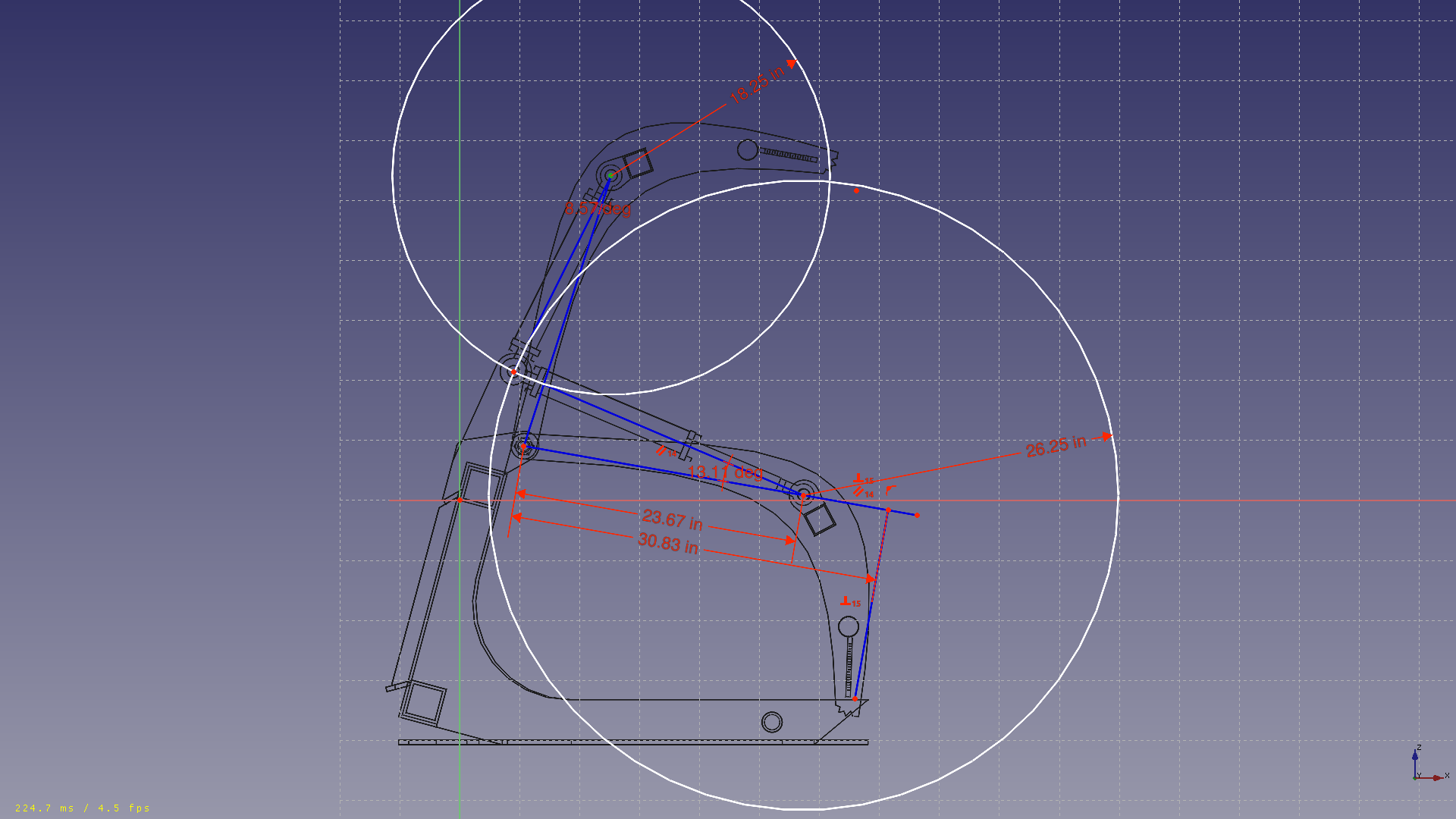

With these 2.5" cylinders I get 2130lbs at the closed position
or 1360lbs with the 2" cylinders
And thats the geometry. The cylinder at the closed position is not 100% extended, it has a little travel yet thats why the lids look like they are overlaping the tines.

Did you consider placing the cylinder(s) behind the bucket? Your clamp would pivot at the top of the bucket, with some extra length sticking out the back for a lever that the rod actuates. It solves the angle problem by pushing nearly perpendicular to the lever arm at full clamped position.

But you'd have a heck of a lever disadvantage. So unlikely you would gain much in the long run if anything

Not really. Maybe I explained it poorly. Google "clamshell loader bucket" for pictures. Compact design, cylinders are protected, and plenty of clamping force. It also avoids the large lever arm going up above the back portion, which is usually the part that gets torn off on large farm equipment that is working round bales.

Any chance you can get some FEA on it? That will tell you exactly where you need to add gussets
