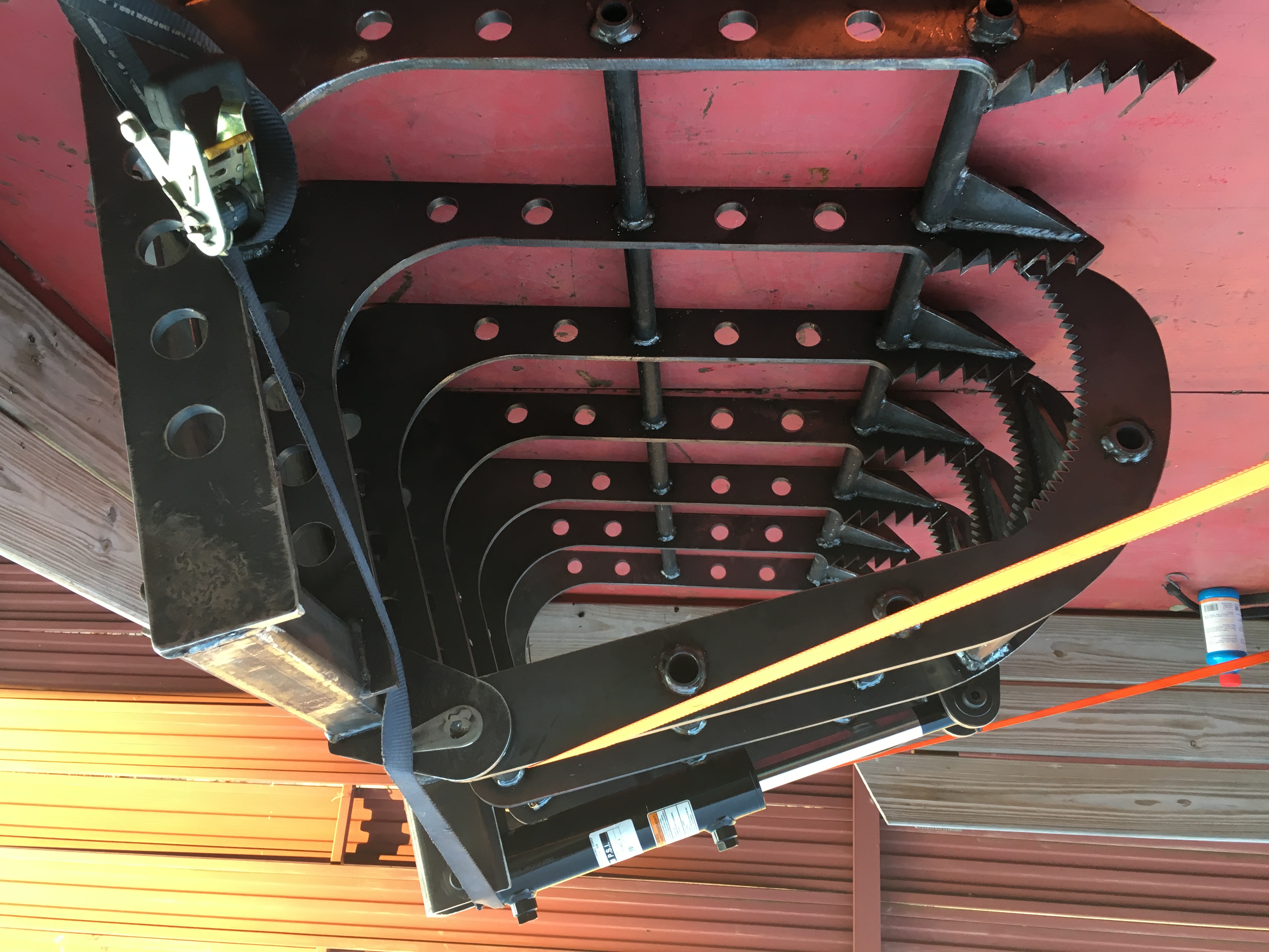

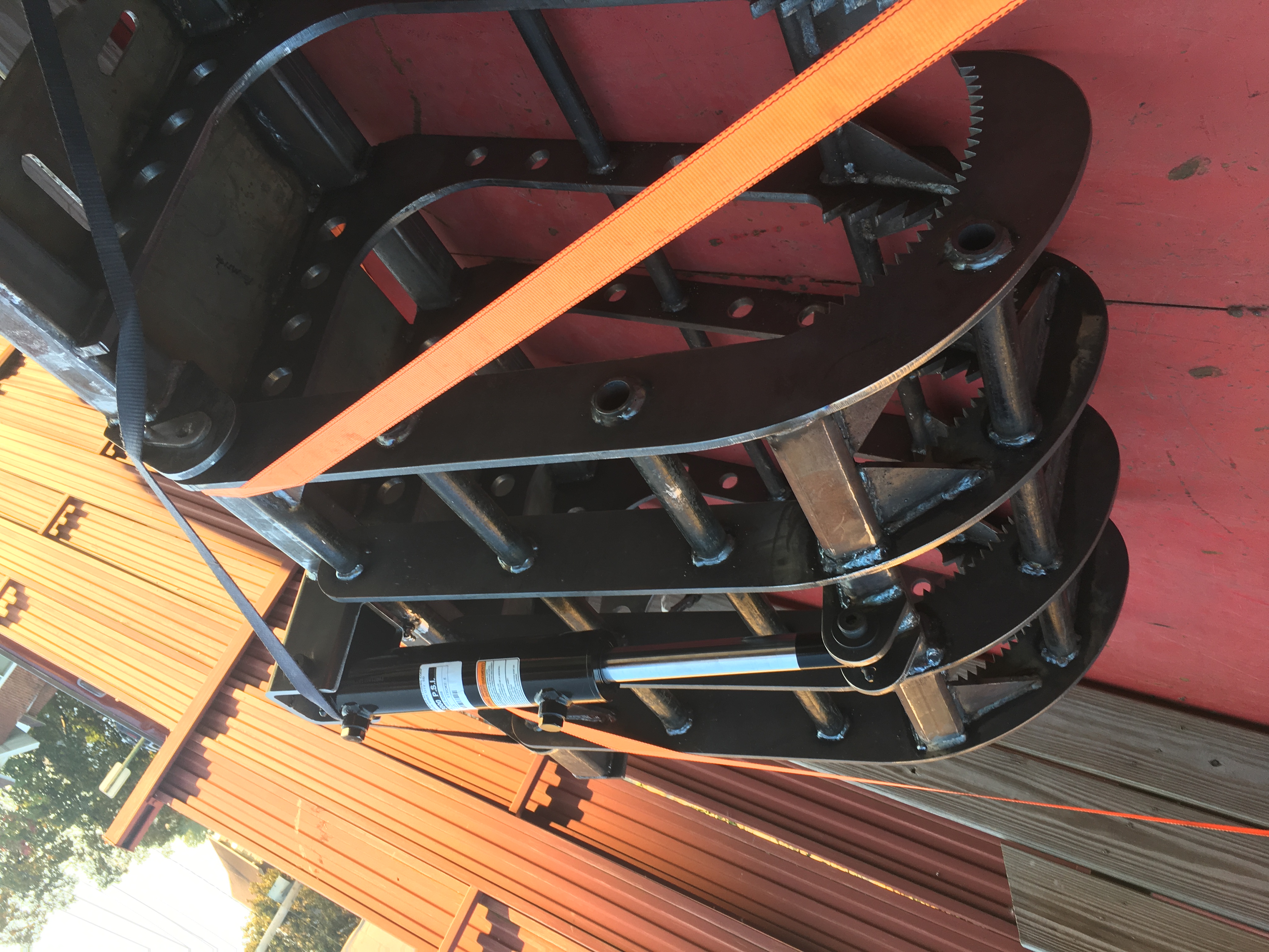

Well it's done and loaded in my truck. My front remote is not done yet so taking it to a friends place to test it out. Hopefully next photo will be with something clamped up in it! IMG_1303.JPGIMG_1305.JPG
/ Grapple project #16

Davidj1 thanks. I should clarify that the plasma cutting was done at a friend's shop. Not for free since he is in business doing both fabrication and machining. I'm sure I got the friends and family discount �� But regardless on a project like this where you have to make several pieces more or less the same, I would highly recommend having them either plasma cut or water jet cut. It makes the fit up and assembly so much easier. Plus once you create the drawings it would be easier to make another one if you ever wanted one. After I try it out I'll clean it up and paint it. I'd also like to get a weight on it so I'll run it over the scale at the gravel pit. Wish me luck on the shakedown��

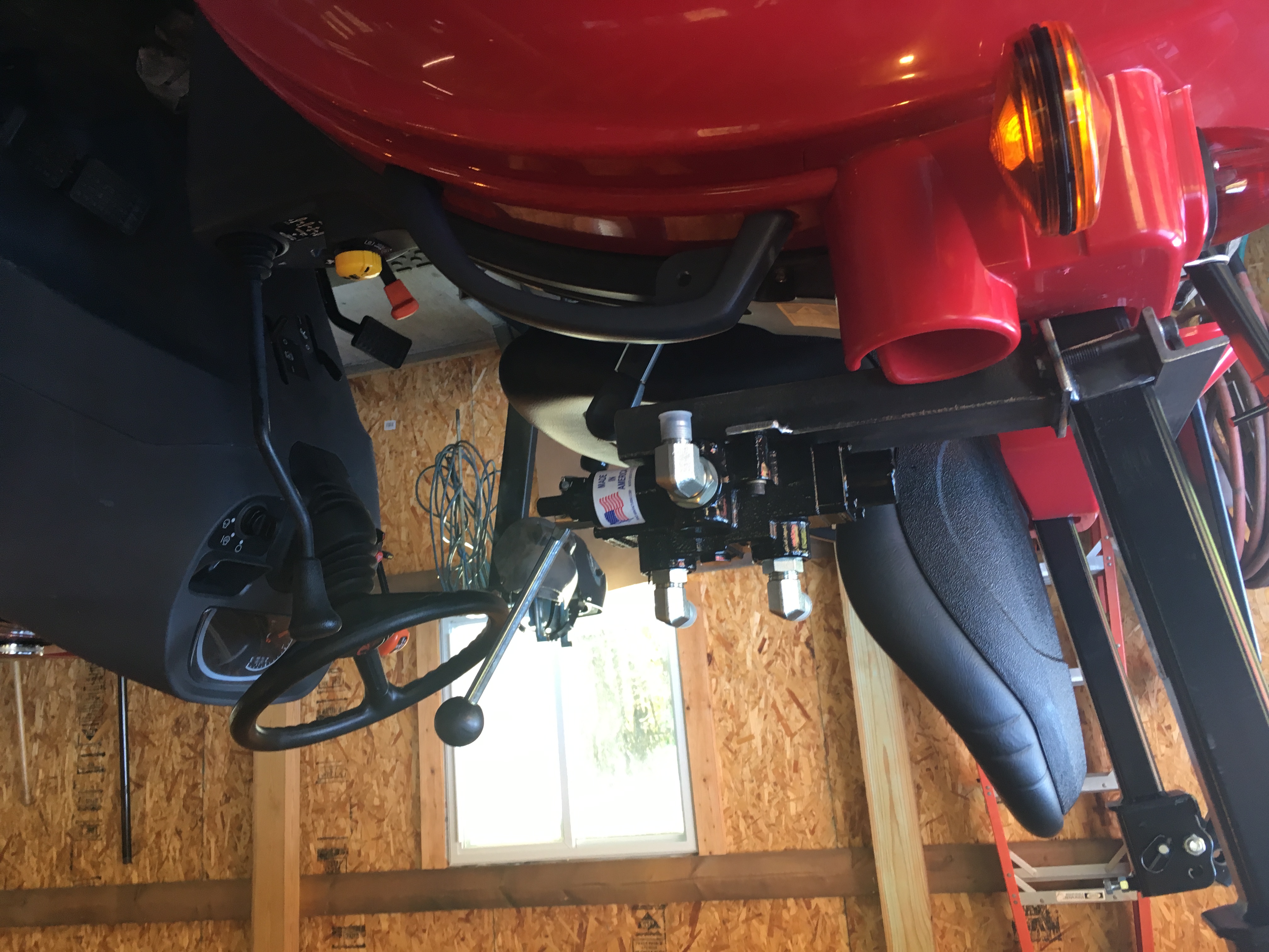

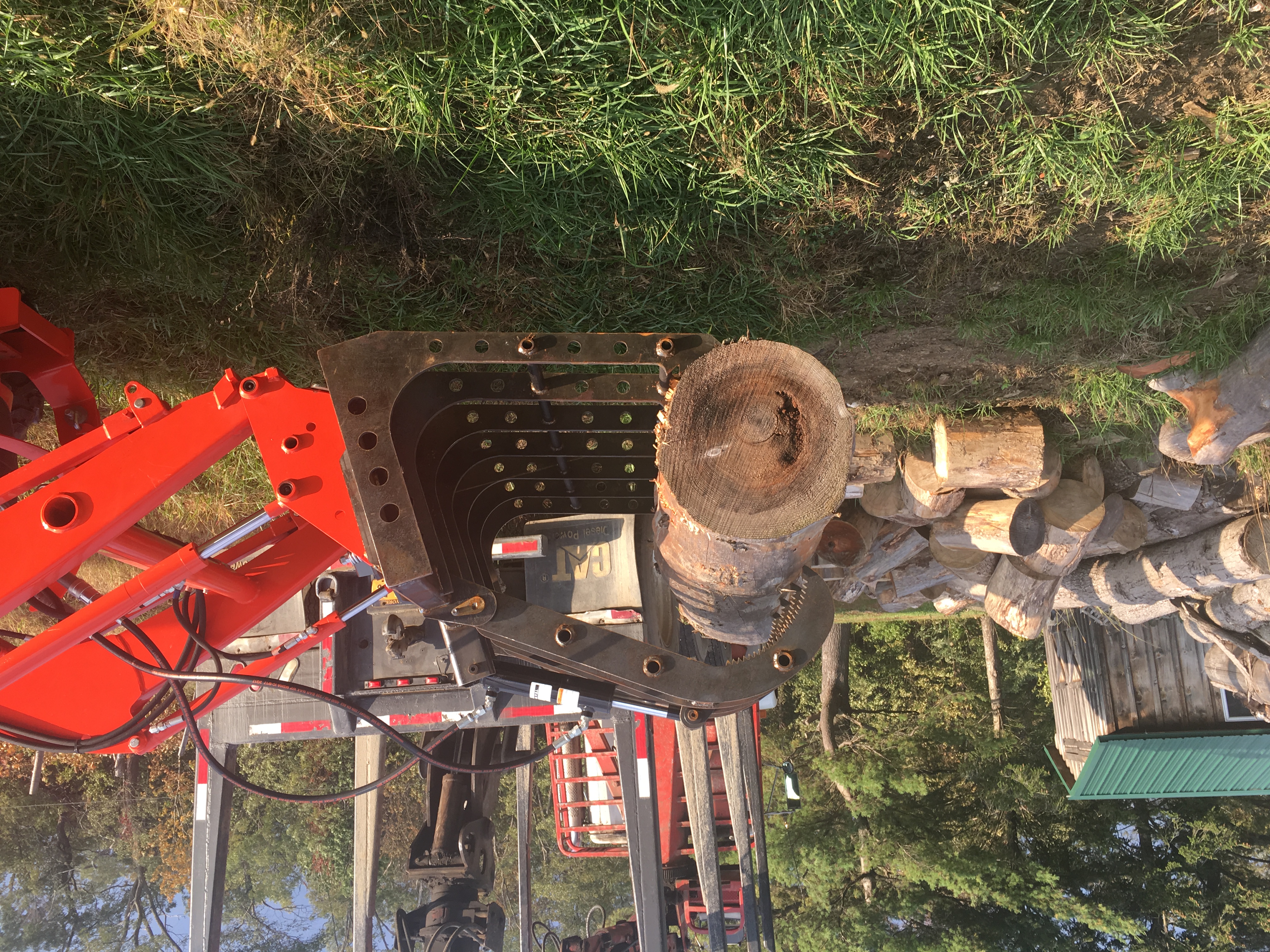

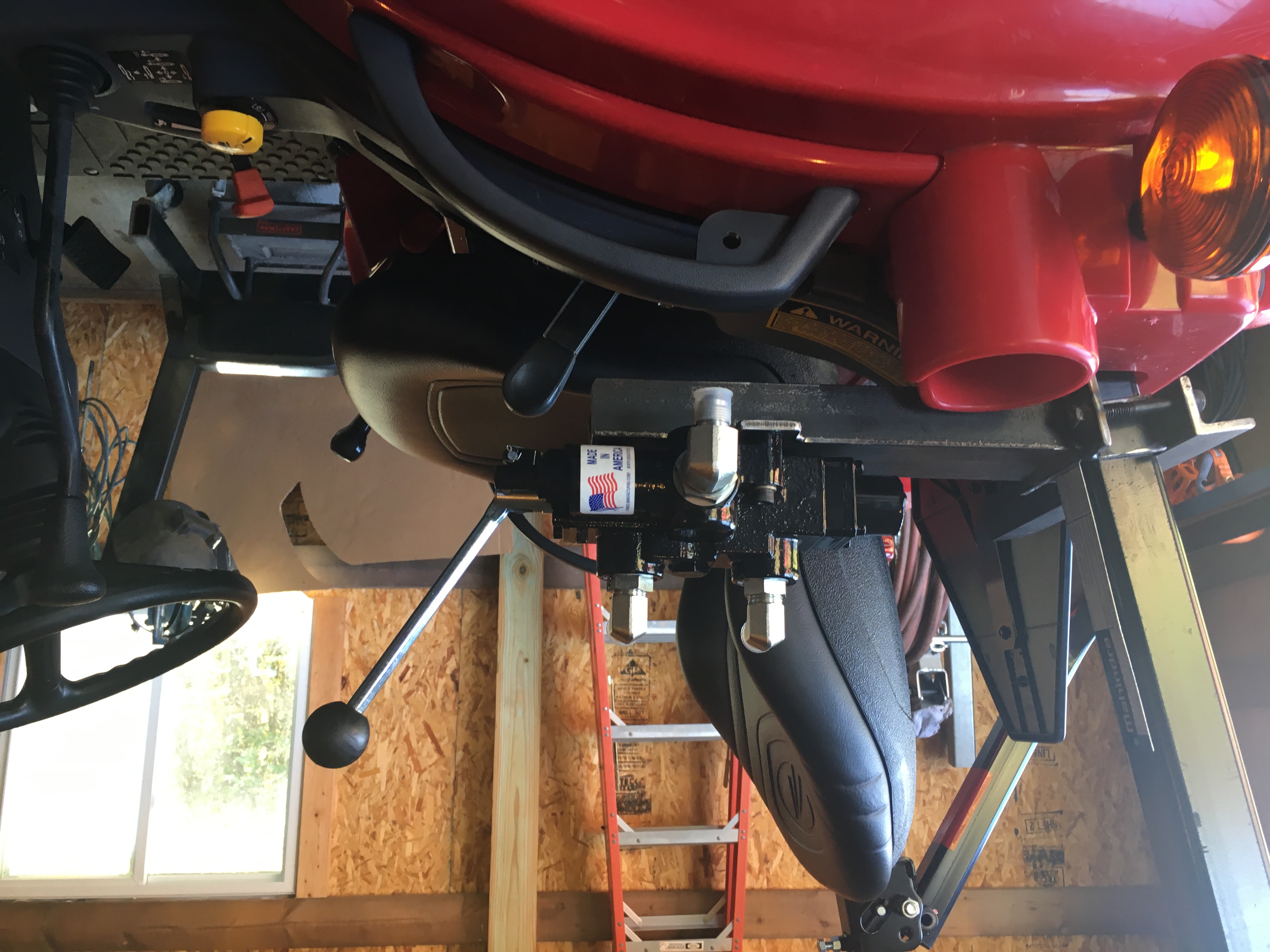

Well I finally got to test it! Worked well picking up logs and firewood chunks. I don't have the hydraulics done on my tractor yet so I hooked it to my buddy's Kubota. I'm working on getting my remote hooked up. Attached pic of the bracket I fabbed up and the valve placement. Now I just have to plumb everything up. Need to stop at the dealer to make sure I have the connections properly identified on the tractor.
