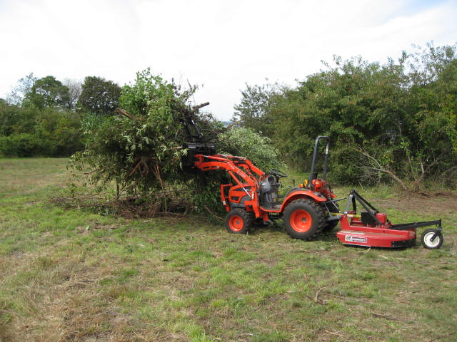

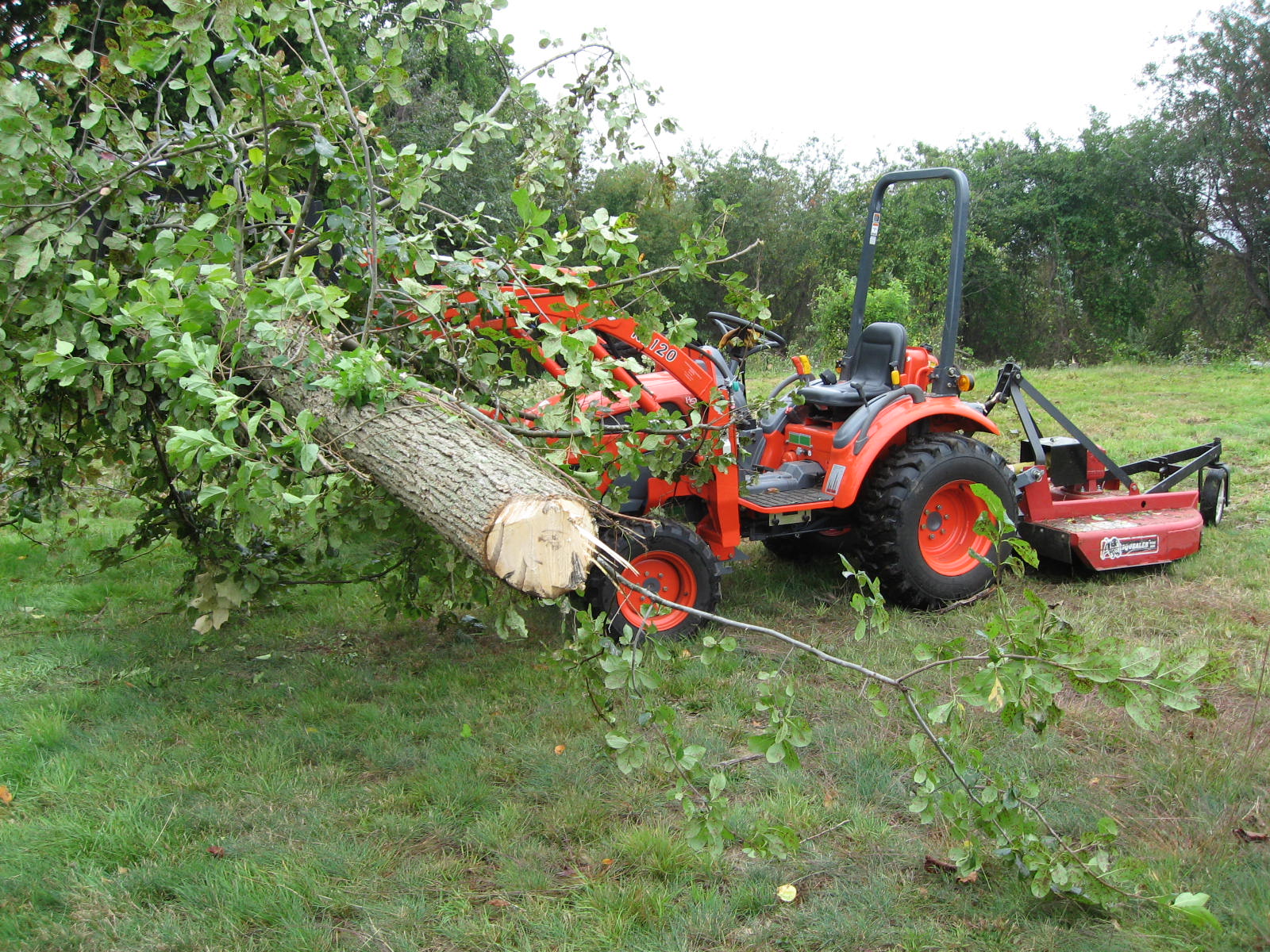

You don't need their "heavy duty" grapple. Their light weight grapples are more than up to any task of brush removal and similar work. If you are using it for construction demo on commercial projects you might need the heavy duty version but for agricultural use the "light duty" grapple has been more than adequate for me. Also, while a larger loader can certainly have a bigger grapple, you can grapple a huge amount into the 48 inch Millonzi. I've posted a number of photos showing anything from whole trees to yards of brambles crushed into the grapple.

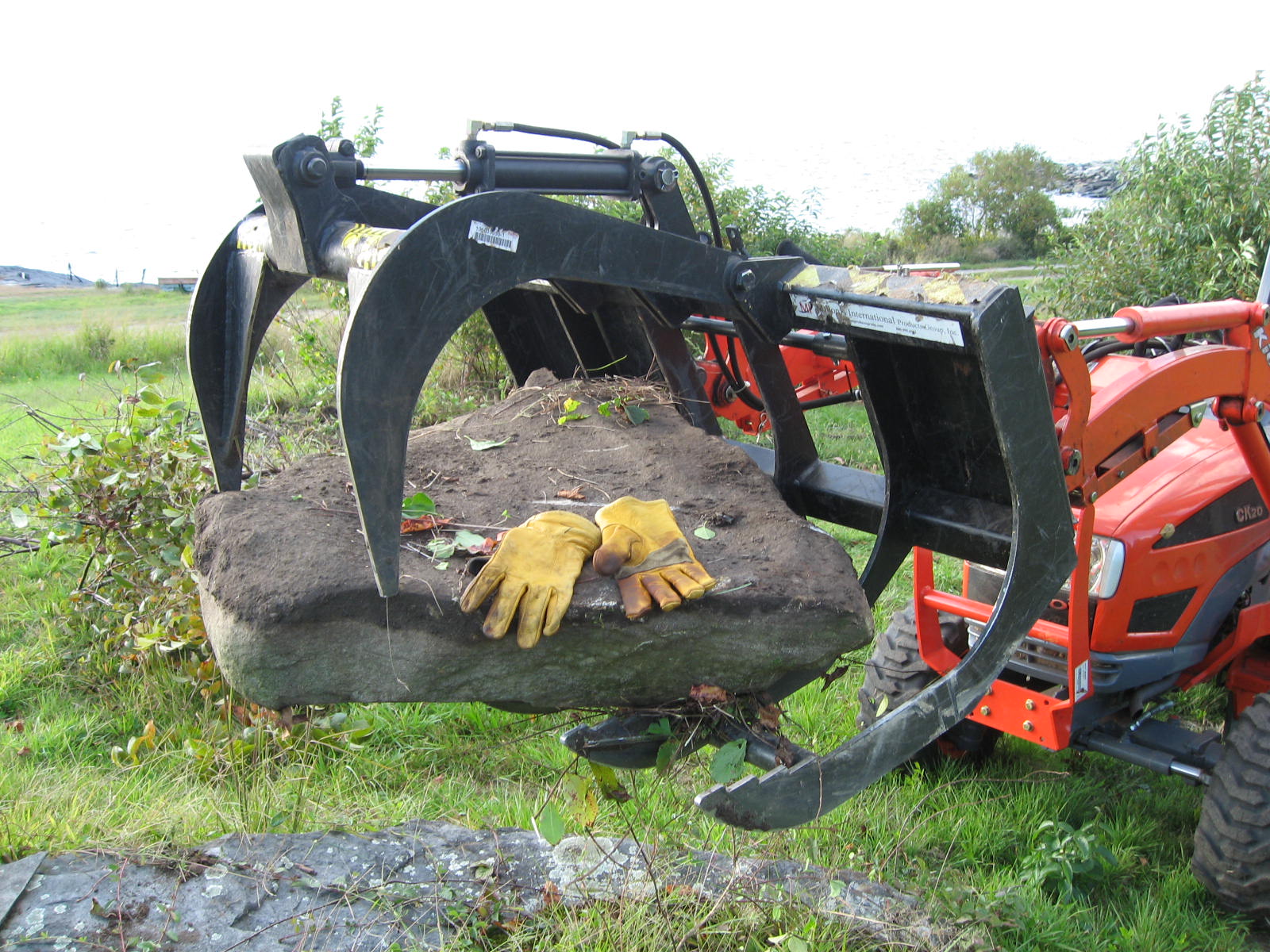

Island...how well does the Millonzi work on the rocks like you have pictured? Will it hold up to moving allot of those?

Well it did not have any trouble with the few that I have picked up. I am not primarily moving rocks so I only pick the buggers up if I need to move them to get at brush. I would say that if rocks the size of the one I photographed are your main quarry then perhaps a heavy duty grapple is warranted but if you are picking up smaller rocks or large ones less frequently then the "light duty root grapple" would be fine.
