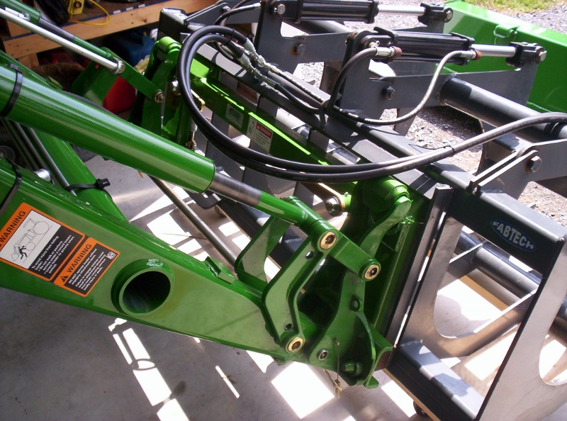

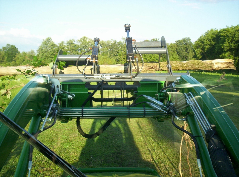

I'm also researching a future grapple purchase, what's everyone's opinions on versetech? I have to agree with with the comments that you shouldn't typically need the ultra heavy duty 3K grapple....
I have the Fabtech/Versatech also (same thing). So far so good, and for $1000/new I didn't think I could go wrong. You can spend as much as you want on these things.
It weighs Exactally 500lbs and is 66" wide, 3/8" steel .
