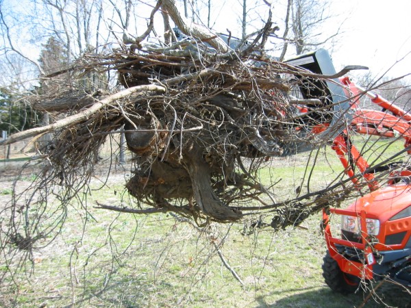

Thanks. I'll check it out. My loader lift capacity is 1,150 lbs so I just hate to use up 450 of that just lifting the attachment. Maybe I need to do more thinking about what I will actually be lifting. 600 - 700 lbs may be more than enough. Probably the heaviest thing I would lift would be 10' logs of pine and spruce. I wonder if there is a table somewhere listing the weight per cubic foot of various softwoods.
   / Grapple research and tentative conclusion what may be best for me; what do YOU think? #50

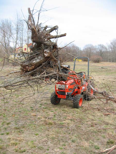

My first tractor was a Kioti CK20 (see my avatar photo) and it handled a 300lb grapple beautifully. 1150lbs of lift is plenty even for a 350lb grapple and will leave you with enough capacity for as much brush as you can possibly cram into the grapple. Big logs and rocks are another matter but those things can overwhelm any tractor/grapple combo. I was able to lift and move logs/trees that were way too big to move without heavy rear ballast like a bush hog or BH even though I had loaded tires.
