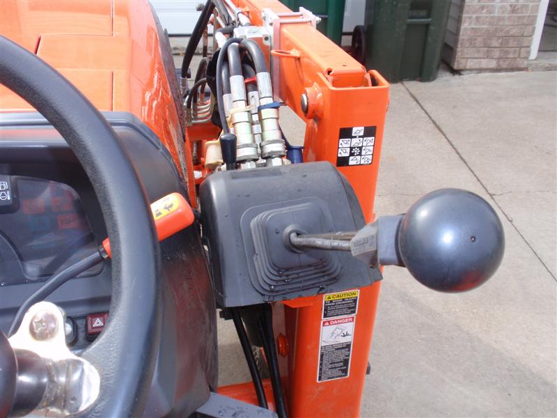

My grapple is powered by the JD 3rd function SVC control lever...just to the right of the Joystick on my tractor. I'm very happy with this set up.

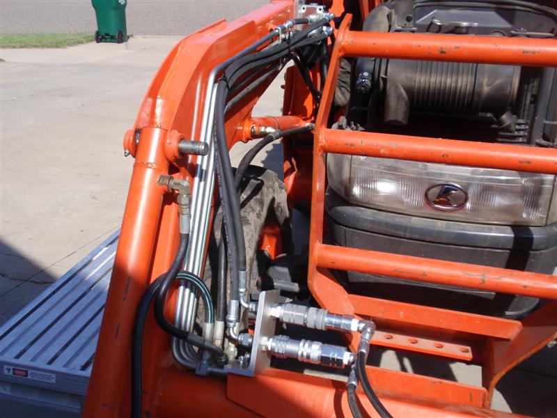

Mine showed up mid last week. I spent Mon & Tues this week getting it installed and working. I got a diverter valve and switch from Fasse. They were very helpful. I got the hydraulic lines and fittings locally from another great shop A1 Hydraulics in St Paul, MN. Also very helpful. I ran hoses instead of hard lines in the interest of time. Maybe someday I'll re-plumb it (yeah, right...). So $1128 for the grapple including shipping and the extra tines. They should almost be standard - or least some info on the option on the website as I wouldn't have even thought about the extra tine option if I hadn't read it here. And then about $350 for the Fasse stuff and another $350 for lines and fittings and stuff.

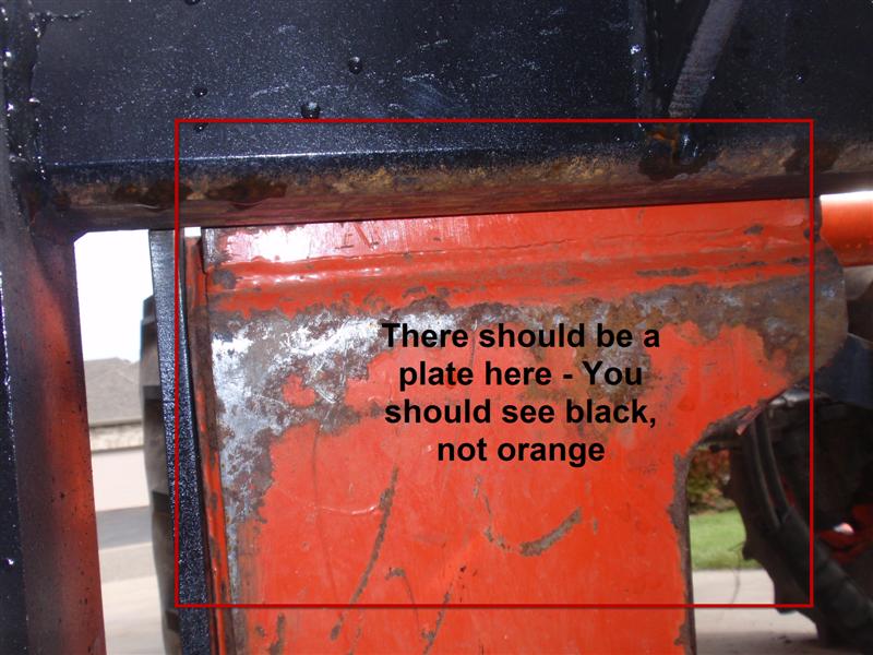

My disappointments are not huge. The grapple has a rather skimpy design in the Skid Steer QA hooks. There is typically a plate that you can bump against, but this only has hooks at the top. If the grapple is sitting uneven, I think it will be very hard to get both sides hooked in. See pic below. I may add the plate later, if I see this being an issue. The only issue with the Fasse stuff was the wire on the switch was waaay too short to work at all. So I did some re-soldering and such. I think the QA missing plate is significant whereas the short wire is a minor annoyance.
attachment.php

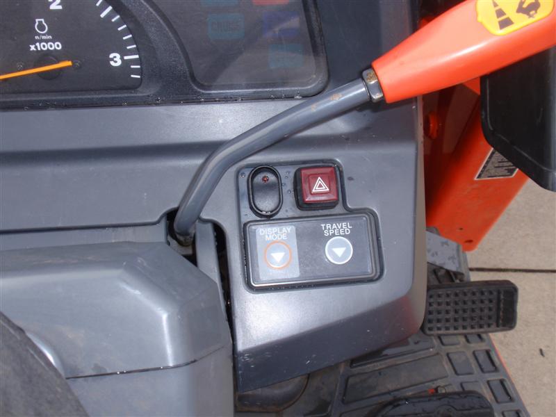

I added a master switch on the dash so that you can't accidentally bump the thumb switch when the grapple is off. Not a huge deal but I thought it was cleaner. Tucked in next to the hazard light switch. Couldn't find a weather proof one, but it gets stored indoors mostly.
attachment.php
Here's a shot of the front coupler mountings, hoses, and you can see the diverter way back at the top edge of the pic (follow the hoses):
attachment.php
The switch on the joystick:
attachment.php

I understand your point about the QA plate but there is a benefit to not having much of a plate there. You will have a much better view of what you are trying to load into the grapple as the plate will not block you.
The area is already blocked by the face of the QA on the loader (that's why you see all that orange in the photo). A 6" wide strip vertically would not affect view but would give you something to bump against for fighting uneven ground. I've already seen the issue with my forks and bucket, and they have places to push against. (I have a very non-flat piece of land.) With nothing there, I expect this to be far worse and require several on/off-the-tractor trips to muscle it in place. That's against the whole point of a QA...
I will try it for a while, but I suspect I will be welding on a bump plate down the road. Mostly because I don't have time to do it now.
