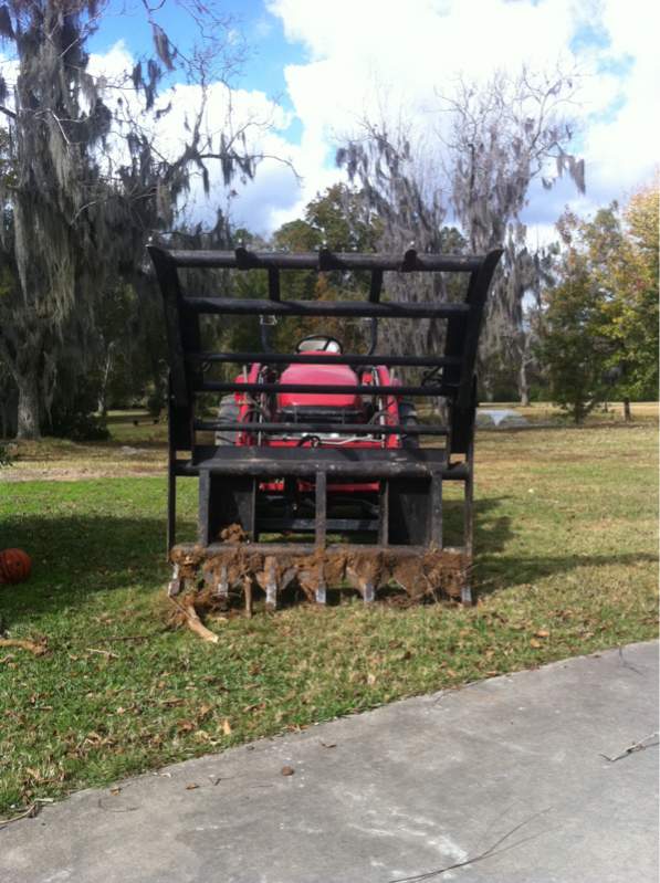

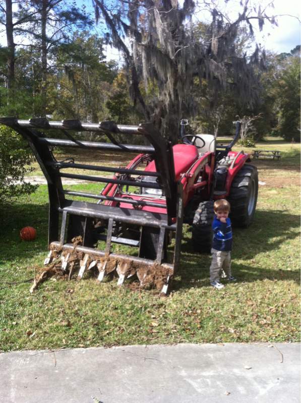

For clearing acres of dense brush and small trees, I've had great success with this root rake / grapple that is the same width as my 40 horse. My little partner agrees.

Rich, I know there is an optical illusion making the size of that grapple look huge, but it sure does look heavy. It must weigh at least 800 lb or nearly 1/2 the DX40's FEL lift ability. You need lots of ballast and to take small bites, I'm sure. My rock bucket mounted grapple is about the same weight and I can sure feel it's weight even when empty. Of course, being heavy is a big plus for a root grapple because it aids ground penetration.:thumbsup:

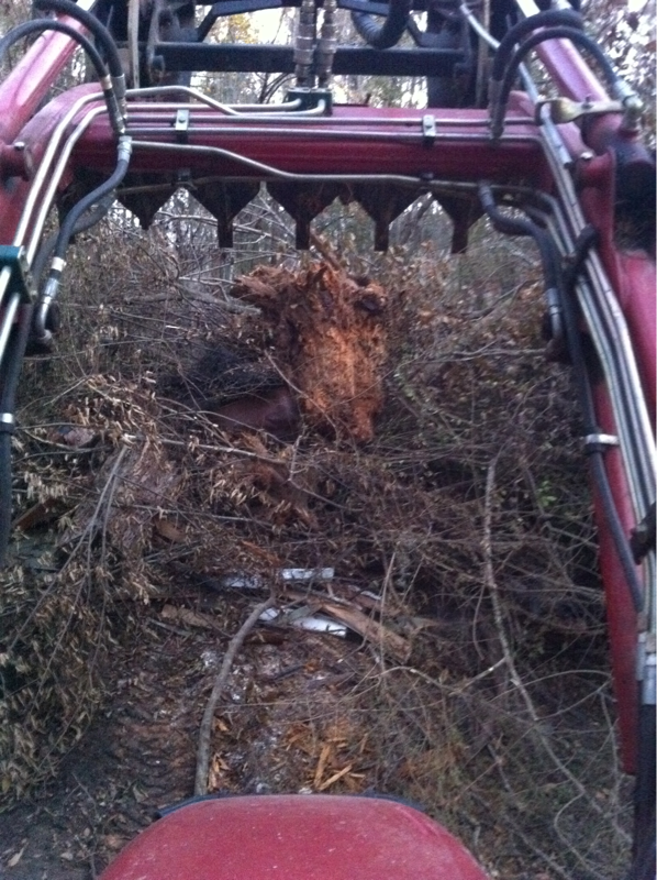

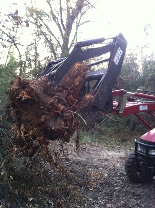

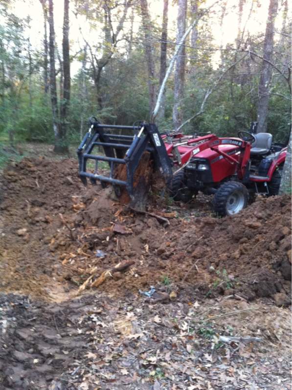

It's not quite that heavy. Actually 567 pounds (WR Long RBG 60) But certainly much heavier than a set of simple forks so cannot lift quite as much. Don't really notice the difference that much though. Here's some pics from a big pine stump we wrestled out yesterday. I apologize for not having the ropes up (Large tree limbs too low back there). Rear tires are filled and usually have 500 pound boxblade on for ballest

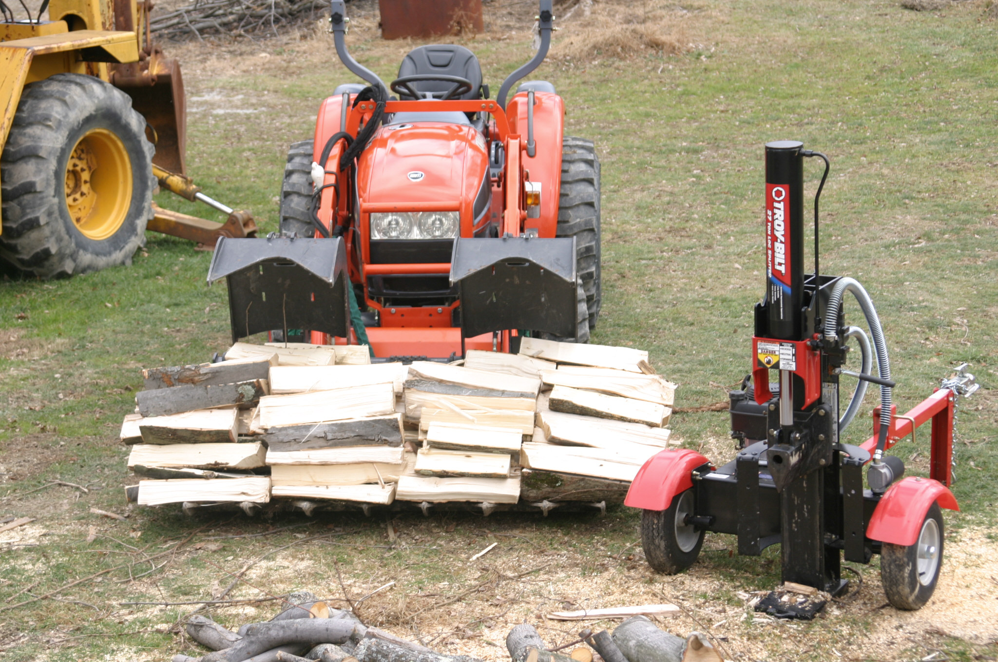

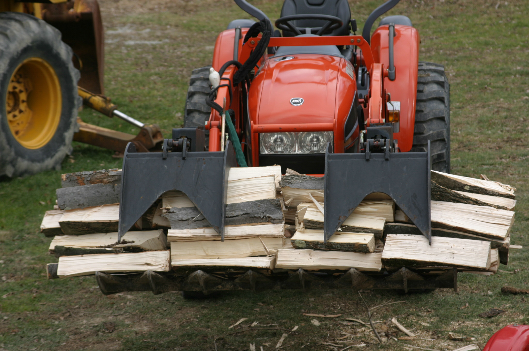

This is how I carry firewood. Maybe half a cord or so at a time. But, I'm sure I could pack more in if I only had a wider grapple.:laughing:
