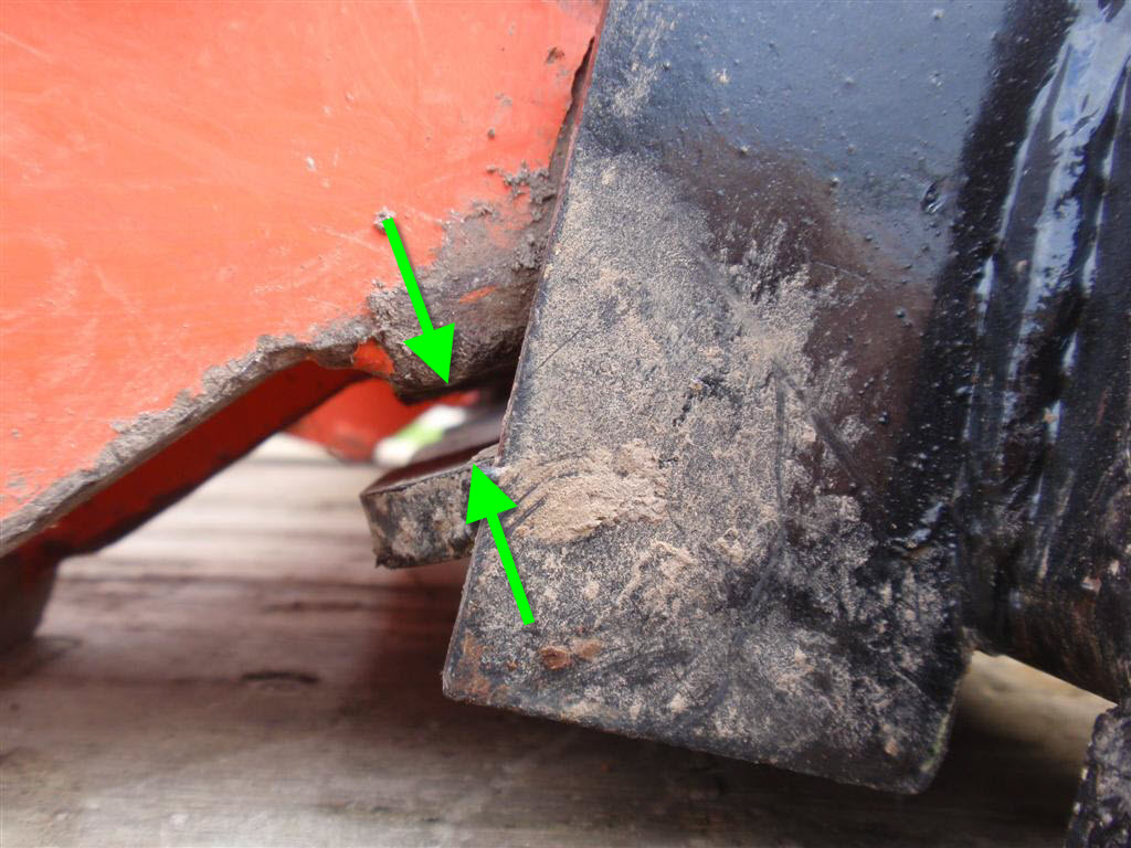

Well I got out to use it today. First off, I confirmed that without something to bump against, the QA is difficult to get lined up, but since there are plenty of places to grab and it isn't too heavy, I can muscle it into place....not that I should have to! I think I will weld in a plate there sometime soon.
Now for the other (MAJOR) problem that cropped up - it popped off the QA during use - twice! :eek:The first time the loader was at full height dumping brush, and when it banged into the dump stop, it popped right off and was hanging by the hoses. Not good. Scared the crap out of me, but I was able to get it back on with no damage apparent. Now I was being super careful, and still a bit later, the top hook of the QA popped out. No drama this time, but jeez. I have QA forks (aftermarket) and bucket (Kubota) and have NEVER had this problem before. I think there is too much slop in the spacing on the grapple QA relative to the standard dimensions, and it is possibly flexing too. Not sure. I'm open to suggestions, but I think my approach will be to weld on a shim at the bottom bracket to shorten up the gap a bit. Probably 1/8- 3/16", but I need to measure first to see where it's at. I suppose I could call Gator and ask about return or fix, but I really need this now, not in a week or 2.

You should definitely contact the Markham/Gator folks about that. Once I push the QA locking lever down (on my Kioti DK45SC with 451 FEL), mine is very securely engaged with no noticeable slop.
The issue I have sometimes run into is having the lever fall down (engage the prongs) by itself while I'm lining up on the grapple or bucket...then I have to dismount and push it back up before I can get the bucket/grapple in place.

I called them and they are going to send out a couple different thickness of lower latch plates to tack on top of the existing ones and see what fits. The gap in the photo is 5/16" which they said should typically be no more than 1/16-1/8". So I get to try out my amateur welding skills. Yippee:( It's a solution that will at least keep me going, but only after the parts get here and I can get that figured out.
For now, I'm going to wedge some plywood in there and wire it in place to take up the gap. That should hopefully hold me for the weekend. Not optimal, but it keeps me moving.

Oh - here is the photo I forgot in the last post
attachment.php
