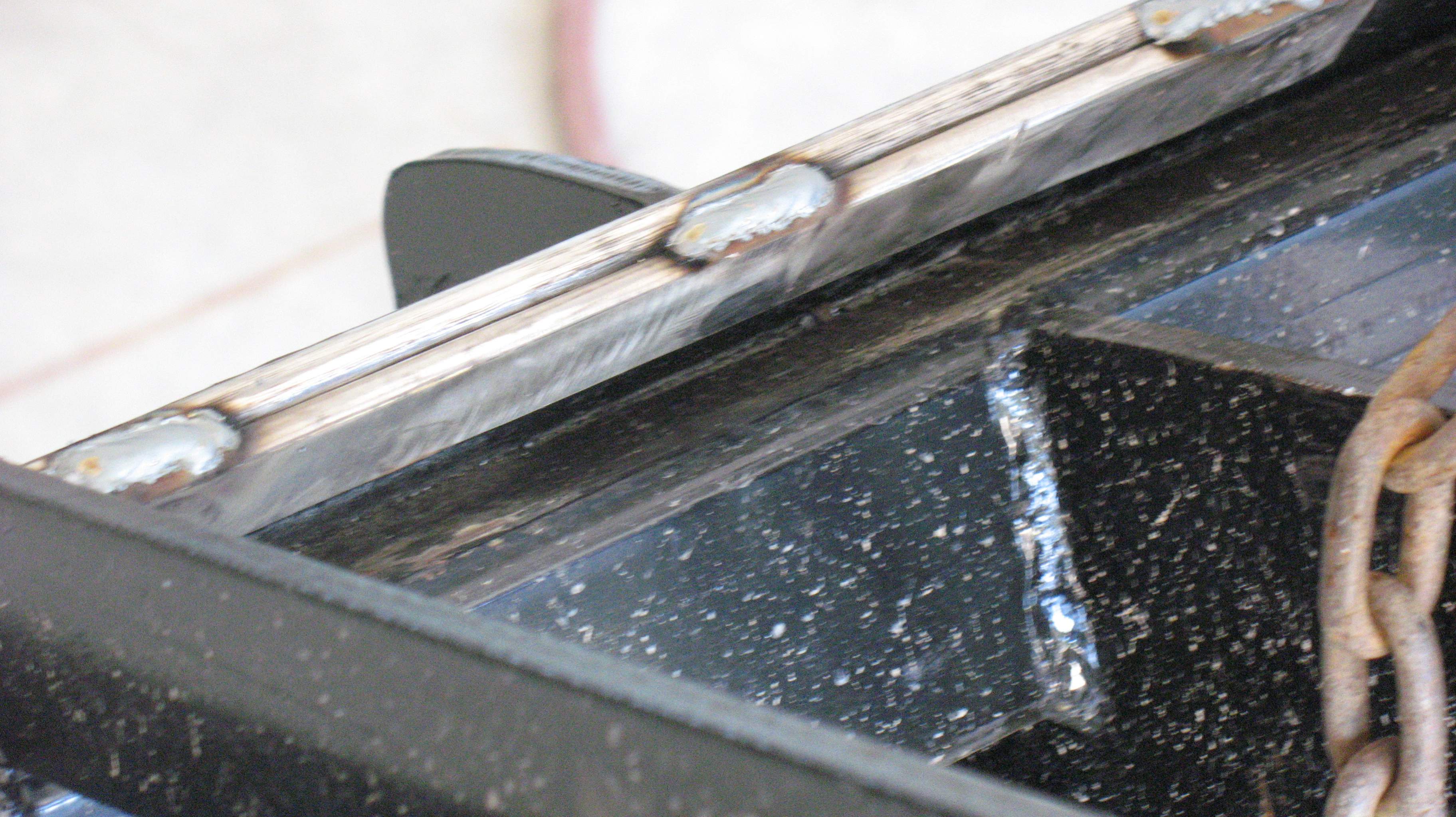

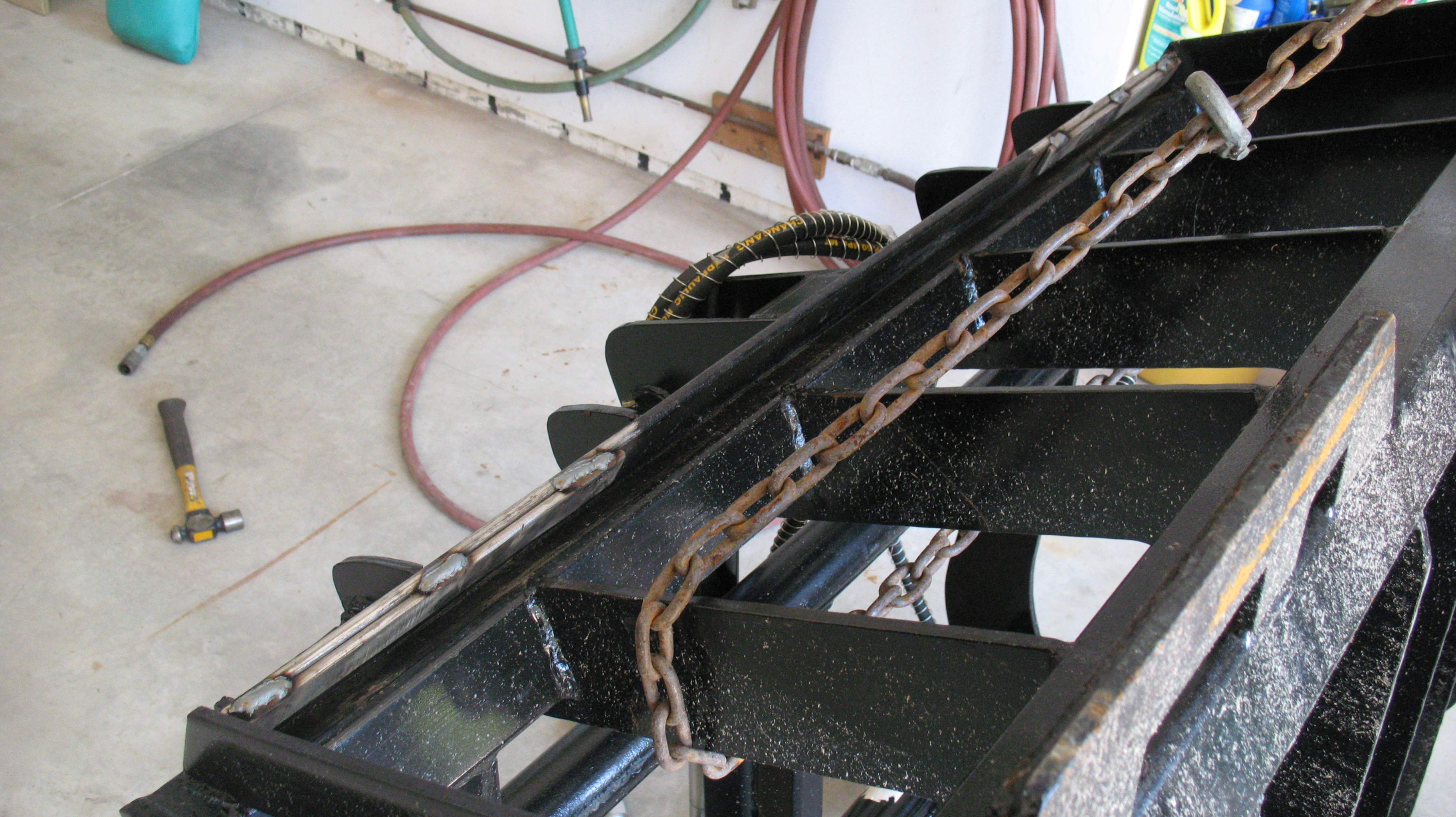

Almost a month later and I finally had all the hoses and fittings come in and I got it together this afternoon. As others on the forum have discovered the SS QA plate is a poor fit on the Titan Express products. Unacceptable fit to try and use the implement without modifying the plate. I had some 1/4" bar stock laying around so I used it as a shim on the top side of the attachment. Once the the shims were in place the the fit was like a glove. the bottom pins were nice and snug against the bottom hole slot when the arms were engaged. Grapple worked well when I used it to pick up some logs and brush down in my wooded valley area. Got a nice burn pile stacked, just waiting for some rain before I light it up, maybe this weekend.
