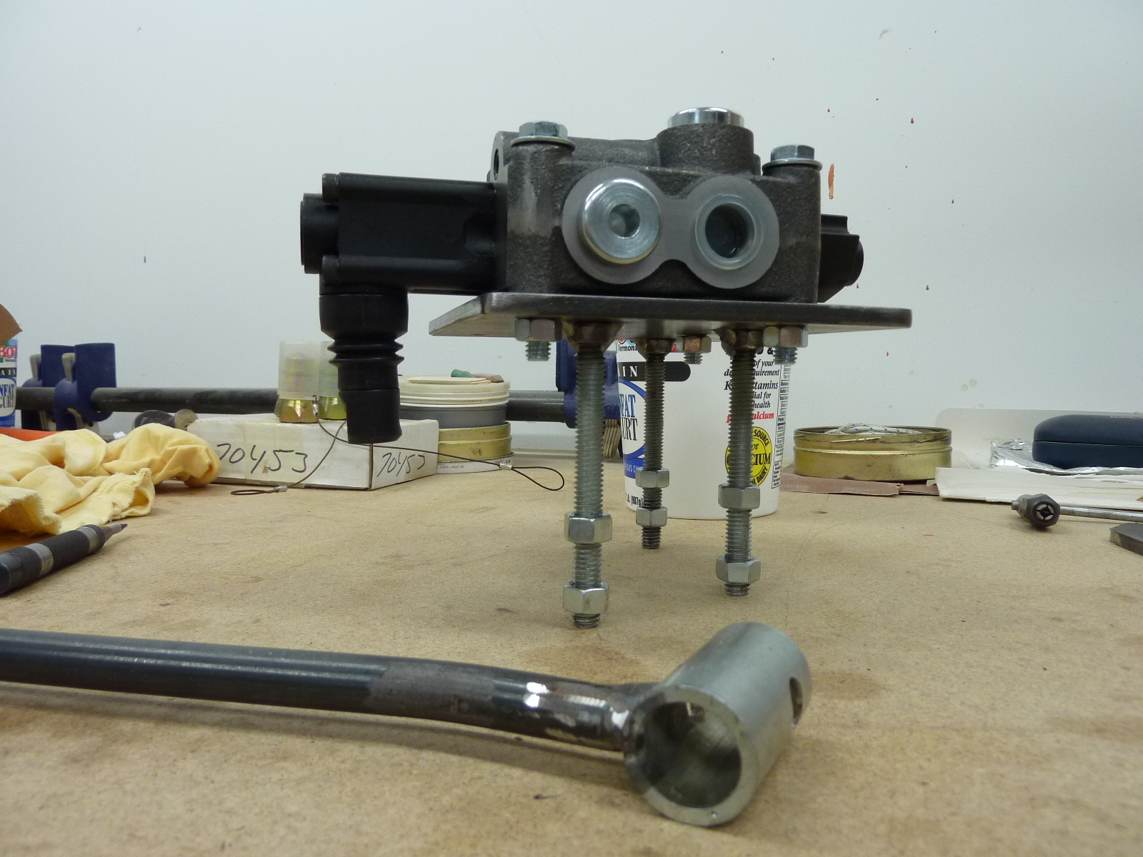

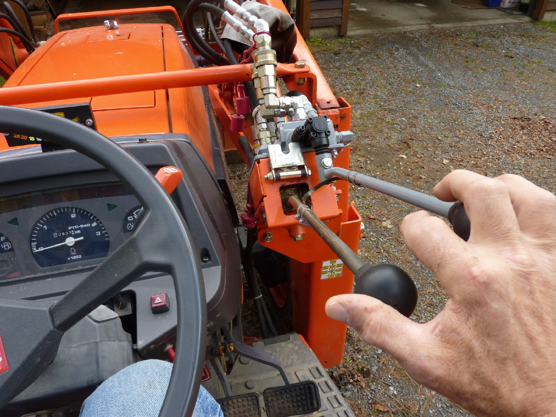

This is how I did my grapple open/close control. Added a OC single spool valve with Power Beyond in series with the Loader PB line. I made the grapple control lever so it can swing left and right with the loader dump/curl lever. I can operate all the grapple motions with one hand simultaneously. Cost me about $225 total for valve, fittings, and hoses.
EDIT: Before I added the grapple valve I operated it from the rear remotes which was fine but I needed to free up the rear remote for a TnT
gg

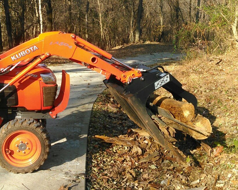

Wayne, the EA single lid grapple is rated at 35 hp. I know your tractor is 38 hp but it the same tractor as an L3200 with more power. On an Implement like a grapple hp is not going to hurt it as much as the weight of the tractor and the tires the tractor has. I looked at the specs of the single lid EA grapple. It looks like the steel of everything on the single lid grapple is the made out of the same thickness as the dual lid grapple expect for the end tines on the dual lid grapple are 5/16.'' I'm not sure if they use the same steel for both grapples or not. I have a dual lid wicked grapple and I am very happy with it. It is indestructible on a compact tractor. I'm not sure but they may rate the single lid for 35hp because people with a larger tractor mostly want a bigger grapple with dua lids:confused3: The dual lid grapple is $500 more. If you got that grapple and got a larger tractor that grapple would be suitable for use on it. I would call Travis at Everything Attachments and see what he recommends for your tractor.
Everything Attachments Compact Utility Root Grapple 50"
Everything Attachments Wicked Root Grapple for Compact Tractors
These pics show an Anbo Rancher grapple (6.5') on a M59. Seems plenty sturdy. This grapple opens about 6' but has reinforcements on the upper arms; will torque a bit on uneven loads, but has never bent. It is a good match for the M59. I have used it to handle brush (shown), logs, rocks, and to clear sagebrush, and it worked great for all of these. My tractor has an electrically actuated third function at the front. Both the grapple and the 4n1 bucket required a flow restrictor to slow the actuation down to a manageable speed.
You have some nice equipment.
gg
Nice work.

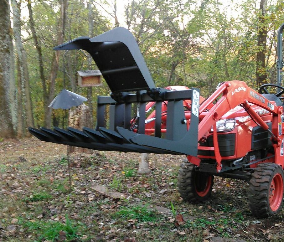

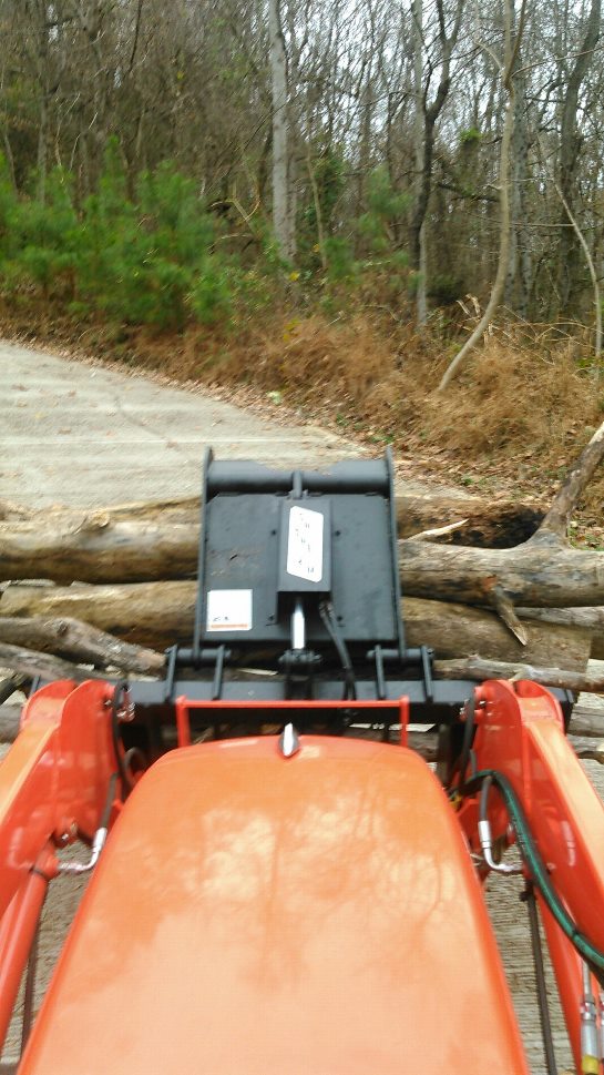

Grapple05.jpegInteresting thread on grapples. Since this is a picture thread, I'll dig one up. The WR Long OBG2-48 I installed along with the electric third function valve does everything that I imagined it would. Like everyone says, on a light CUT like my B3200, I notice the extra weight hanging out front. If I would have gone bigger, I would have really been disappointed. There's a lot of great information and experienced people on the forum. I'm glad I listened to all of them in the many "grapple" threads.
John
KD4FTA
