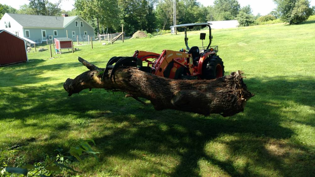

Need to move this twig. I feel my front axles crying in pain doing this kind of thing.

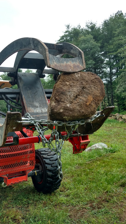

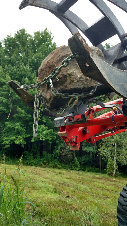

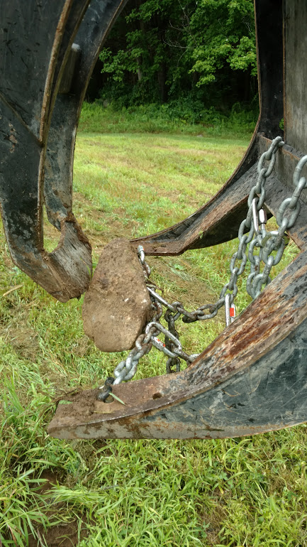

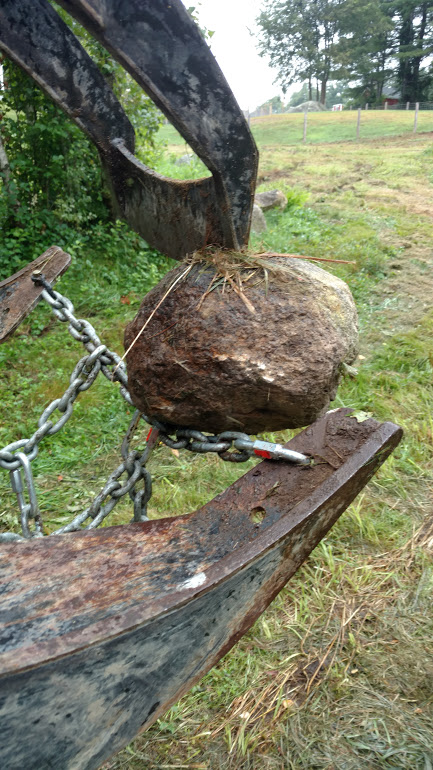

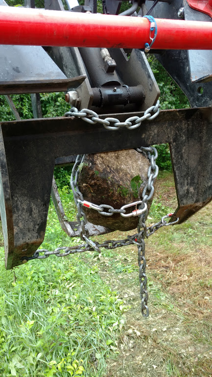

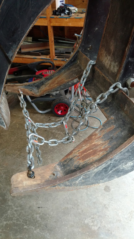

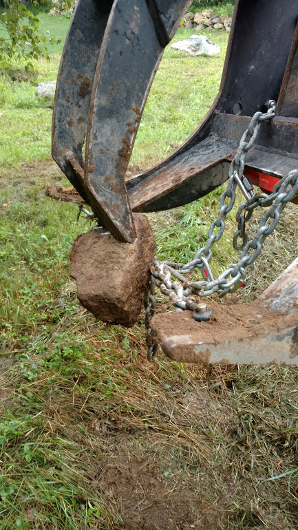

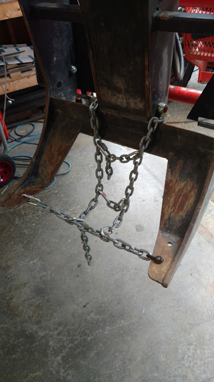

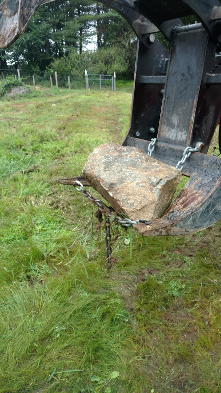

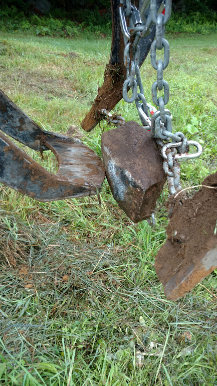

So before y'all go spend money on the "rock bar" for your Igland/clone grapple give a chain a try...
I will use the grapple for grubbing granite rocks and placing them for walls. I bought this grapple to complement my 6ft/900lbs root rake grapple. I need to be able to grub in the ground and pick up very large to basketball-sized rocks. I was going to make a "rock bar" similar to the manufacturers but thought I'd try chain first with stuff I had laying around (except fro some $1.50 carabiener (sp?) type things.
I am pretty floored how well it works with no practice. Essentially all of these pics were "blind" first-attempt grabs. The front chain works so well that I'm not sure the "basket" I created is really necessary (the basket does prevent the jaws from 'scissoring" completely closed). I thought the chain would twist allowing rocks to flip out when the jaw closed but this just didn't happen. This was just a 20min attempt. I'm going to remove the basket part and see how often rocks fall through the bottom jaw.
