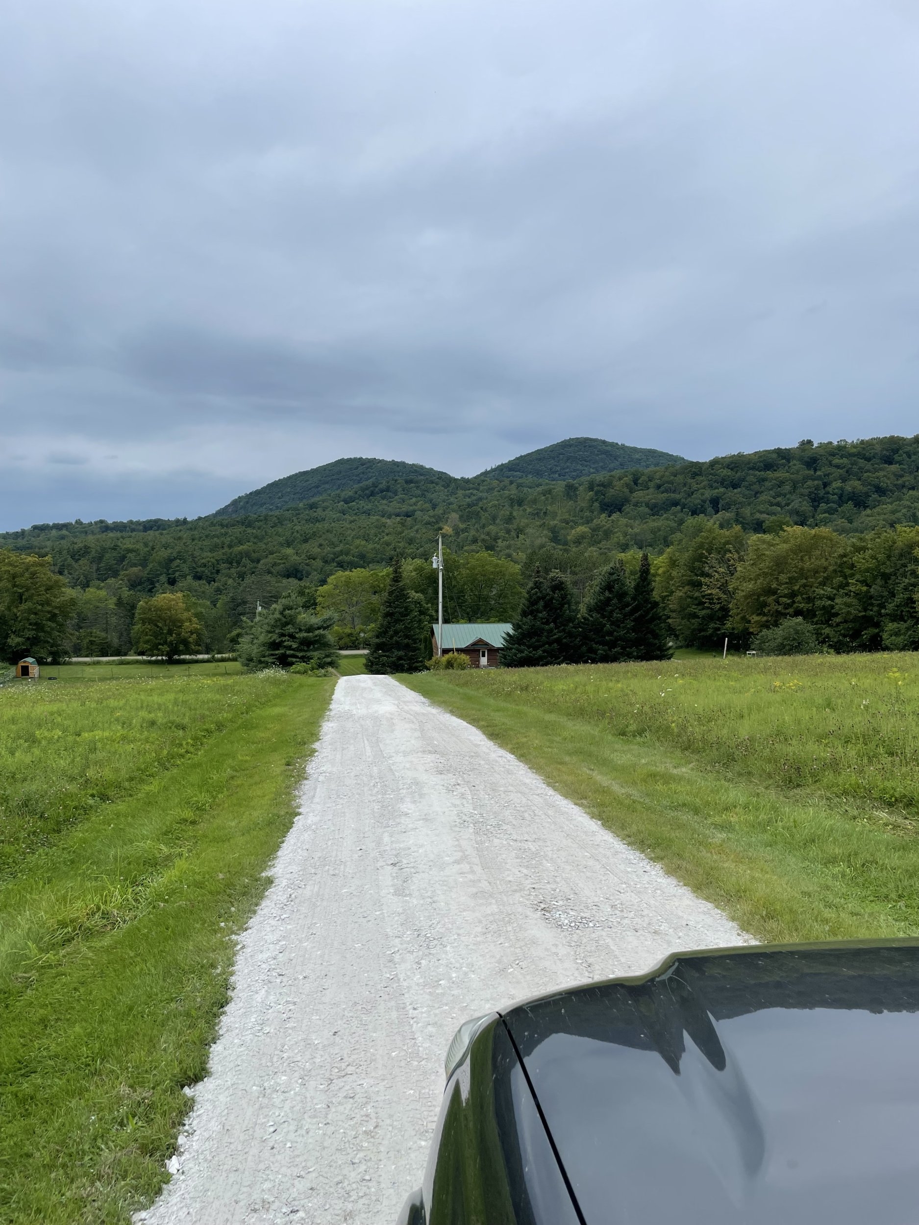

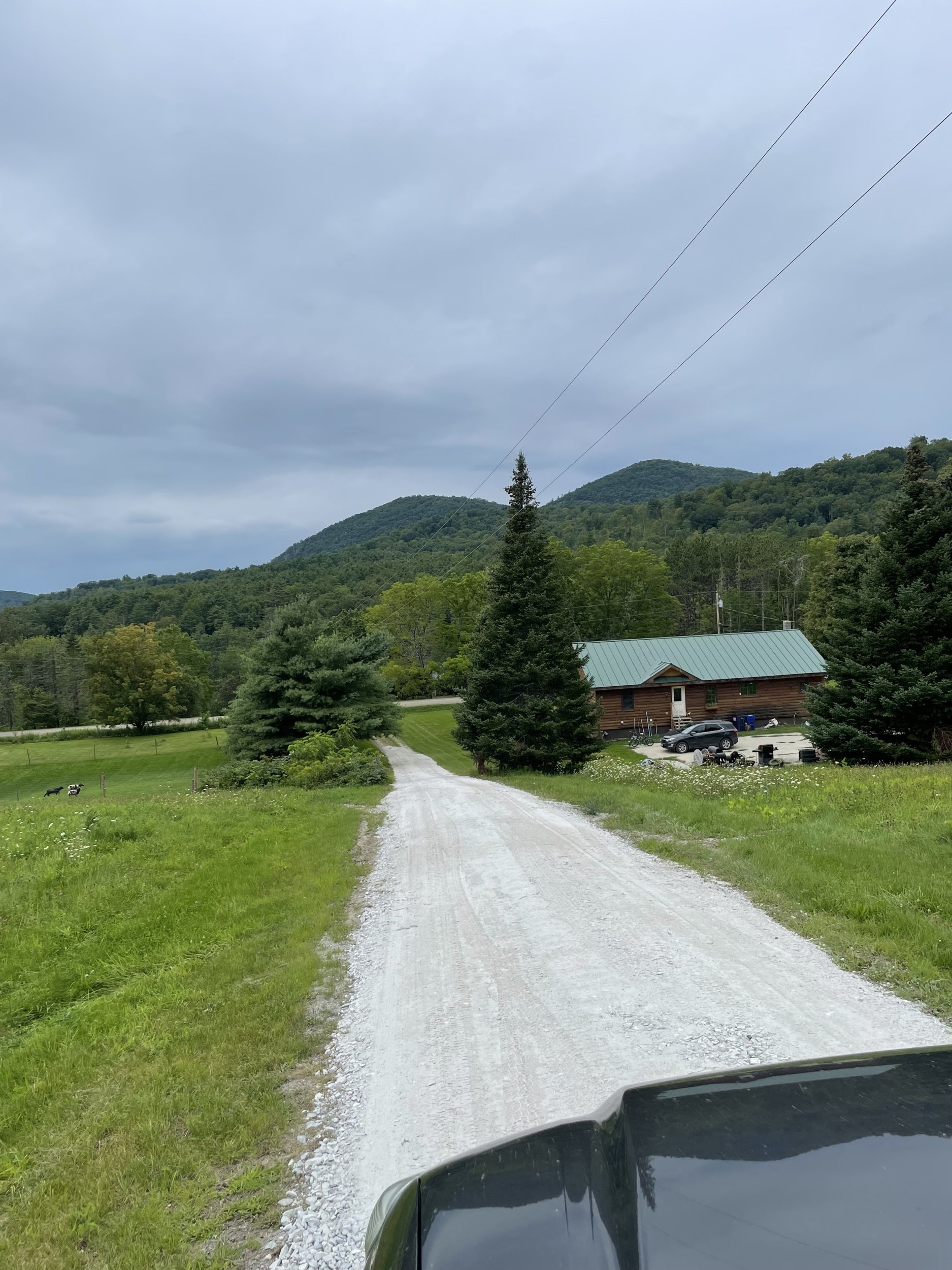

My DW is about 800 ft long and one section is fairly steep, about 200 or 250 ft. I just put down 1 1/4” to 1 1/2” crushed process ! Anything much smaller just won’t hold on the steep section ! Up here in Vermont they call it surepack, and it comes out of Wallingford, Vt. So we graded the DW and then spred 5 triaxle loads of material, regraded and then rolled it !! It’s not cheap, but I’m hoping that it will hold better than the finer material !
