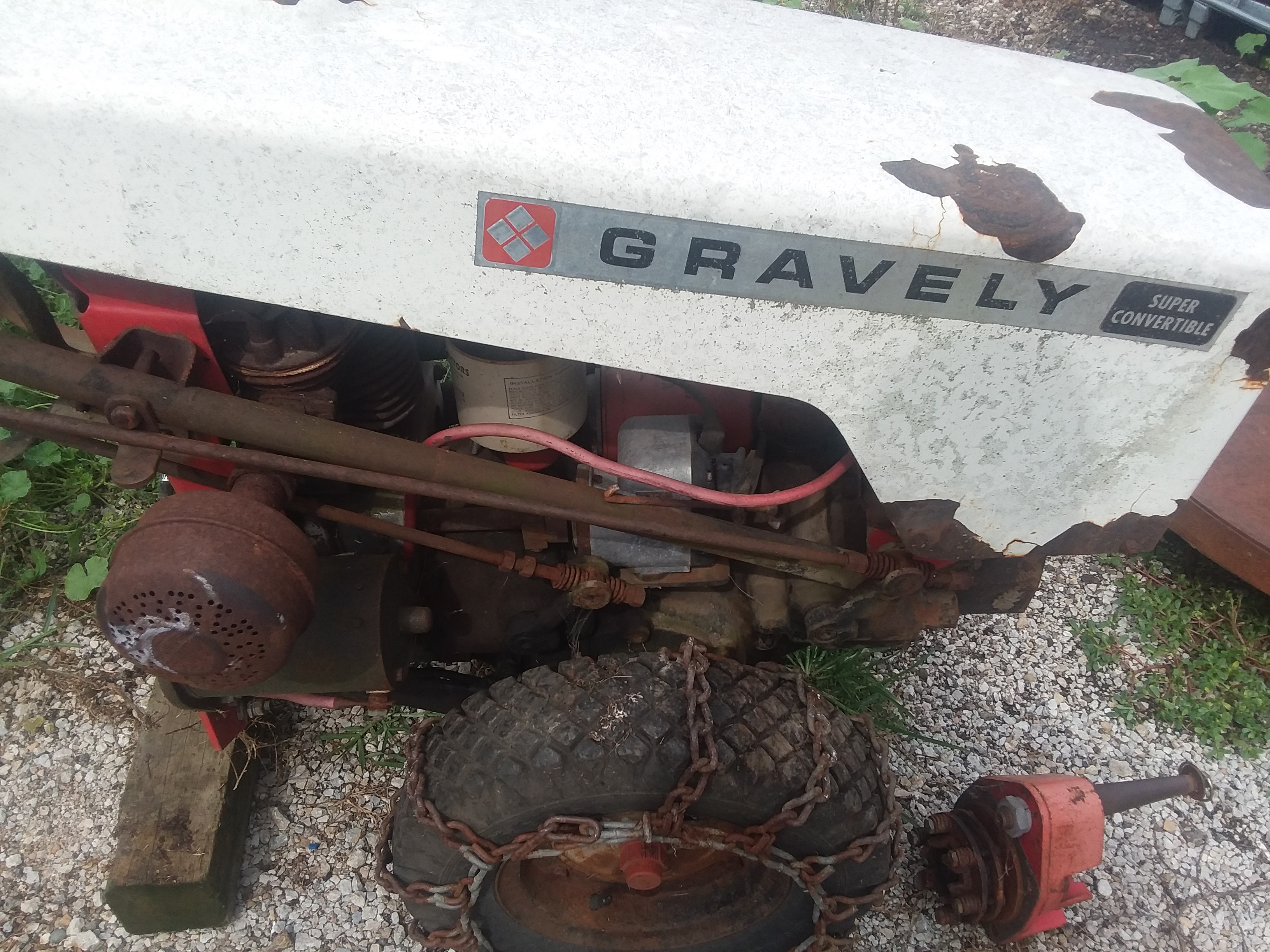

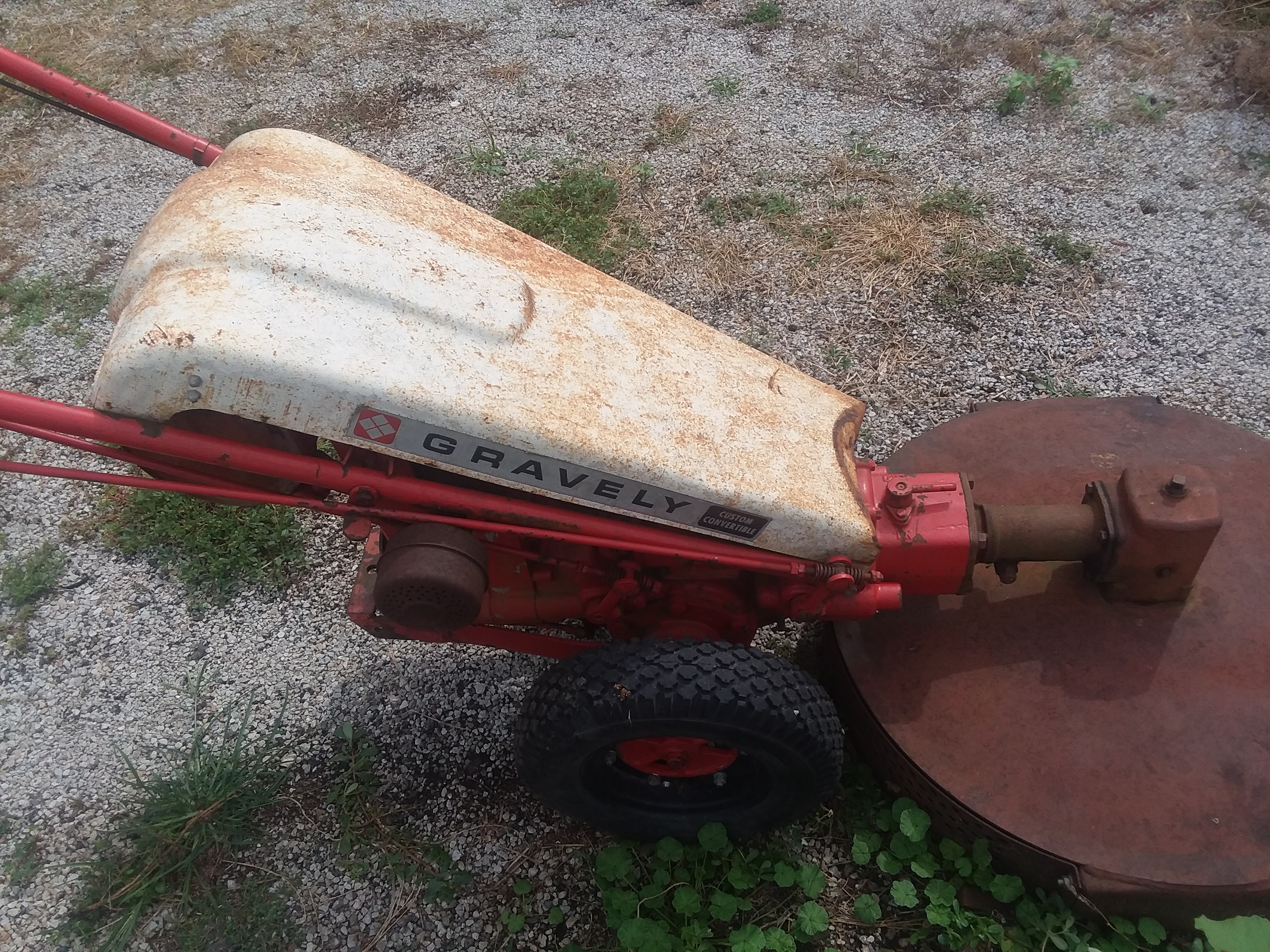

just got these 2 and dont know a thing bout Gravely's! lolo! --- always wanted one---guess they only come in pairs! I cant find serial number on one and the other says LI and serial# is 2793 on it. Neither one run, motors are not stuck so maybe I can get them running. one needs a gas tank and the other one needs cleaned---nasty old gas in it. From what I was told the ran when parked! LOL!! --- actually they were just sitting in a shed for many years so a lot of cleaning will be needed to start with after I learn a bit about Gravely's!
I have more pix of them showing the sides of the motors.

How big of an electric drill do you have,, or can borrow? (not an impact tool, a true drill)
Get a socket that fits the big nut on the crank pulley, and a socket/drill chuck adapter,,
Take the plug out, spin the engine a while with the drill/socket,,soon the magneto will start putting out spark.
(cranking is easier than taking the magneto apart and cleaning it)
When you got a good spark, put the plug back in, start spinning, and dribble a little gas in the carb,,
if it tries to start, then it is time to dig into the carb,, and it will run just fine,,, :thumbsup:

One thing I ran into on the 5665 is that you could not set the points at 0.020. Otherwise, they never close. Have to set at about 0.016.

One dont have spark, mag clicks but nuttin on the tester, the other one dont even click. --- I despise mags on motors! I always end up having to convert them to battery coils. Next up will be to try to file the points in the mower one and try to get spark---- IF that dont do it ---- well battery coil time!
   / Gravely's #10
My brother rebuilds/repairs/recharges mags for these old Gravelys. PM me if you want his contact info.

finally have spark in both tractors and they will fire 1 shot every now and then but wont go----gotta be more carb problems, I guess! lol! trying to rig up an electric motor and v belt to start them---I think it will work with some help to hold everything and work the choke and throttle levers.
