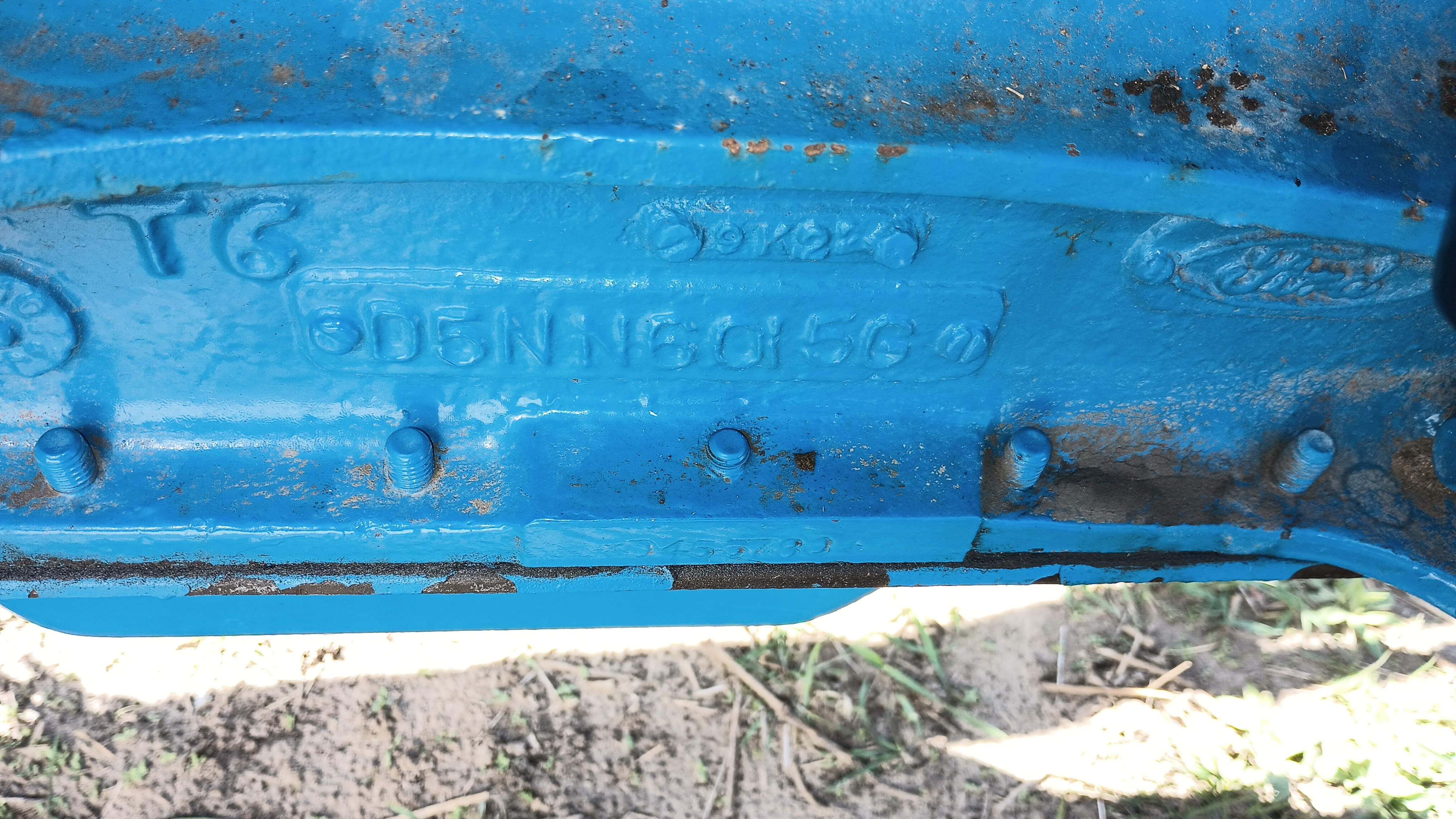

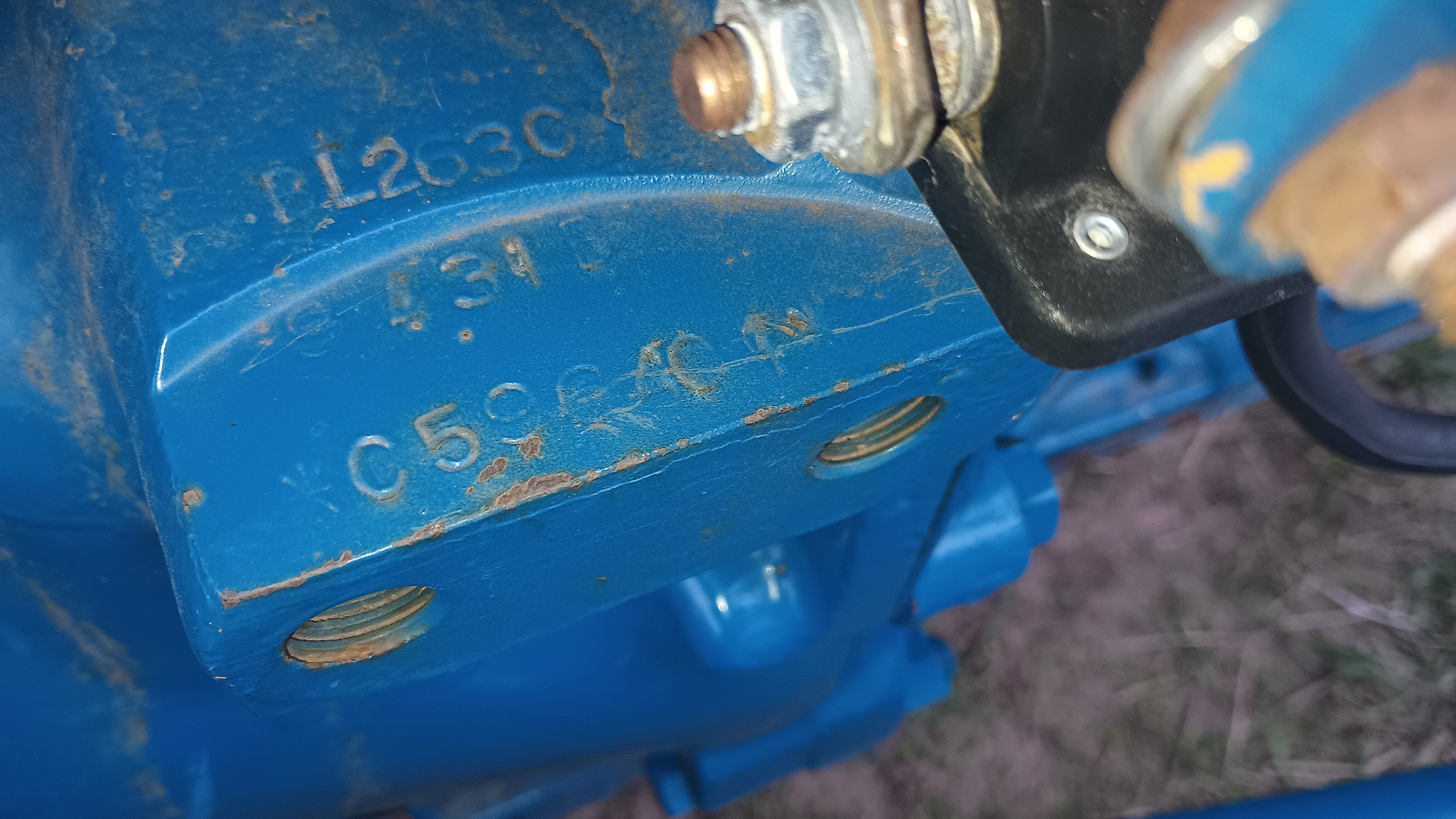

A number of years ago I purchased a blue Ford 3600 tractor from a seller on Craigslist. Recently, I needed to purchase a new Zenith carb, but the part I received doesn't seem to be correct. Unfortunately, when I try to decode the numbers, things don't make sense. I think I may have purchased a "frankenstien" . . . Here's what I'm finding based on the numbers on the bell housing and engine block:
BL263C
9A31B
C59640
D5NN6015G
BL2 - Ford 231 Industrial 1976-1981
6 - Gas Horizontal exhaust
3 – Live PTO 540 rpm
C – 8 speed manual (4x1 + hi/low)
9A31B - Day Shift, Jan 31, 1979
C - American made
59640 - Serial number
D5NN6015G - 201 CI Engine, found in the 4000 series
Neither the "BL2" or the "D5NN6015G" seem to be for a Ford 3600. While the other information I decoded seems to match my tractor. It would also seem that it was painted industrial yellow at one point in its' history.

The engine would have a serial number on the RH bottom of the block stamped just above the oil pan with a C to indicate it has a 192 cid engine for a 3600 or 231.
The casting number just indicates that is the block of the period. It coukd have been a BSG332 or 333.
With that transmission, it could be either a 3600 or 231. Color is the difference, so it could have shipped as a 231.
Either way, the carburetor shouldn't makeca difference what you have. Ford offered a Zenith or Holley carb for its gas engines.

The serial number on the engine block appears to be D455780.

Most tractors of this period have had an overhaul at some point. The D designation in the serial number indicates that the engine was either swapped for a new 201 cid BSG engine or a reman engine installed, so the old carb would have been more correct for the engine size.
I was thinking of later 3000 series models with the 192, but neither here nor there. The reference chart is right for your tractor and I think it is a 231 painted blue with a 3600 decal and a larger engine.
I think you could swap the high speed jet from the old carb to the new carb and solve your proble.

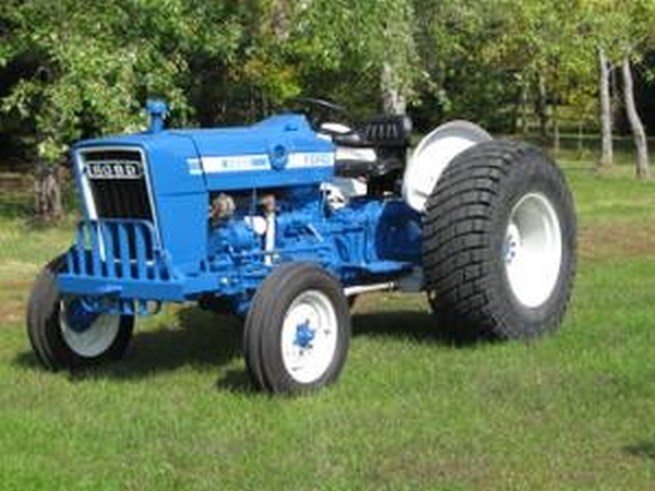

The thing that made/makes it a 231 rather than anything else was that it should have a shorter spindle. From your profile picture, that looks to be true.
It was sold as an LCG, Low Center of Gravity tractor-industrial. Similar to a turf tractor designation. Ford had a plethora of model offerings that sometimes, IMO, made not a lot of sense, but satisfied different markets.
The guy I bought it from seemed to me to be some sort of amateur tractor jockey. He did mention that he purchased the tractor from a municipal golf course and "restored it" . . . which I took to mean "overhauled with a paint brush" . . . maybe he swapped the motor, or maybe the golf course mechanics did it.
What you're saying related to "turf tractor" makes sense with what little I know about the history of this unit.
