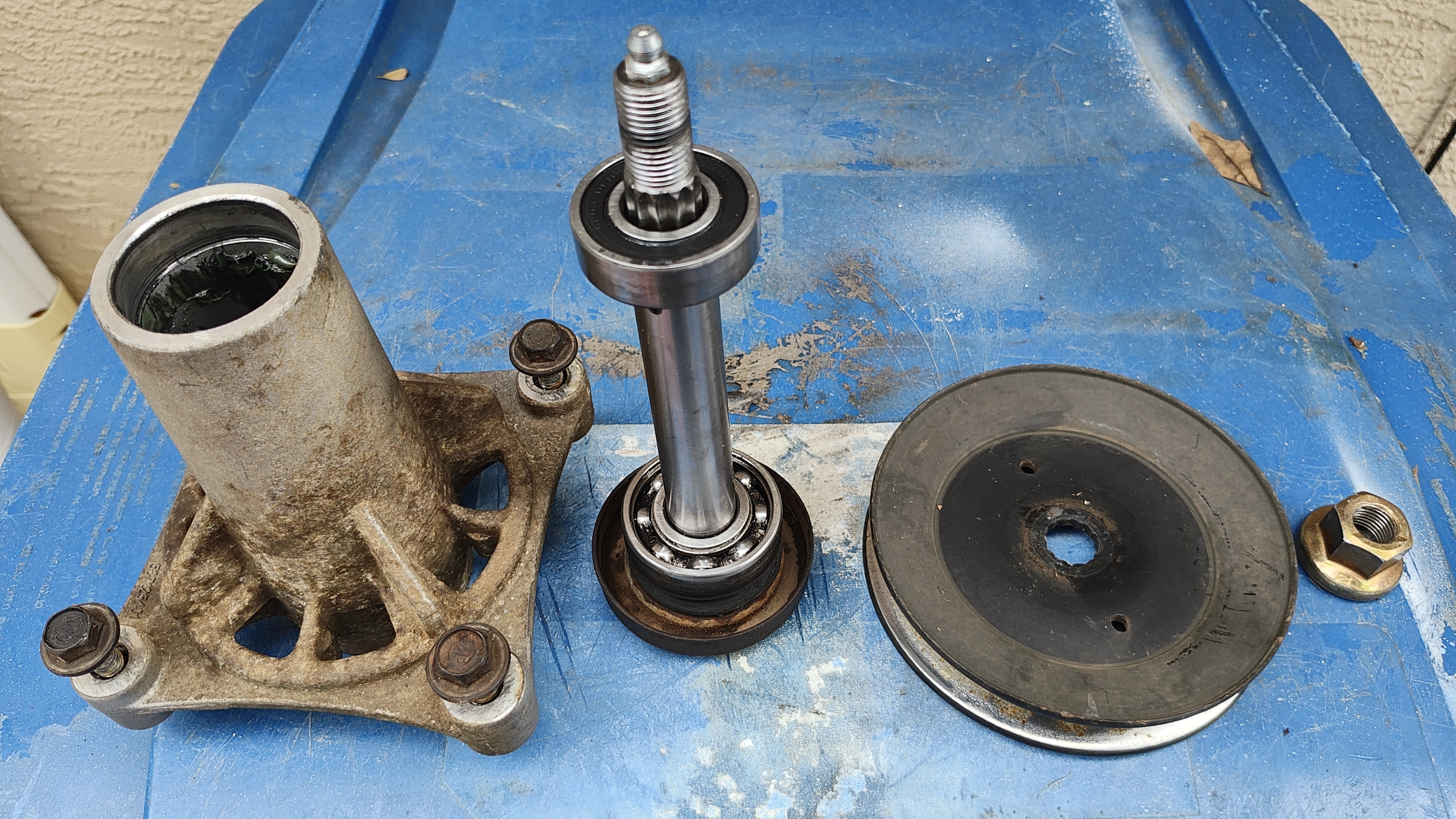

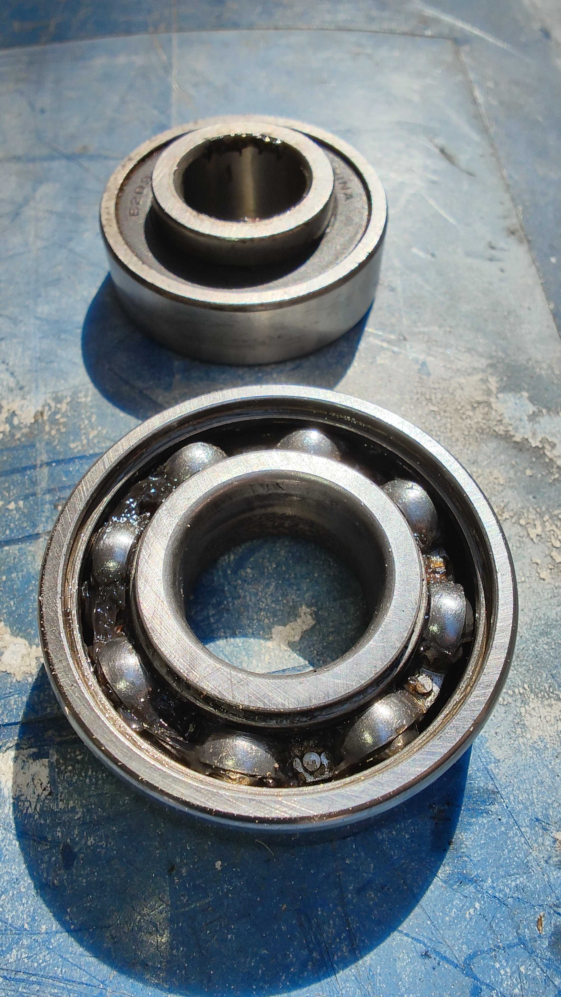

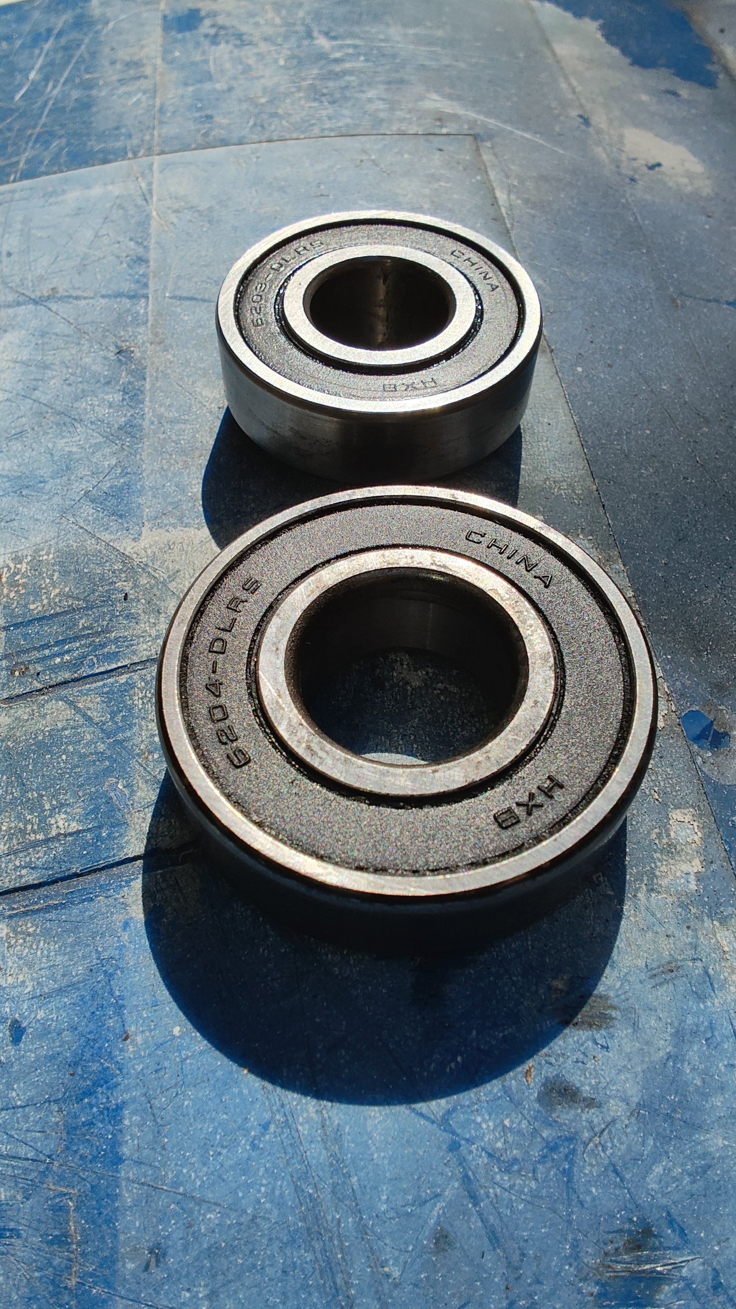

I just opened a original OEM spindle (532187292) on my 2015 Husqvarna YTH24V48LS lawn tractor and found grease still in the bearings. I have only greased them once in the 9 years I've had it and routinely mow an acre lawn over Florida sand. Interestingly the top bearing is sealed on both sides and the bottom bearing is only sealed on the bottom.Both bearings are Chinese make.
Also, I found virtually no grease in the cavity between the top and bottom bearings.

/ Grease for mower deck spindles? #11
Pics and everything. Welcome to TBN.
