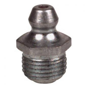

Interesting coupler. What is the diameter? My loader zerks are recessed and they did not leave a lot of room for anything larger than a standard coupler.
   / Grease Gun #16
The diameter is 11mm. Try this, go to your local auto parts store, get a zerk with the 1/8 inch pipe thread and screw it into the standard coupler that you removed.
Then lock the LockNLube on to the adapter and grease the recessed zerks!

Pretty clever there X-man
Seems like a good way to give you any kind of quick change tip.
