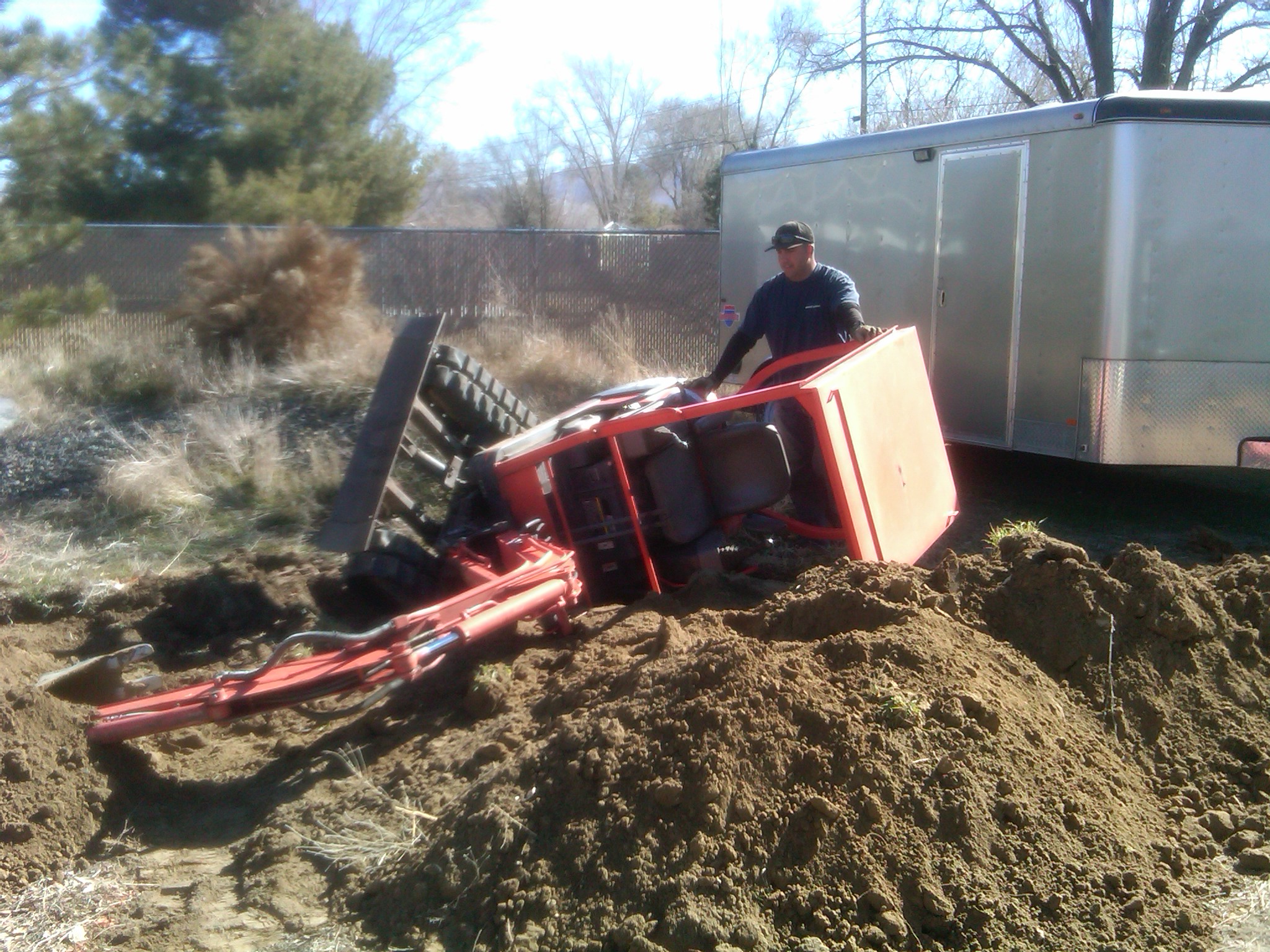

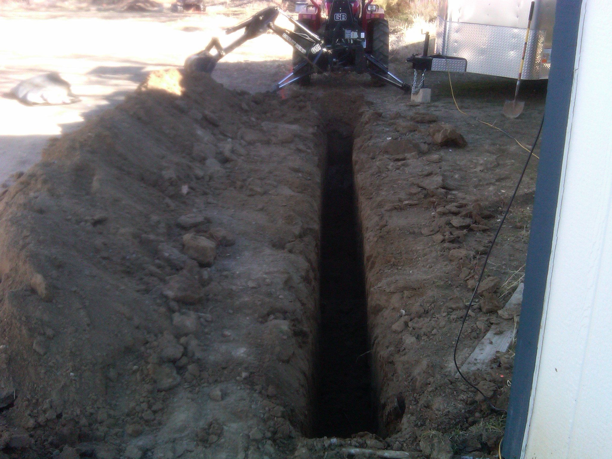

Nortrac NT254 - 1 point
Kubota Excavator - 0 points
See photos and you will see why.
Actually at the end of the day we each trenched 100 ft (200 ft total) at 3.5 feet deep. We had three trenches merge in a "T" shape. My tractor was better at making the trench connections because:
1. I didn't fall into the trench, haha!
2. my backhoe hangs off the back of the tractor so I was sort of cantilevered over the trench at the end when I had to be perpendicular instead of parallel.
My Nortrac righted the excavator with a chain to my FEL, I lifted it right up, then helped pull it out after up righted.
The repaired cylinder on my backhoe worked perfectly. I don't feel the need to check the PRV, it bypasses when I get the bucket stuck but still has enough power when I need it. Good enough for me the last 12 years with only one failure at a time I knew I was being rough on it. Also, I now grease it right before each job, the day I bent it I hadn't greased in a while.
Bob, I can tell the pressure by the swell of the hoses, and the flow by the hissing sound when a cylinder moves fast. Haha.
Ron, The welds and bucket are holding up but I can see the stress spots (the paint comes off too at the stress spots, I guess from the steel flexing or maybe making heat).
Gene :^)
