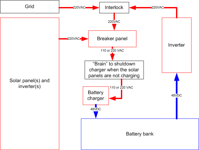

For the record my knowledge of solar is extremely limited. But if you wanted a grid tied system with a separated battery bank couldn't you use the electricity made through your solar array to charge a battery bank with a float type charger from an outlet in the basement. Then treat the battery bank like a generator, when the grid goes down throw a switch on your electric panel in the basement and transfer to battery power? I understand this is a grossly simplified description and by going from dc to ac back to dc there would be efficiencies lost but wouldn't this allow a battery back up to a grid tied system?
/ Grid-tied solar #370
Are you talking about a charger feeding a battery bank, then a inverter running off of that? Something like the diagram below?
I could see that working with a couple of caveats:
  1. You would have to have a mechanical interlock so that the battery bank inverter couldn't be turned on when the utility power is on
  2. You would have to have some way to shut the battery bank charger off when the panels or a generator are not running (perhaps a trigger on the battery bank inverter to turn on/off when it is putting out more than x amps)
  3. You might need an additional loadbank depending on how the solar panel inverters handle less than a full load
Aaron Z
Aaron Z
It could be something along those lines.
If you have grid power available at a reasonable installation cost, the cost and reduced maintenance advantage lies with a grid-tied system. I think that is especially true in situations where high electric demand cannot be dodged, such as 24/7 AC for six-eight months.
If your situation is such that you don't need AC, use LP or natural gas for cooking, refrigerator & freezer, clothes dryer, domestic hot water, and heat and domestic HW with wood in winter, turn off the vampires when not in use, then you can cut your electric usage to a very small number that can be supplied by an inexpensive off-grid solar system. That number is a baseline that can be worked up from if a person wants to use more solar PV, less gas, and lower cost standard appliances.
A generator is going to be part of any system strategy, so that is a wash purchase cost and maintenance-wise.
In terms of "green-ness" 30% of the grid power I purchase comes from renewable sources, and 100% of what I produce is from a green resource. Of course, the renewable percentage of grid power varies by state regulations.
