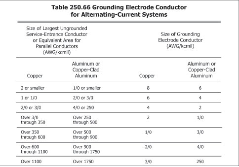

...so why does the grounding electrode conductor connecting the neutral to the grounding electrode system of a 400 amp service have to be a different size than a 100 amp service? (i.e. is there any logical reason?)
Ground faults can occur anywhere in the system, so the grounding electrode conductor has to be sized to carry the fault current back to the main bonding jumper wherever the fault occurs so the overcurrent device will trip.
You will find that the code does not require a grounding electrode conductor larger than 6AWG to ever be connected to a ground rod, regardless of the size of service. This is because it is understood that the #6 wire will be able to carry all the current that a ground rod is capable of disapating. This only applies to driven electrodes, not the Ufer ground, or the water main, etc.

Ground faults can occur anywhere in the system, so the grounding electrode conductor has to be sized to carry the fault current back to the main bonding jumper wherever the fault occurs so the overcurrent device will trip. You mean the equipment grounding conductor (EGC) (i.e. the green wire) you run with the circuit has to be sized to carry the fault current back to the main bonding jumper (usually at the service panel)
You will find that the code does not require a grounding electrode conductor (GEC) larger than 6AWG to ever be connected to a ground rod, regardless of the size of service. Maybe not to a single round rod, but from the bonded neutral/ground bus to the ground electrode system it's sized based on NEC table 250.66 This is because it is understood that the #6 wire will be able to carry all the current that a ground rod is capable of disapating. This only applies to driven electrodes, not the Ufer ground, or the water main, etc.
