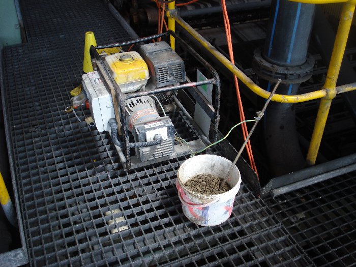

Lots of info in this thread - but here is a guy who likely did not read any of it :D LOL
(well, the grounding rod is in the dirt....)
   / Grounding Rod For Portable Generators Necessary? #125
Good one Dave. :laughing:
Now that's a guy that likes to be code compliant. :confused2:
