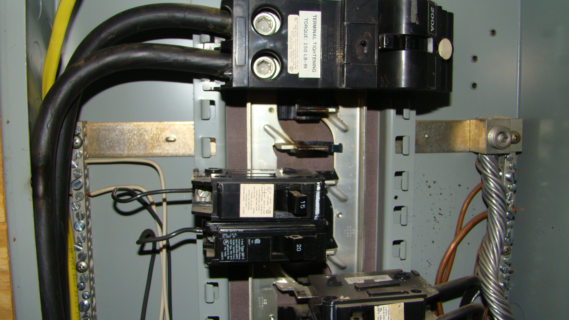

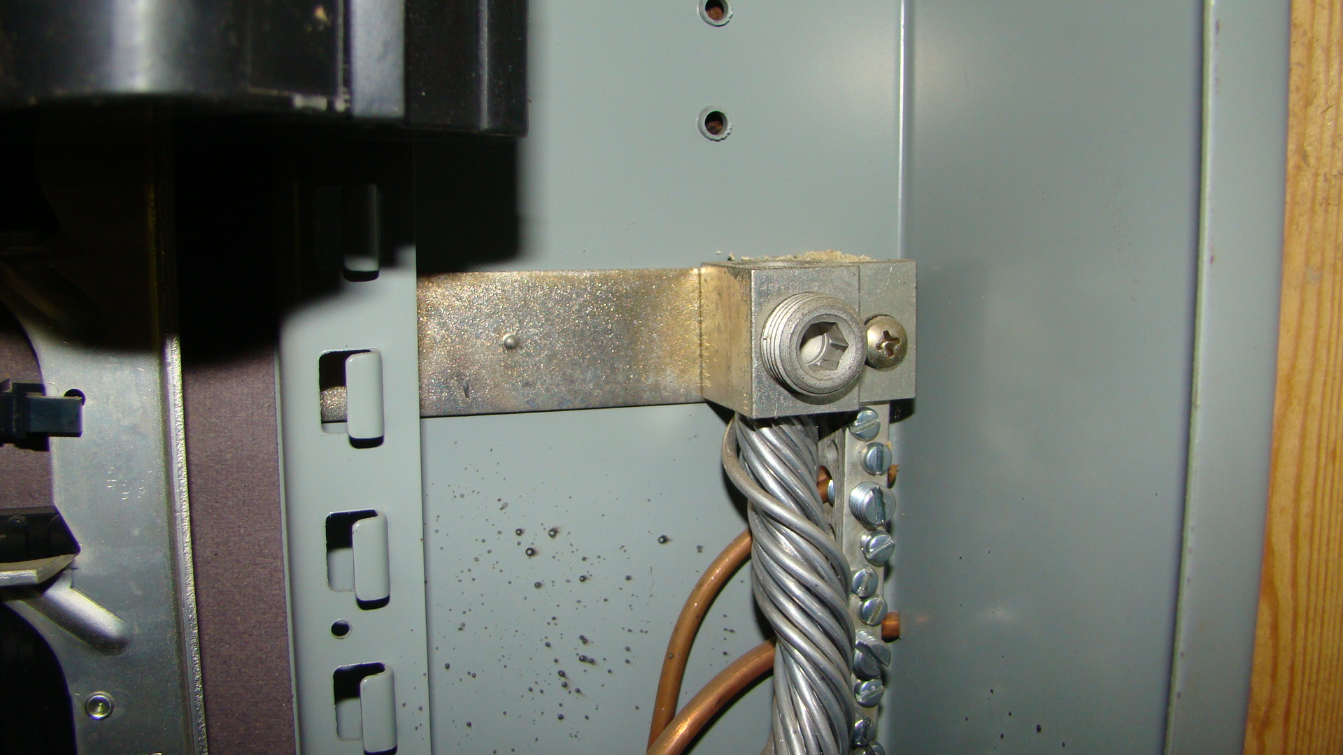

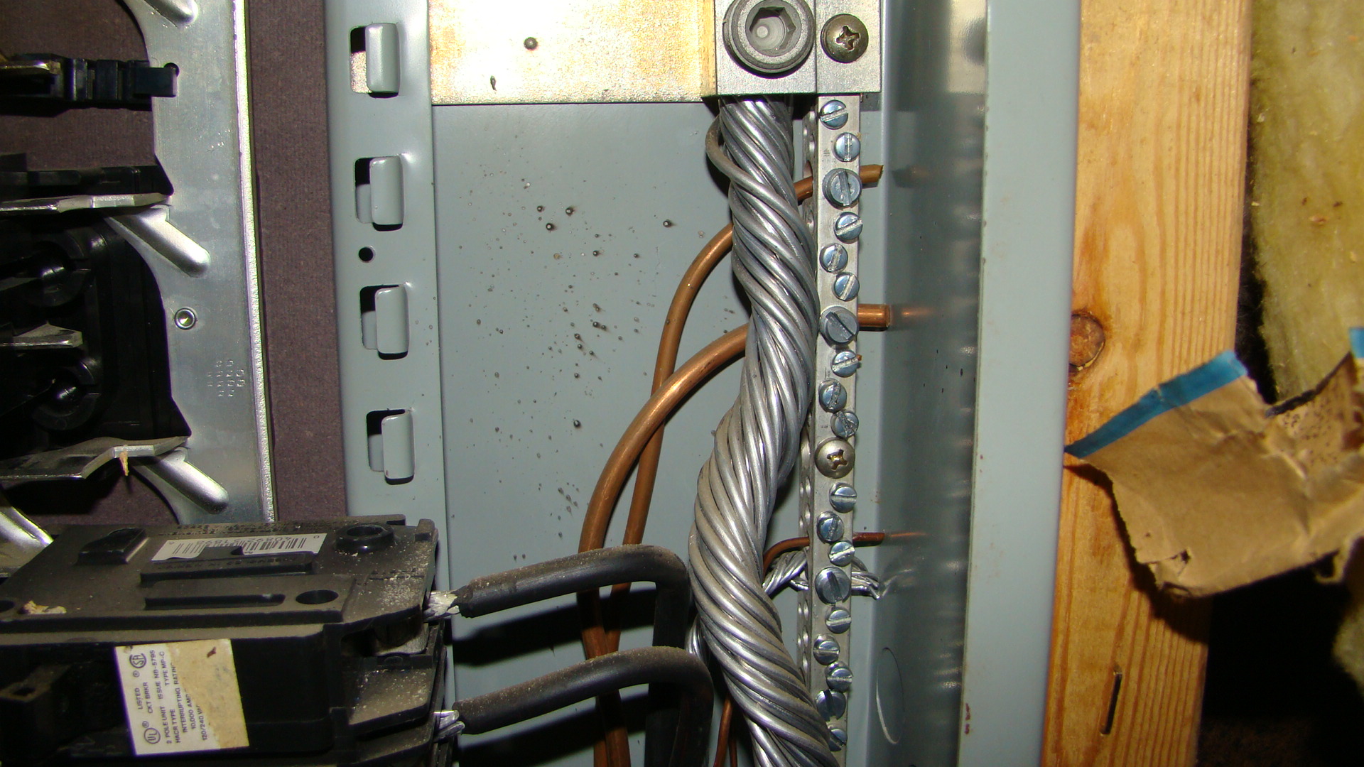

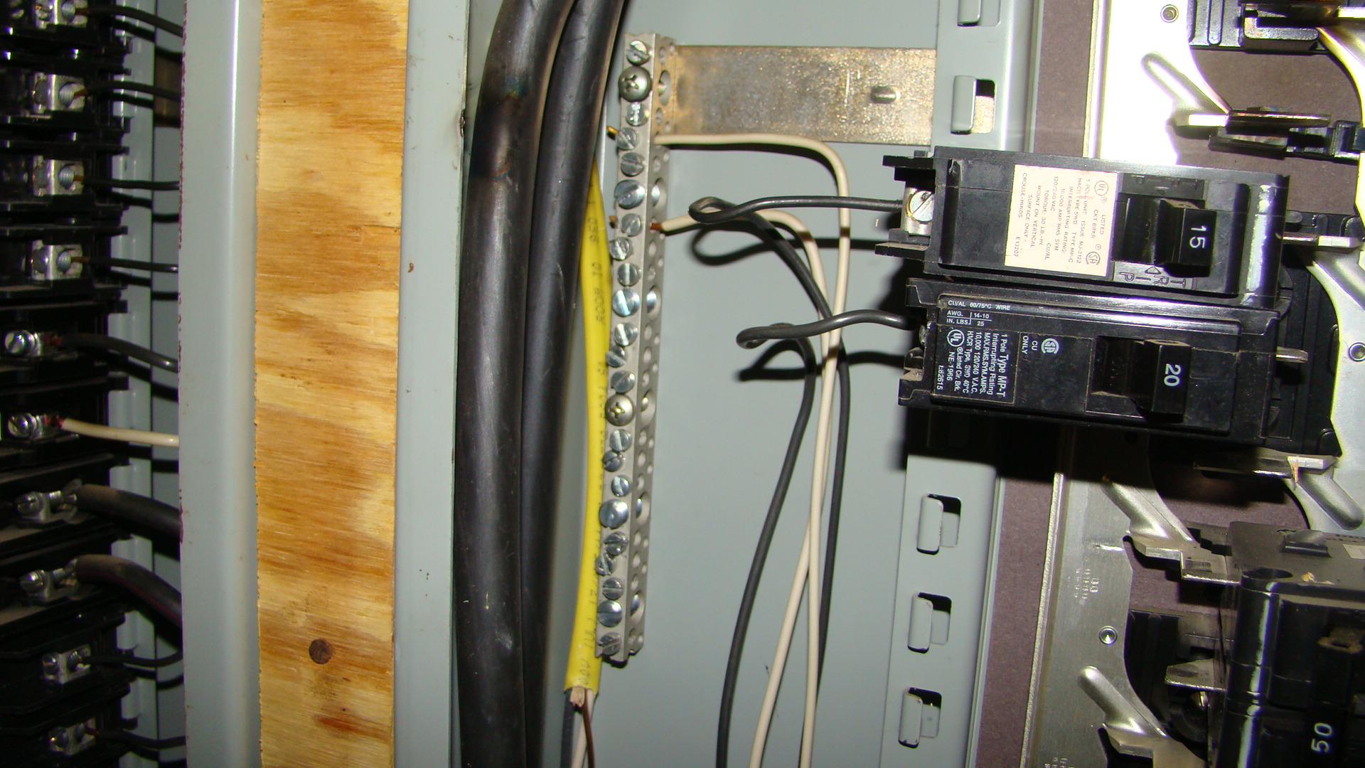

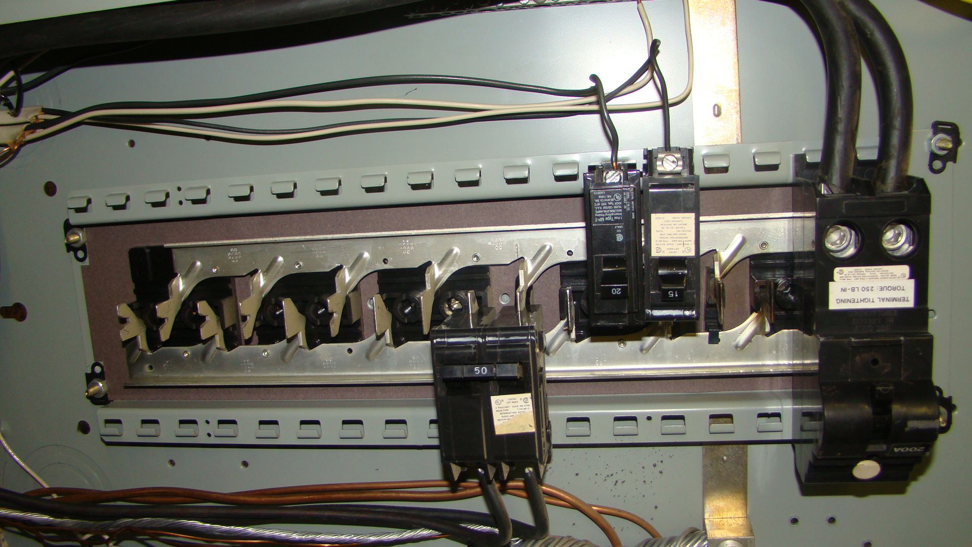

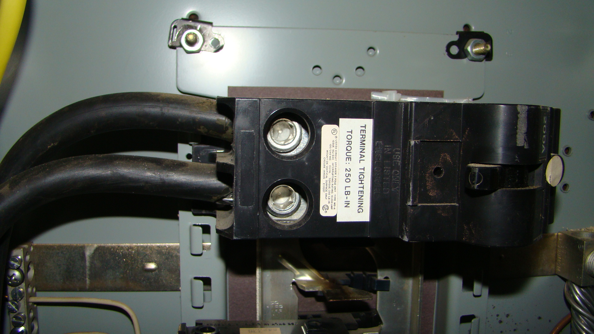

Well I done hit a snag it seems. I was all ready to run the service wire into the panel that I moved a bunch of circuits from and now I have to figure out how to connect that big azz wire to the buss bar. I did a lot of checking before I got this far and then no one mentioned that this is something that can't be done. Now when I started checking around for the connection kit that was supposed to be available, everyone says, are you stewpid? That is something you just cannot do. Back to almost sq one I guess.

It's a Crouse Hinds panel.....I built the house in 92 so it's that old and don't have the pass through lugs installed like some of the newer ones do. I saw some of those neutral lug kits but couldn't figure out how they would work, maybe i'll take another look see. Good to see you are still kicking, not that I'm trying to kill you off or anything:laughing: but I have been really busy and don't get to sneak in much lately.

I looked at those and am having sort of a hard time figuring out how they wood work for me. How can I reduce the wire size and still be able to handle 200 Amps? Am I missing something?
