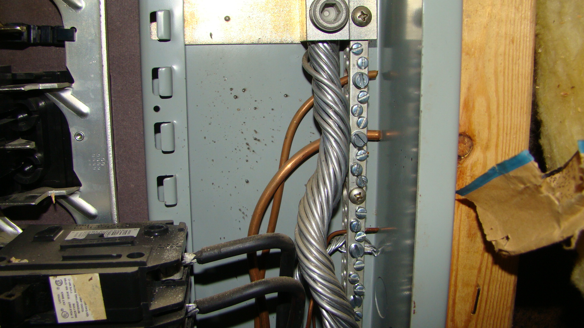

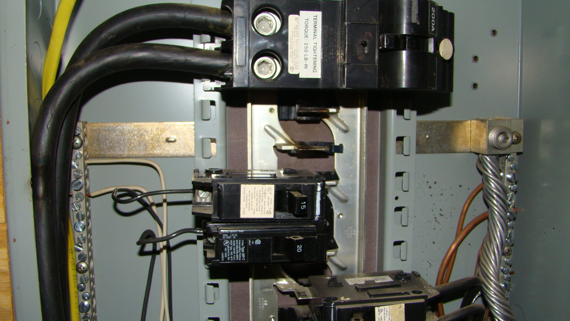

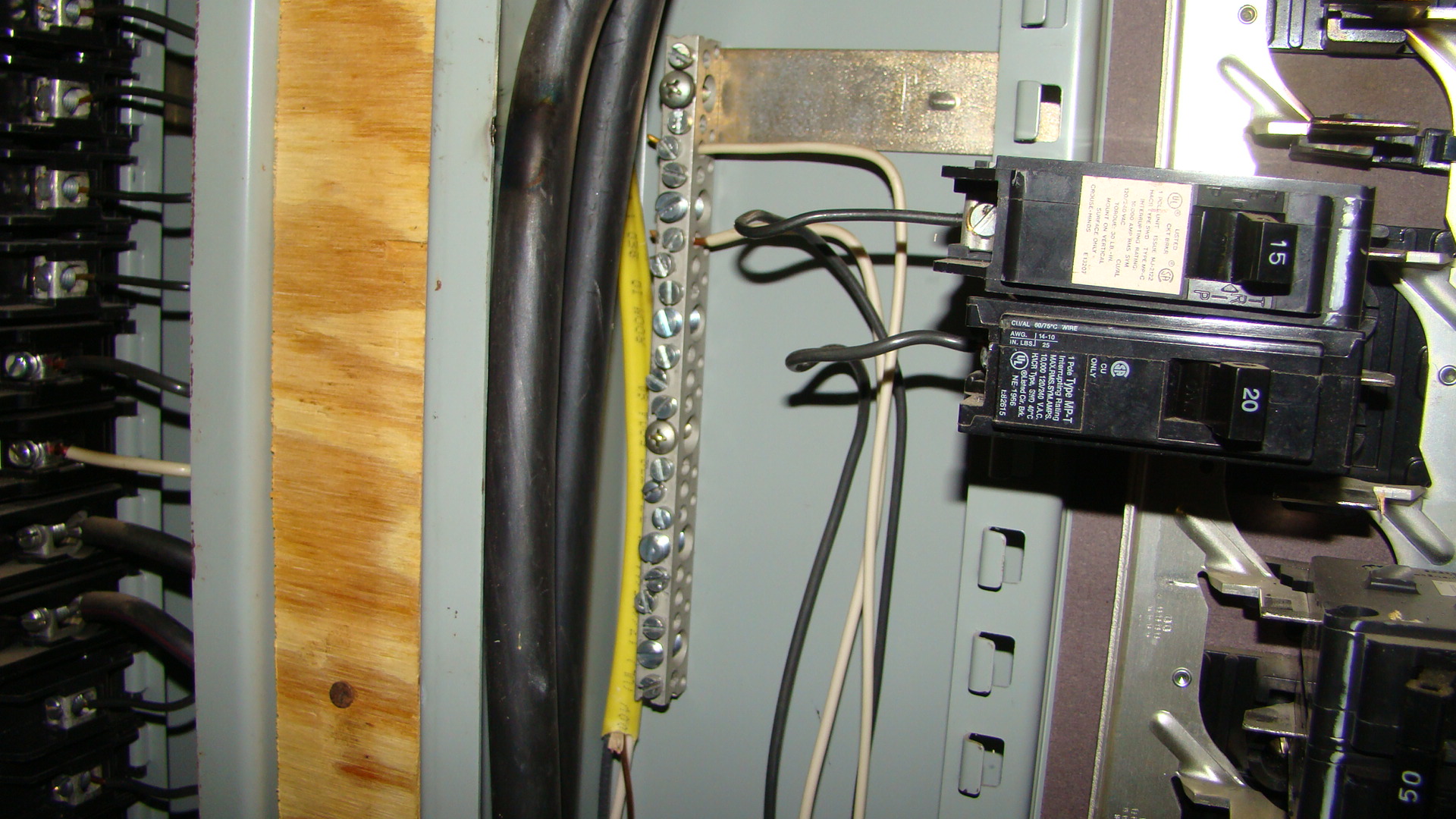

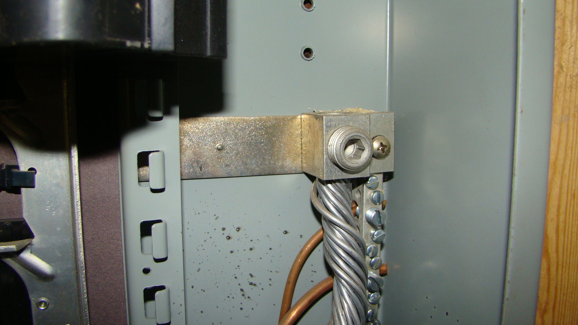

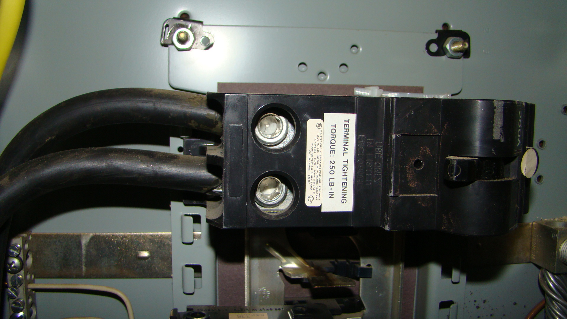

get some pictures of the entire panel.... especially the neutral bars. thanks
Hopefully you can get what you need from these. But I must be missing something, I'm wondering what the neutral bars have to do with the size wires that the main line 1 and 2 are (the two 4/0 wires that will feed the sub panel in the barn.) They have to connect somewhere in the main house panel, right?

   / grsthegreat...get in here! #37
Siemens breakers and siemens neutral lug add on (4/0) WILL work on this panel.
   / grsthegreat...get in here! #38
Sorry "mx" I said I would stay out of this one BUT for some reason I can't.. Sooo here goes,, The tag on the left inside of your panel will tell you that the largest breaker allowed in this panel is 110 amp.. You should not put any larger than that in there,,
Also I see alot of heating on the buss bar just under the main breaker ??? and alot of flash marks inside the panel.. hmmm someone slipped ???
OK I see you have not put your new 4/0 in the panel..good.. Is it still outside the house maybe near where the meter is ??? I might have a idea that will help if it is...
