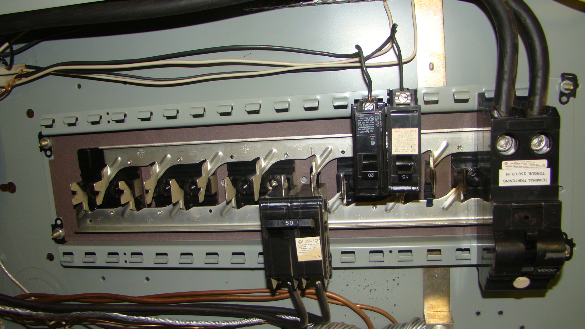

heres a crouse hinds style lug. it simply lugs down into the smaller neutral lugs. there are many different styles available. come have split bases and lug under several smaller existing lugs. get a pic of what you are dealing with. i can copy it and ask my sales rep if the picture is detailed enough

I looked at those and am having sort of a hard time figuring out how they wood work for me. How can I reduce the wire size and still be able to handle 200 Amps? Am I missing something?
I'd really like to see a pic of your panel and the wires.. something just isn't right here,, I'v never seen a 200a panel that couldn't take 4/0 wire,,
As for the Unitaps read this about tap conductors..In your case you can reduce the conductor size by 1/3 rd. and still be able to handle 200a..
Again a pic would make things much easyer..
http://www.electriciantalk.com/f5/tap-conductor-vs-service-conductor-18439/
Somehow we got our wires crossed I think.:confused2: The main breaker has two 4/0 wires that come out of the meter base and hook into the breaker itself.

Are these connectors used to connect between the meter and the main panel disconnect? I would assume that then I would need to stub out from this connector to an additional 200Amp disconnect switch panel next to the panel box then out to the shop????
   / grsthegreat...get in here! #24
OK now you lost me,, First your talking about a panel you were doing some wireing on now your talking about a meter socket,, What exactly are you doing ??
OKay....I have 400 Amp service to my house. I want to split that and use 200 of it down at my barn. I have already pretty much emptied the second panel that will feed the barn now I just need to somehow hook these big azz 4/0 wires into the buss on the empty 200 amp service panel.
   / grsthegreat...get in here! #26
need some pics of the panels. that could save alot of bantering back and forth

OH where was I.......that's right, you wanted a pic of the boxes let me see what I can do.

get some pictures of the entire panel.... especially the neutral bars. thanks
