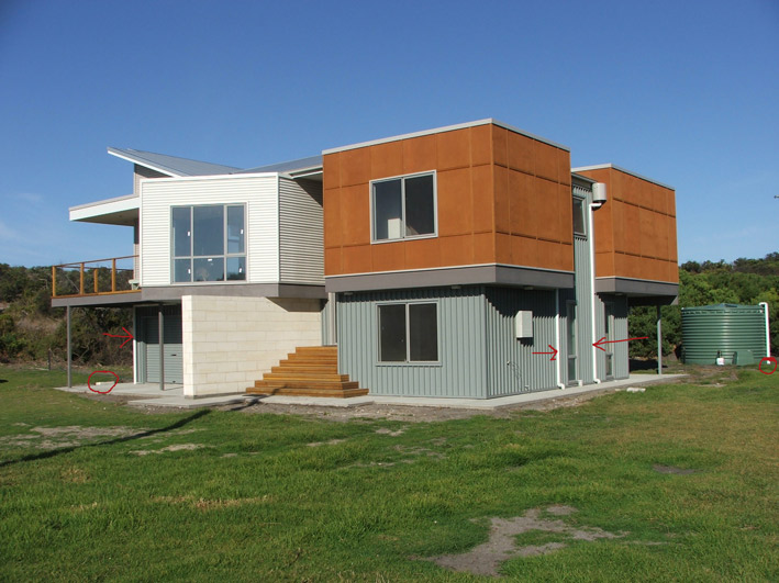

Similar systems are not uncommon here when running a rainwater pipe to a tank thats some distance from the house. (I have 3 such pipes at the beach house because I didnt want ugly overhead pipes running to the tank). As long as the outlet is lower than the inlet then water will flow but you will get water standing in the lowest point. If leaf litter is not a major a problem then you can just put some bird mesh over the top of the downpipes. (Thats what I have done.)
Water standing in the pipe is no big deal if you do NOT intend to drink it, or if freezing is not a problem. However we DO drink it (after it runs through a UV filter) so I dug a couple of pits at the lowest point of the pipes so I can drain the stale water a few times each year. The location of the pits are circled in the pic. (Taken a couple of years ago). I just have a couple of screw caps inserted into the pipes. An alternative to a pit might simply be a 'riser' from the lowest point will give you another outlet in the case of a blockage.
Personally I don't think you'd have too many problems with your idea unless freezing is a problem. But obviously you do have to have a reliable way of keeping leaves, sticks, even dead birds etc, out of the pipes in the first place.
