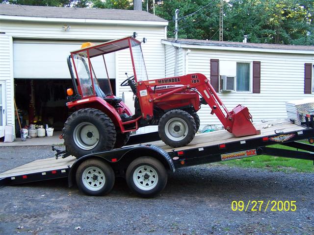

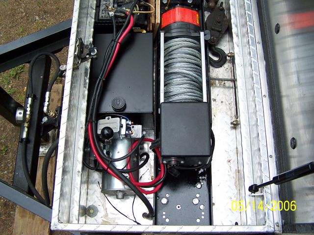

I have an 06 speedloader 8.5x20'. Mine was manually pumped. I converted it to electric / hydraulic. I also welded on my own D-rings where I wanted to put them and added an 8K winch. There are many pics in photos/other/mahindra pgs 6&7. Here's a couple. If you are buying, I'd suggest getting the electric - hydraulic over the manual or convert a manual one like I did. Manual takes way to long to pump up tilt bed (unless you're into body building and need to work your upper arm strength). I don't have the E-track, I'd rather fasten things down to D-rings. Overall I like the trailer, I think its well built. There were no dealers in NY so I drove to PA and picked mine up. I wanted a trailer 82" inches between the fenders and 20' long holds about anything I need to tow. Saved a few bucks paying cash too. Even adding in the cost of fuel and meals down and back it was still less expensive than anything comparable in size I could find locally.

You all are a wealth of information. Thanks much! Question for George2615 and your conversion from manual to electric tilt. What size cylinder did you go with?
/ H & H Trailers #13
I used a 1 1/2" dia cyl. with an 18" stroke. Bought it from Northern Tool.
