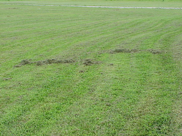

Here are some pictures I took today of the problem I'm having.
This first pictures is looking at me leach bed area.

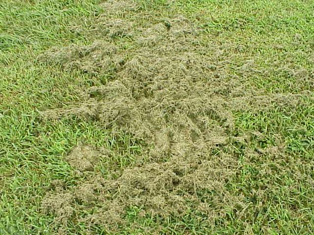

   / Had it 2 months considering trading
Here is a closer shot of my mess.

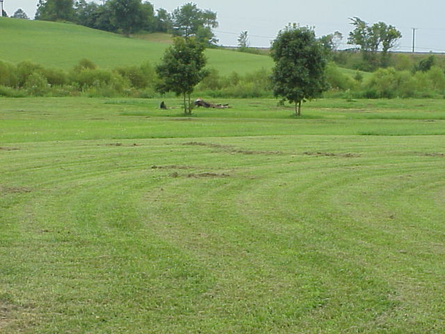

This is right in front of the house looking toward the driveway.

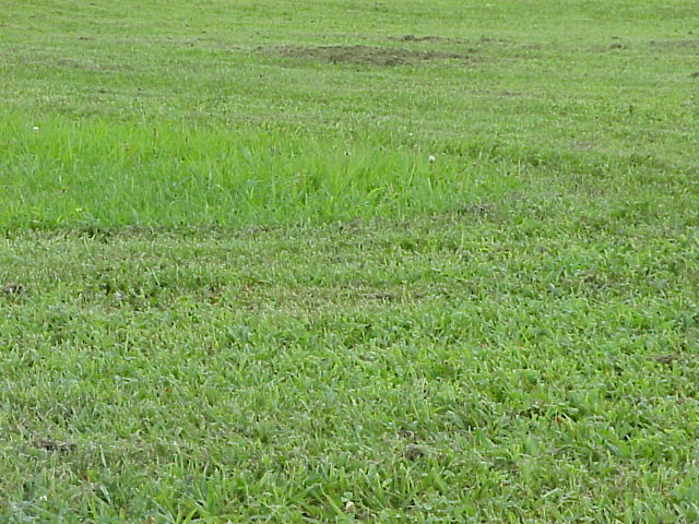

#9
Here is some grass that I hadn't mowed yet (getting dark and ran out of fuel). As you can tell it really wasn't all that high.
Here is a shot looking across the yard to the ditch that runs through our property.
