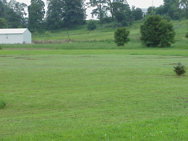

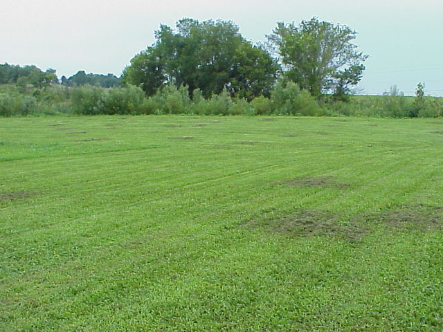

On another note I talked to my salesman not the parts lady and he told me not to buy the Gator Blade as I would not be happy with them. He told me more than likely my deck is not level anymore and is sending his mechanic out to my house this week to take it off and put it back on. I guess after a year that's pretty good service. So I won't be buying the Gator or the Hi-lift blade at this time.
Richard, I have checked the blades for being on backwards and even purchased new blades. They are not on backwards. My mower does actually cut fine it is just behind the front wheels where the wheels knock down the grass and the mower does not lift it back up to cut.

I've tried a couple of different things. First I was I lowered the wheels 1/2" in the front and an inch in the rear. Was cutting uneven. So then raised the back wheels 1/2" to put the deck back level. Was still bogging and blowing a mess (had been 8 days since I've mowed and with the rain it was getting out of hand again). Then what I was doing was only cutting w/ about 80 - 85% of the deck. Left a little more overlap than normal and things were going pretty well and I was even able to pretty much mow full speed in low range. I was able to mow until about 9 last night (had to go get the pizza for dinner) but by that time the dew was pretty heavy and I was still cutting. Where the grass wasn't as tall that I had recut on Wednesday I was still using the full deck width. That is probably the approach I'll take until I can get the grass truly under control again which may be hard w/ starting the pole barn. Just hate not being able to use the whole deck.
