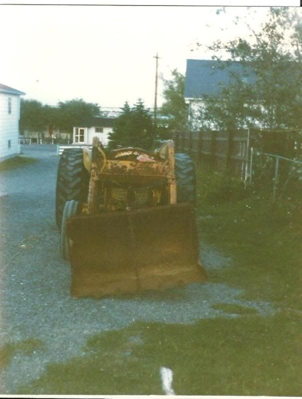

Great post and one I'm sure your dad would be very proud to read. Obviously a very bright man when he was on this earth and could find he way to repairing anything. Although I know nothing about farming I work occasionally on farm equipment. As in the photos above when I arrived at the farm and the guys showed me the damage my first question was "What is it". That's how much I know lol.
I'm not a welder, have never taken a welding course in my life yet I kind of had to learn it on my own to be able to archive other goals in life I set out to go after. As time went on locals got to know me not only as an auto tech which is my actual trade along being a heavy equipment operator but a guy to go see if there's something weird that needs to be done including welding.
Here's a few photos of a tractor I did up for myself many years ago (30) I rebuilt that old Massy with nothing more than an old buss box and vice grips. Your story on your dad really brought back memories. Lost my dad when I was 22 and my mom when I was 13.

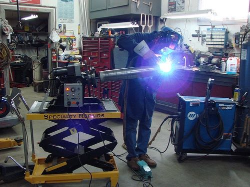

I like your toys (oops, I meant tools :=) and anyone who's seen any of your work has no doubts as to your innovations, craftsmanship, etc, including me - so I'd rather ask a question regarding welder settings for the bushings -
I like your rotary positioner/articulated gun support/hydraulic table setup, may borrow parts of it -
Am I correct in thinking those incredibly smooth welds are the result of spray transfer, or did you use some of the more exotic modes that 350P is capable of?
I recently acquired a nearly new 252 with double running gear and 30A spool gun, and sold my smaller 211 so now I at least (with the right gas) have the option of getting into spray transfer, and I'm wondering if it'd be worth it to add a 90-10 bottle for heavier MIG work.
Right now I just have a C25 bottle and straight Argon, so it'd not be a "free lunch", hence the question - thanks... Steve
Thanks Steve. I never consider my tools toys. I never get caught up in them the way some guys do. For me they are just a means for me to scratch a living for my family. The Milermatic 252 is a great machine. I have one as well. I also use to have the 251 which I thought was a little better because of the smoothness of the setting knobs.
I like the simplicity of the 252 yet like the results of the 350P for the heavier jobs I take on. The 252 I refer to as my daily driver where as the 350P is used for those special application jobs. I have the 30 amp spool gun on the 350P that I use as well. I've never tried spray transfer with the 252. I'm using it as straight mig only plus spool gun with .035 wire.
The positioner is one I bought a few years ago. I mounted it on a hydraulic table and made a few custom arm supports for it as well. I like the table very much because it allows me to do height adjustments for welding pipe in the horizontal position ( the pipe not me) :laughing: I'm happy with its performance.
The welds you see in the first photos are pulse spray transfer. 90-10 mix for gas. To obtain that weld one has to have everything set up to perfection. Tip angle, rotation speed and welder set up and having a very steady had helps greatly.
I do a lot of welding for the offshore, big freezer trawlers and other machine shops and I always consider it the ultimate compliment when they ask me to do it. As anyone who welds will tell you. The more time you spend at anything, the better you get.
Here's a few more photos of the set up I use. Thanks for your kind words on my work. Happy to hear you like it.
