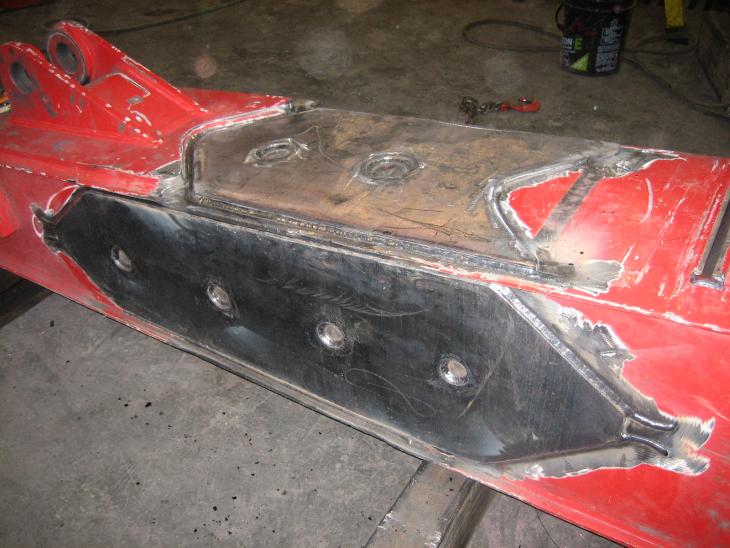

Well I completed the repair today and the customer is Happy, happy, happy and so am I :thumbsup:
Sorry but they are iPhone pics :(

VERY NICE SHOP 4shorts. Thanks for the pics of that and everything else. Have a question though on patch you did on boom of Cat excavator. Around 30 years ago I was doing a lot of fab work in my shop for one of Maine's largest construction contractors and one afternoon I got a call where they needed me to go out that night and put a patch over a crack on the stick of a Cat excavator a little bigger than one in your pic. I'd never done that before and the man who ran their fab and repair shop told me NOT to weld the ends of the patch. Just run the longitudinal sides.
He was real master at this stuff and had been doing it for a long time, so that's what I did. But, I see you welded patch all the way around and now I'm wondering - was he right or just something he'd learned from a long time ago and no longer applied?
PS. The stick is the arm between the boom and the bucket.
Nick I've seen it done both ways and I've seen it done where guys would actually punch holes in the plate before welding it. I personally don't know if it right or wrong but you'll get as many opinions as you want with the right guys around. That being said I've never had a fracture after a repair so Ill keep on doing it until one fails.

I've seen it done both ways as well. Only thing engineer types will spec is to never use 90-degree corners! Ovals, diamonds, radius corners are all acceptable to prevent stress risers. Most will spec the fish plate not be any thicker than the material being beefed up, reason being. To have some flex to the fish plate. When using diamond shape fish plates a good idea is to tail out the welds on the ends.
