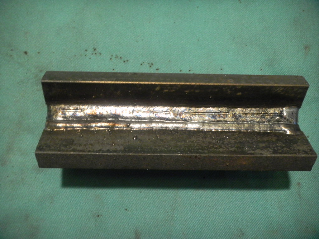

If you buy a roll of dual shield, keep it in the house when not using it! Dual shield does not like any moisture. If the roll picks up any moisture you'll have to bake it in an oven. One sign of moisture is worm tracks, but too much voltage can do the same thing also.

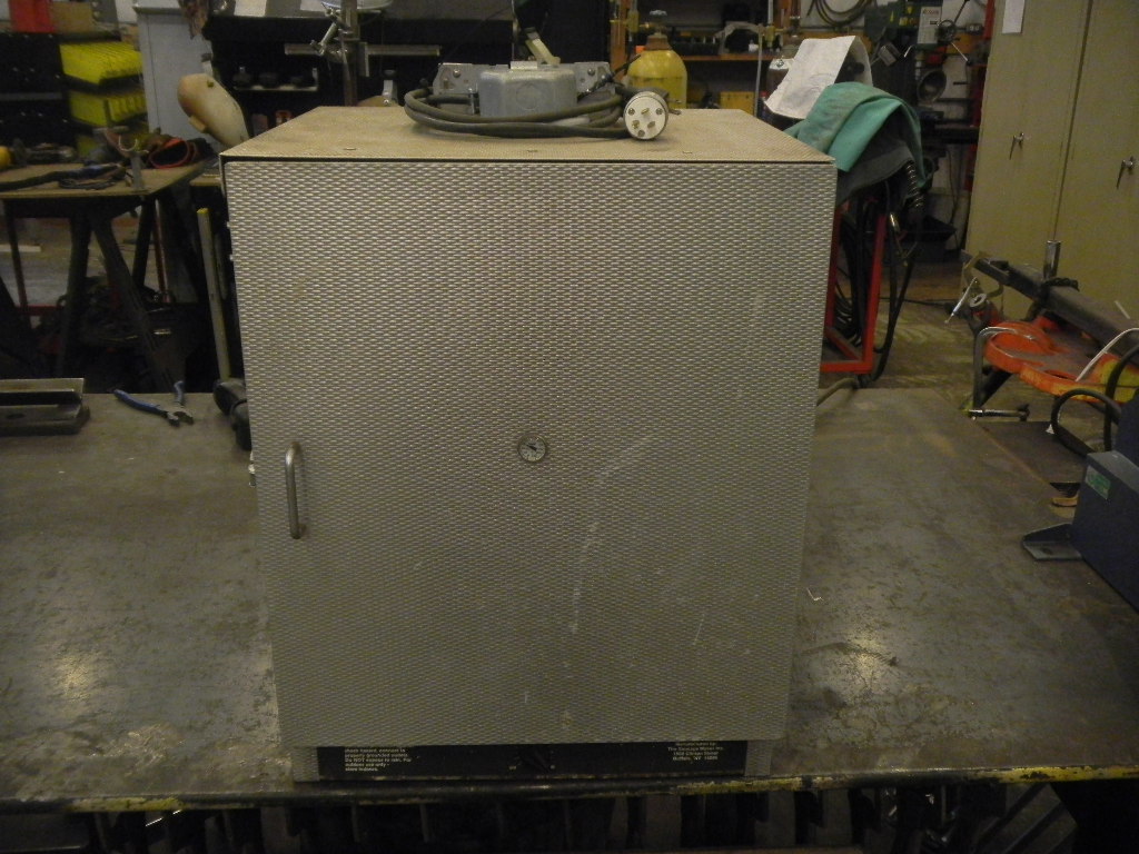

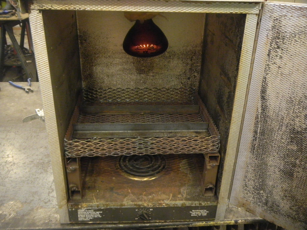

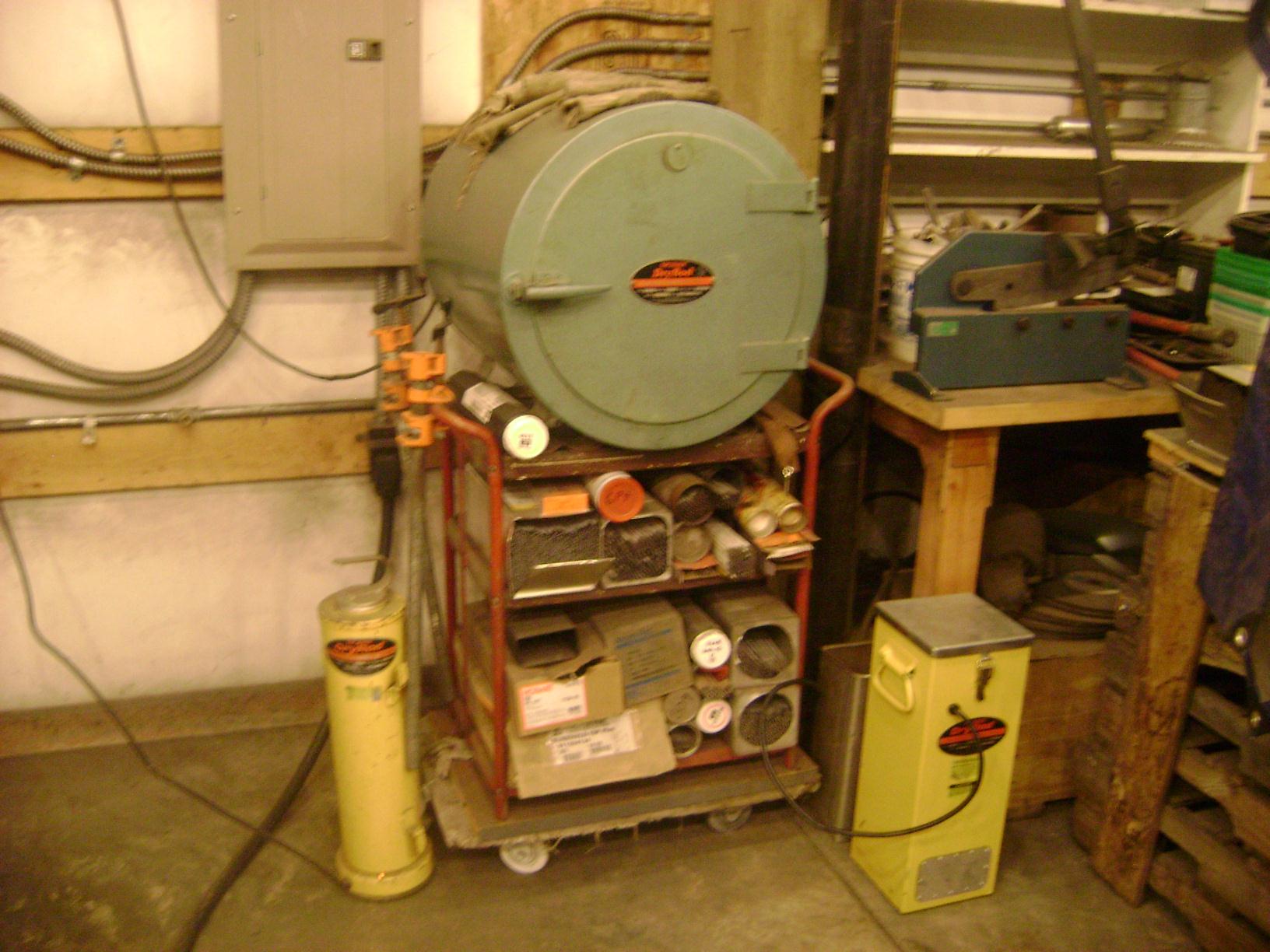

Sometimes you can get good deals on Craigs list. I paid $140.00 for this 300-pound oven, $25.00 for the 50-pound, forget what I paid for the 10-pound oven:confused3:. I used an old smoker with heat lamp for years.
