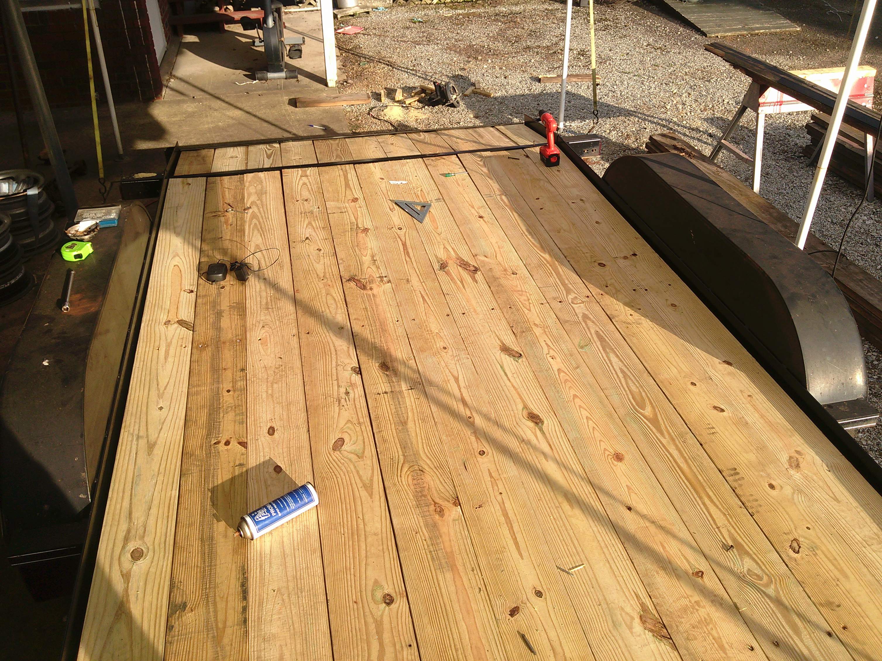

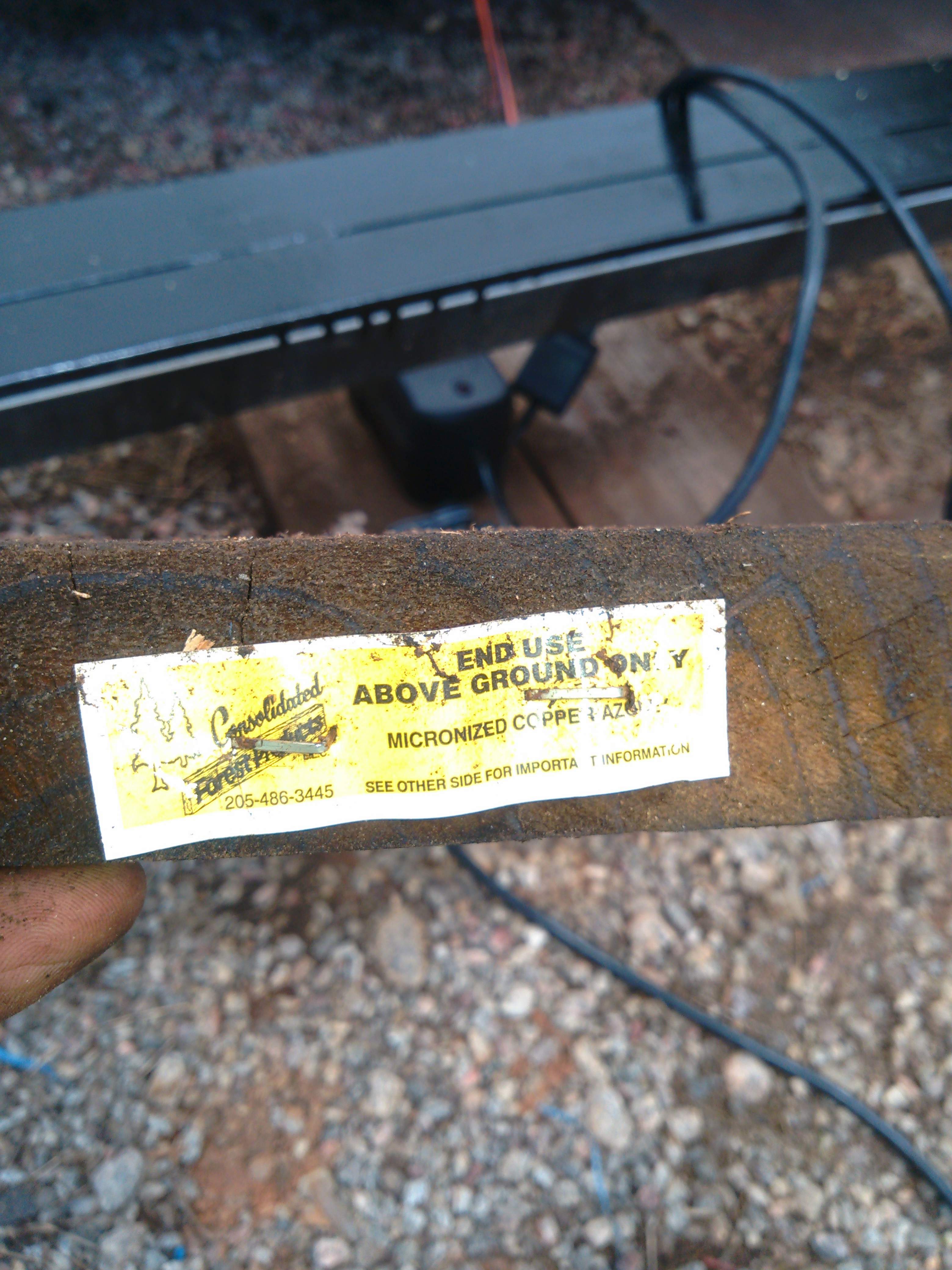

Here is a picture of the painted supports and then the treatment label. And then a picture of the alomost finished thing. Since i know we all like pictures.
I know this wood is treated as well since i bought it (from Lowes) and saw the tag on the end of each boards. THere PT 2x8x16 that i cut to fit. They said number 2 but some of the boards were stamped #1 on the board but the treatemet tag said treated prime #2 and thats what the lowes spot called them so some #1 must of got mixed in at the mill or thrown in?
I need to post the pic where i showed the old cracked boards end grain and the new replacement. the old one has about 7 growth rings and the new one has about 15 in the same size board.

I see that the lumber on the trailer was treated with CA. Not much experience with that, could b the issue. If it was just non treated lumber I doubt it would last more than 2 years. All I see around here is ACQ, so it must be better?
