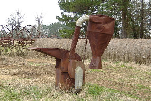

I have a hammermill in my barn that was used to crack corn for the hogs. It is like a wood chipper. There is a shaft that spins with hammers that sling around and smash anything in the hopper and has a screen that has openings that regulate how large the finished product is. The one in my barn is floor mounted and driven by a flat belt from a tractor. I have seen them run off of a pto shaft instead of belt. I have seen them on a trailer but not on the three point. I think that you would need to have a large tractor to run one as the unit is pretty heavy. Mine has several of the plates (screens) with different size holes in them. Hope this helps some. big dan
/ Hammermill #6
This is picture of a hammer mill use on farms.
/ Hammermill #7
maybe this time
