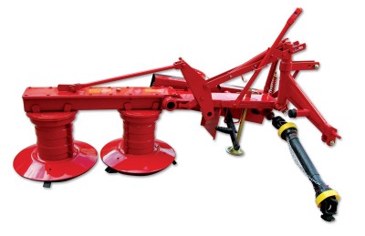

There are boom type sickles, but, won't work well in wet grass. To cut the wet grass, either the knife/blade must be very sharp or the blade speed must be high. For the wet grass, the best mower is old classical drum mowers which has a speed of about 2000 rpm. See attached small, 4 ft, drum mower. Requires less than 20 hp.
By the way, contrary to the belief, mowing the wet grass is better than let it grow for the health of grass from biological point of view. But, I don't understand much about biology and this claim is not my claim, just a copy & paste of their thoughts of some biology experts.

Need a mower I can mow out over wet areas with that does not ride on or run on the ground.
Anybody got any ideas,seen any such thing or built something?

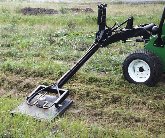

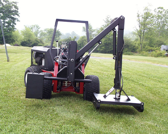

How about these boom mowers from Power-Trac.
