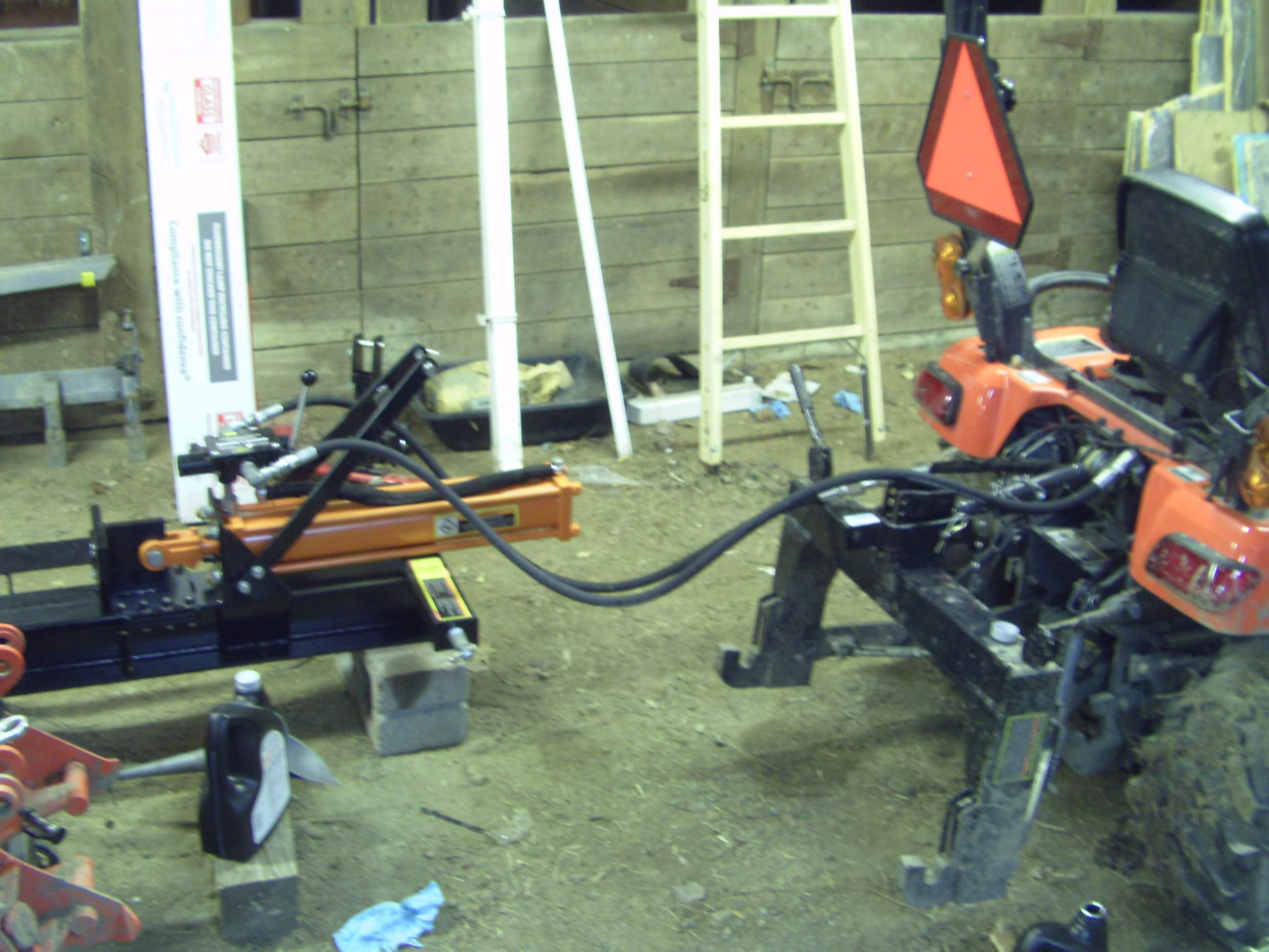

It's ALIVE! :D
The splitter is working just fine with a few items to share.

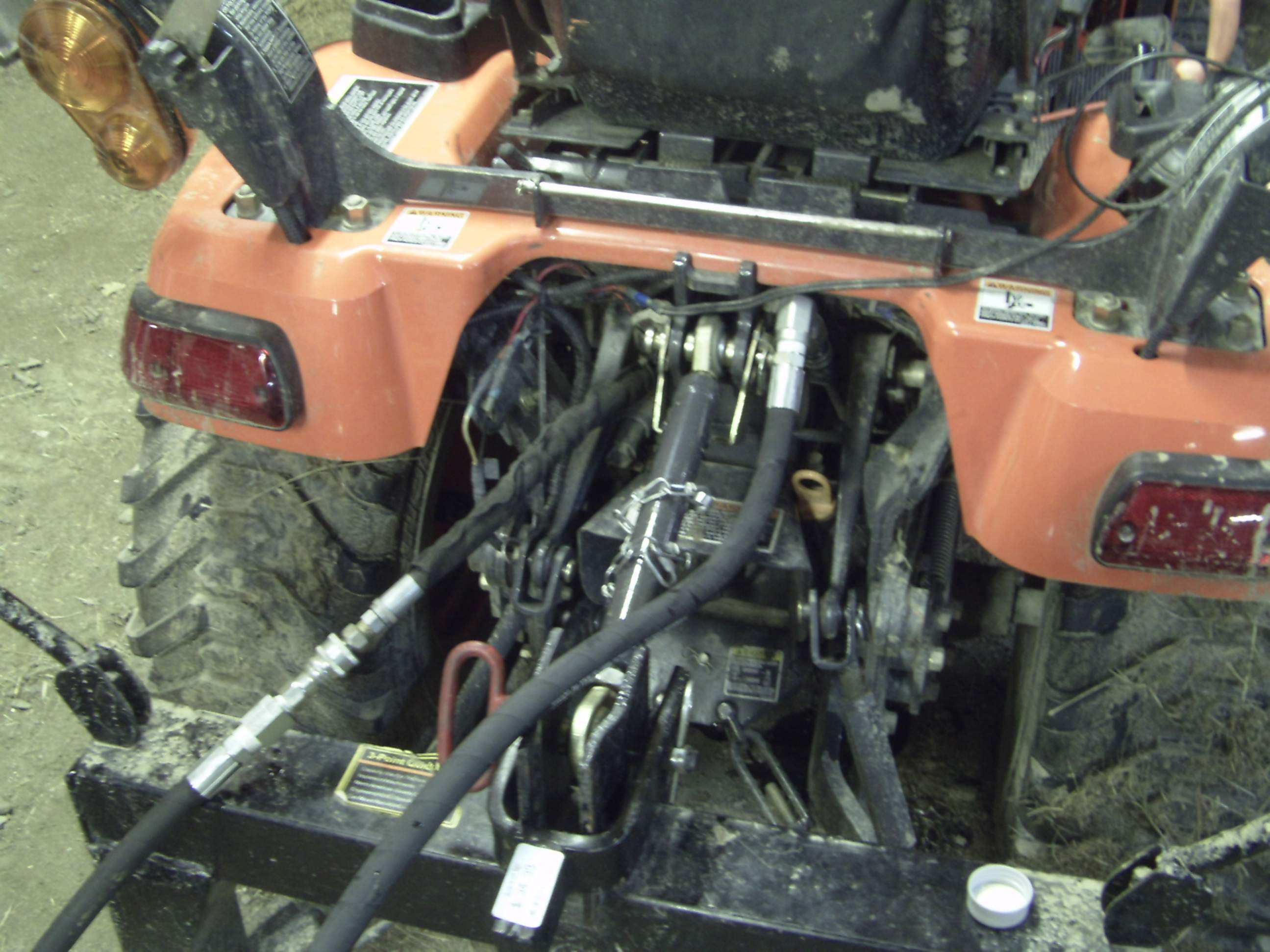

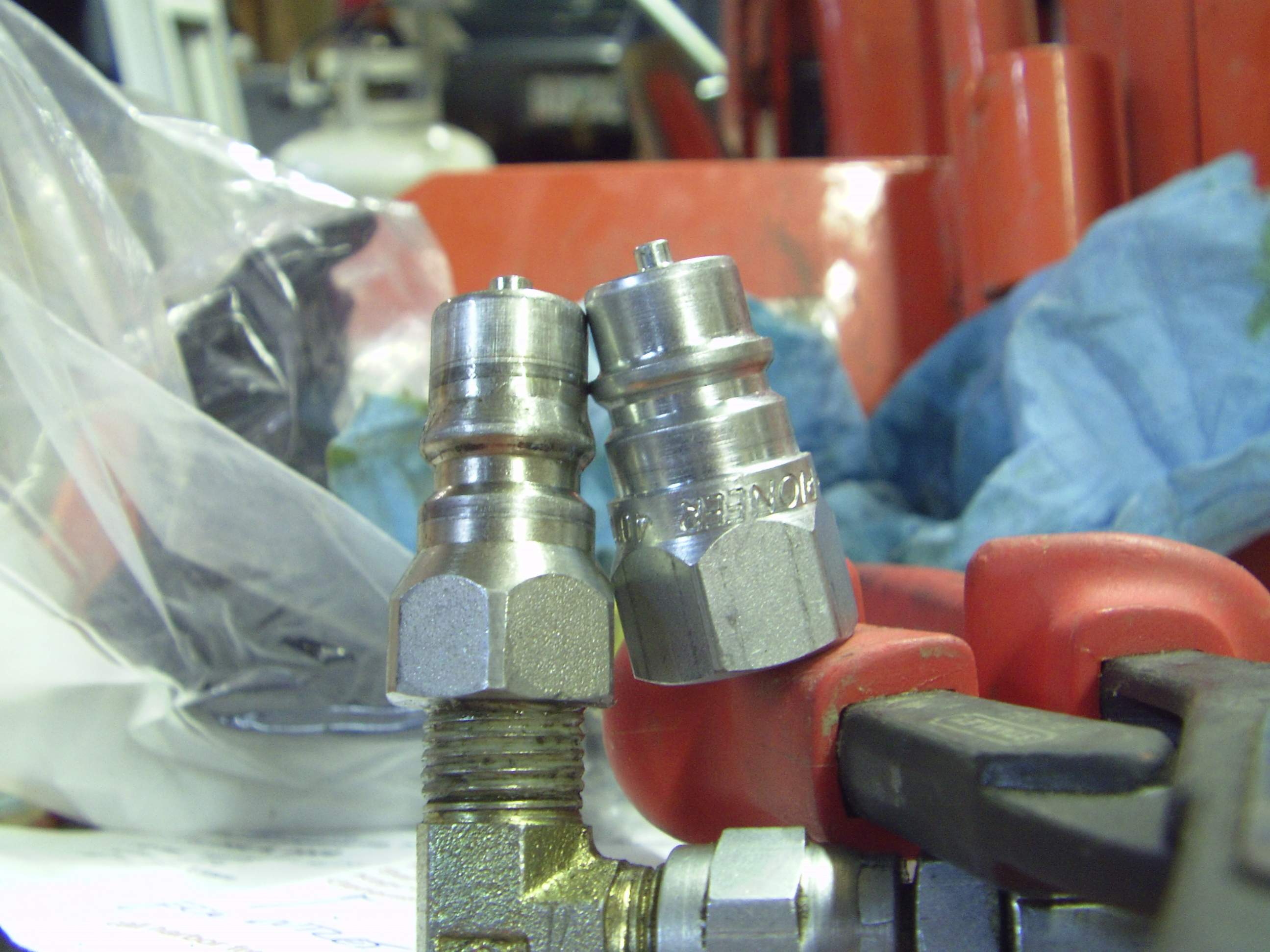

1. The 1/4" disconnects that I got from TSC are not the same that Kubota uses. Go figure. You can see from the close shot that their geometry is different. Kubota disconnects cost me about $34 and a trip to the dealer. BTW, Mike at the parts counter at Southern Tier Trailer is great! He knows his parts and has been great helping me finish this project.
2. I made sure that the hoses were long enough to reach even if I didn't want to mount the splitter to the 3-point. I used a 5' hose for the feed line, and a 6' hose for the return. The makes them pretty even since the feed hose on the tractor is about a foot long. You can see the details in the attached photos.

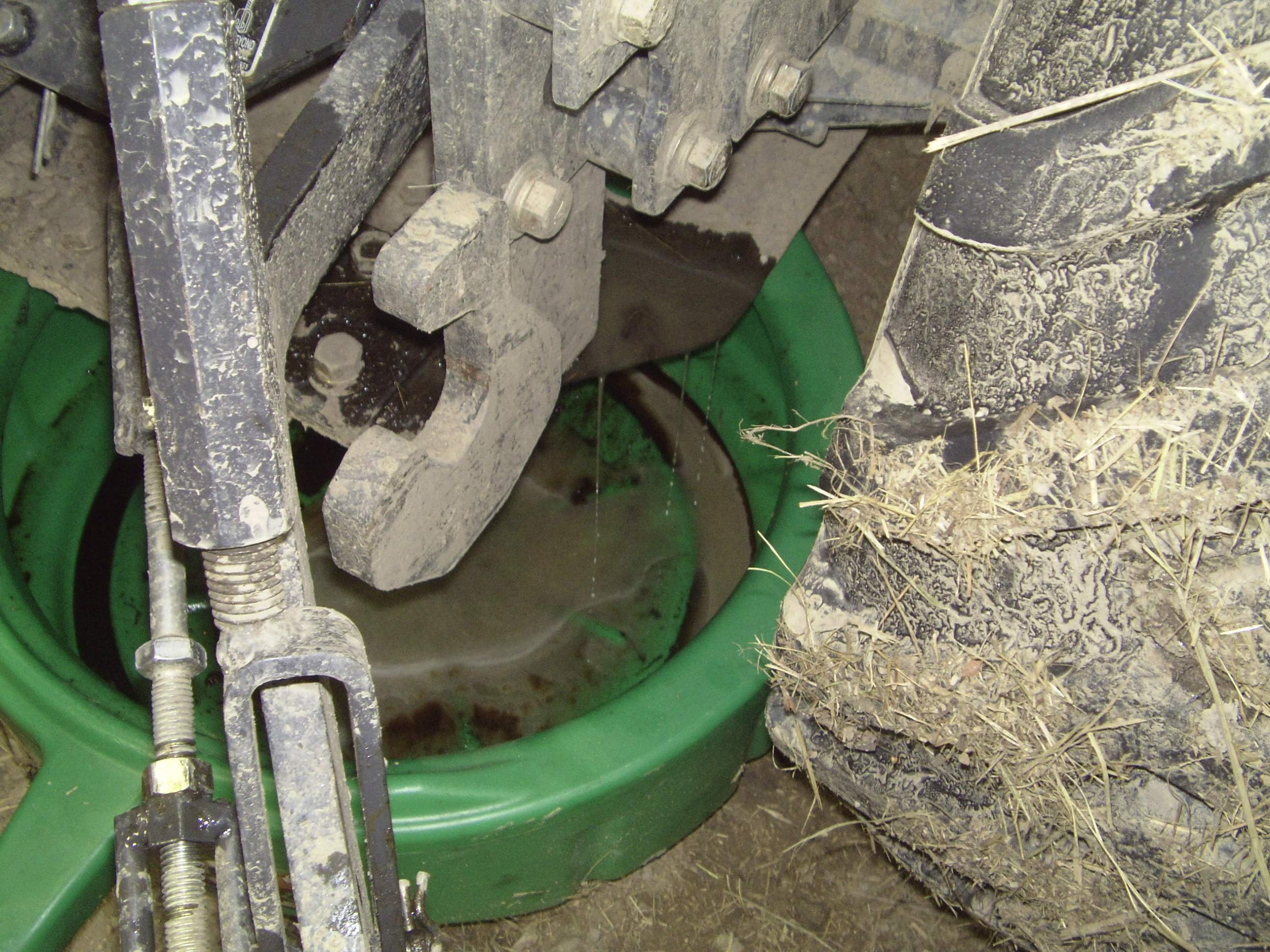

3. Add make-up UDT to the hydraulic system is a pain. I moved the splitter cylinder 4" at a time and topped off the tank. Strange things have happened, but all the hydraulics are working fine. Strange includes an apparent over-fill of the system that I let bleed out the fill hole, and a foamy nature to the UDT that dissipated after the engine had been shut down for a while. You can see the milky look of the fluid in the drain pan...
It was about 20F in the barn while I was doing this. The engine was warmed to full operating temp (with help from a block heater), and I cycled the splitter several times (with wood to chew on). I'll go out again tomorrow and see what's happening with the foam and fluid level.
Any pointers on how to check for and remove air from the system would be appreciate. I'll also be posting video on YouTube that I'll provide a link to later.

I did the same thing with the hydo fluid when I first installed my 3 point splitter. After I thought about it I figured out what I had done:
On the extend side of the cylinder lets say it holds 1 gallon of fluid.
On the retract side of the cylinder it holds about 1/3 less because of the piston rod taking up volume.
The foaming will leave once all the air is worked out. Just use the splitter for 20 minutes and let the fluid get good and warm. Then retract the ram all the way on the splitter and place your 3 point full down along with the FEL if attached, shut the tractor down and check the level. I would do this every 20 minutes for the first hour of use then by that time it should settle down and hold steady.

ON the Quick Connects, Kubota uses the ISO-7241-1b version for the BX series - found that out when I added my 3PH log splitter. I think they use more standard versions in the larger machines.
For future reference, you can order them here for a reasonable price. My original QCs are made by Snap Tite.
ISO 7241-1B Hydraulic Quick Disconnects
